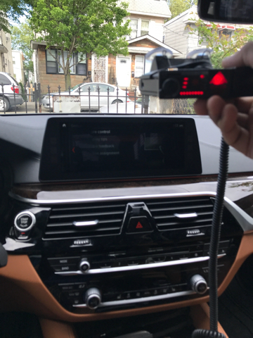

Valentine one radar detector going crazy
So my brother picked up a 540xi. He doesn't have any of the blind stuff warning systems. We installed the V1 and the laser detection is going off like crazy. I even tried with my own V1 and it does the same. We prefer not to turn off the laser detector option on the V1. For now he can simply press the button and mute the sound.
Anyone have a similar issue? If so what did you do excluding turning off the laser detection system.

Here's the response from V1.
"Did he get the gesture control feature option? If so, the V1 will report rearward laser alerts since the gesture sensor is located in the overhead console. The only solution is to block the V1's rear laser sensor with black (non-transparent) tape. The rear laser sensor is the red circle between the bogey count and the band ID lights."
I think this is a little ridiculous, hopefully I can download the V1 app from the app store and hack into the radar.

      05-06-2017, 09:00 AM   #12
hatepotholez
299
1,031
Drives: M3
Join Date: Mar 2011
Location: NYC, NY
I turned off the gesture control and it still went off.
      05-06-2017, 09:02 AM   #13
hatepotholez
299
1,031
Drives: M3
Join Date: Mar 2011
Location: NYC, NY
Better photo
      05-06-2017, 09:04 PM   #14
lemetier
Plenipotentiary
lemetier's Avatar
2594
3,044
Drives: Yes
Join Date: Jul 2010
Location: Location
Originally Posted by hatepotholez View Post
Better photo
There are 3 additional LIDAR arrays (with extremely short range for touch screen proximity sensing).They normally wouldn't be an issue but you're holding it right in front of them.
Place the unit on the dash against the windshield instead. If it still goes off, cover the sensor with black tape and try again.

Even on the windshield it goes off, oh well I guess it's tape time.

we covered the gesture control, seems good now.

we used one of those cloth/velcro to cover the sensors on top. when we want to use the hand gesture we just take off the cloth part of the velcro set.
