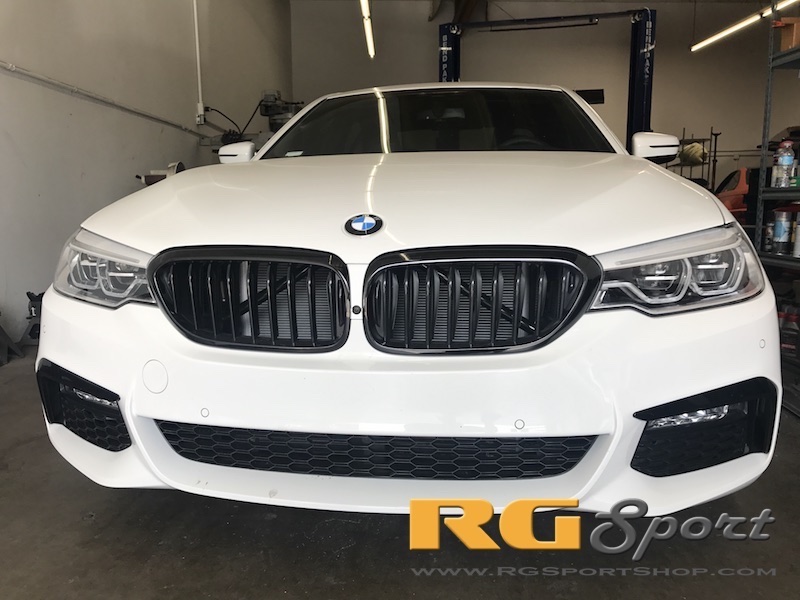

Before and after picture.

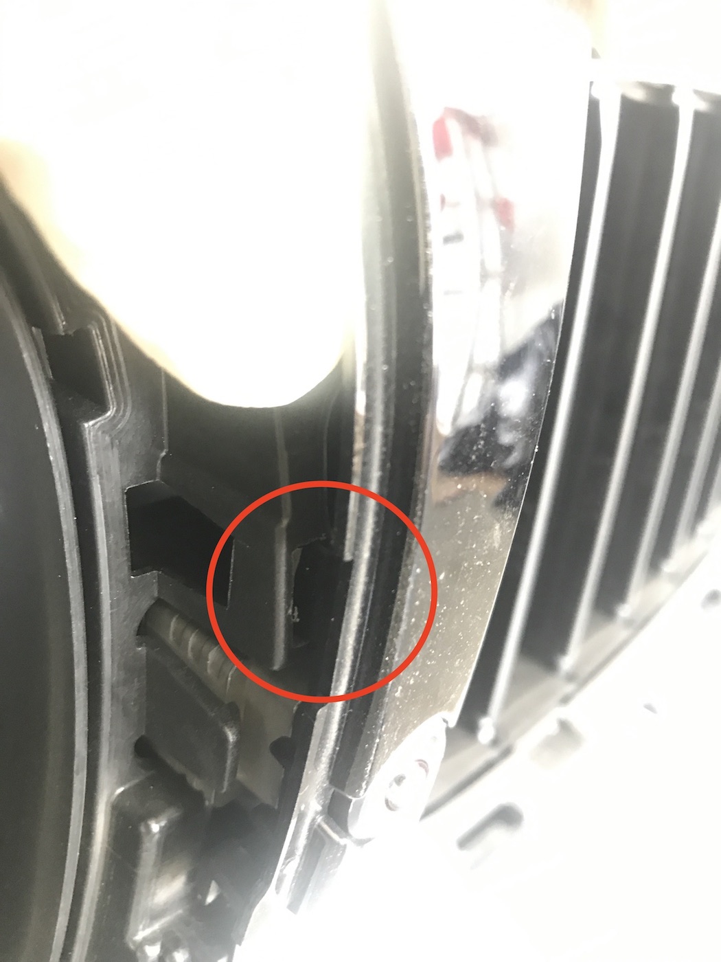

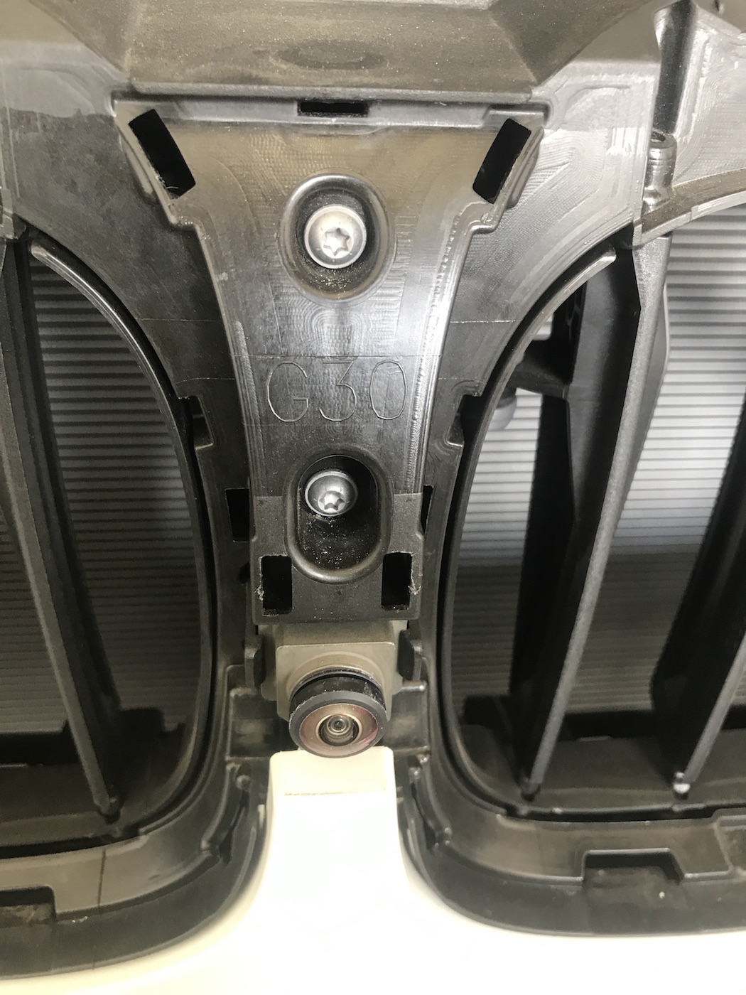

- Use the flat screwdriver or pick (in my case, screwdriver works much better) to unclip the top part from each corner.
- Pull gently using your hand to undo the middle clips. One on each side.

- Once you have all of the top and middle clips undone, use your hand to pull forward the tip of the bumper that is holding the bottom of the cover in place. You may use a little force to clear the camera lens and the tip of the bumper.
