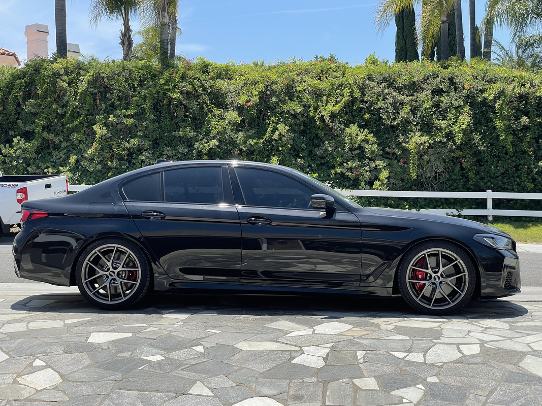

my 2021 540, lowered on bbs cir wheels.
Heres a pic of my car i just got. lowered on h&r springs and 20" bbs ci-r. shout out to ben @ rgsport for getting my car dialed in and looking right.

nice what's the specs on them?

wheels? 20x9 et25 and 20x10 et45, front offset is perfect, rears needed to add 15mm spacers.

Looks great!
I have the same wheels! I think they suit the G30 alot

How is the ride quality on the H&R and the MSS springs?

Looks great. Do they come in black?

Yes they do. Tire Rack definitely has the black and bronze ones.

hey, love the bbs wheel set up.how much is your car lowered in pictures below and what offset have on those bbs wheels ?

What size tires are you running? Also you mentioned needing 15MM spacers in the rear. Could the +25 20x10 fit? BBS has that size but it doesn't fall under recommended size for the G30

Yeah OP, that setup looks great! What size are your tires? Any longer term thoughts?

Wheels look fantastic. Are these forged?

Looks awesome hey what size wheels and tires are you runing? Any spacers or did is it flush without it? Cheers!

Thank you!
Running OEM tyre sizes 245/35/20 and 275/30/20
10mm spacer front and 15mm spacer rear

Did you intentionally try to run the OEM tire? The reason I am asking is that there is an option to run front 20x9 +25mm 255/35ZR20 and rear 20x10.5 +35mm 295/30ZR20 with no spacers and it looks super flush.
Curious to hear your take on it.

Yes, I wanted to run OEM size wheels and tyres to minimise any issues especially when the car is lowered. I've seen people put the F90 wheels on their cars (which are wider) and there is a mixed feedback on if they work without issues. I think they swap out the 295 for a 285 to combat the rubbing issues - and most seem to be okay with cars on stock ride height.
With me being lowered I didn't want to have issues so just went with the oem size setup. The space and fitment is already quite tight on the front so I don't think a 255 would of worked for me (I could be wrong) but I didn't want to chance it after spending all that money.
I think the fitment works well with how I have it... If I wanted to be really picky about it then the rear would need to come out 2mm and 1mm on the front - but I can live with that

Glad I asked! Would honestly also rather keep it safe and run an OEM size. How much did you lower your MSS springs with the 20s?

30mm front and 25mm rear

Sorry and what’s the J and offset? For front and back .

8J ET26, but with a 10mm spacer it makes it ET16
9J ET38, but with a 15mm spacer it makes it ET23
