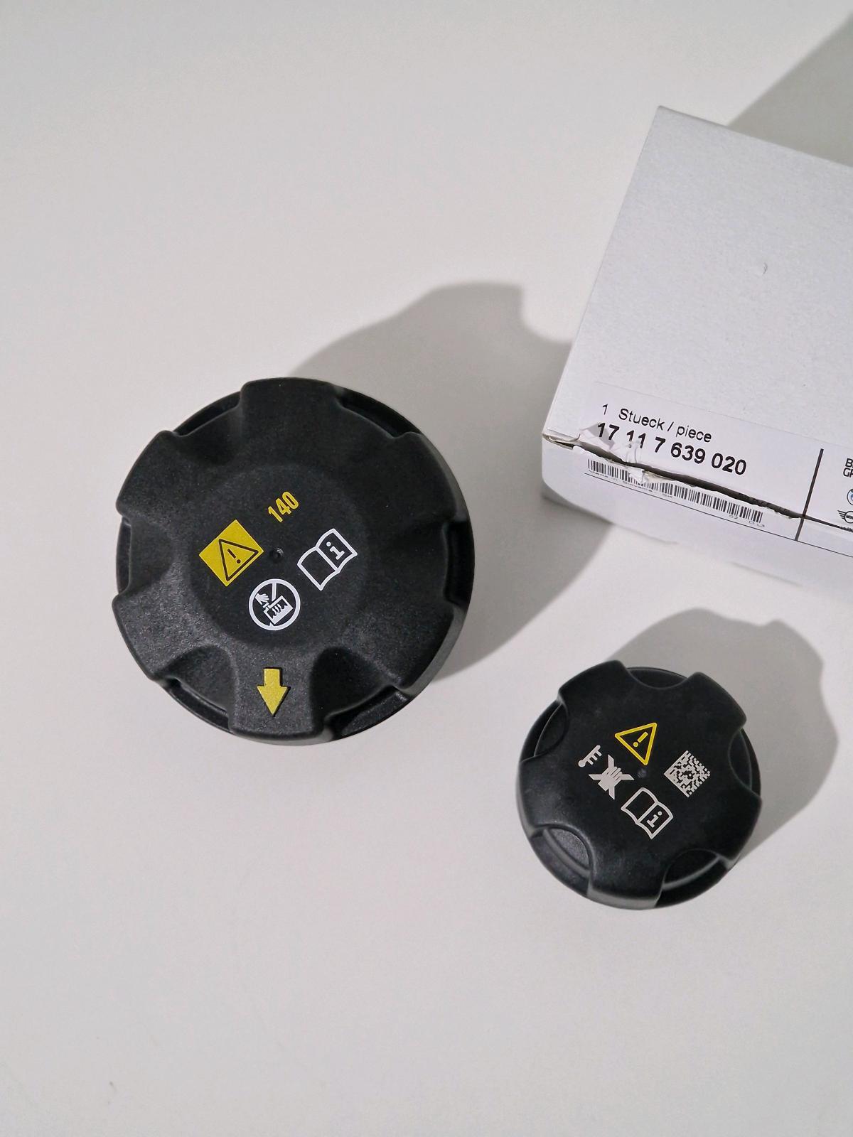

Few more parts have arrived that will be going on same time as the turbo install.
Parts to be Installed:
  • Pure Turbos Pure800 Cast Turbo
  • Pure Turbos Silicone Turbo Elbow
  • Osprey 5" Catted Downpipe
  • NGK 94201 Spark Plugs
  • BMW Turbo Gasket
  • BMW Downpipe Gasket
  • BMW Oil & Coolant O-rings
  • BMW Turbo Bolts
  • BMW V2 Coolant Tank
  • BMW V2 Charge Cooler Tank
  • BMW Coolant and Charger Cooler Tank Caps
  • BMW Coolant Tank to Radiator Pipe
  • BMW Intake Manifold to Charge Cooler Tank Pipe
  • (Oil Service to be done and Coolant to be changed out too)
Decided to swap the coolant tanks and pipes for the newer versions to try and combat one of the G30's common issues.
IG: project540ix

Do you have any signs of leaking or any issues? I didn't have any leaks from the tanks but I could see the seam was starting to show signs. The car is currently in the shop having work done, when they removed the coolant pipe it cracked and broke in 2 - so I'm glad I had a new one to go on. I say for piece of mind, get them changed out while you're having the other work done as they will need to drain the coolant anyway.
Some nice upgrade for your car there! I've heard of IPOS - they have some decent stuff on their website.
Part numbers below for all the coolant bits:
17125A02485 - Pipe, Expansion Tank-Radiator
17117639020 - Coolant Expansion Tank Cap
17139846642 - Coolant Expansion Tank
17135A1BD89 - Charge Cooler Tank Cap
17139485733 - Charge Cooler Tank
17128602646 - Pipe, Intake-Charge Cooler Tank
[/B]
I'm keen to do this update as well on the cooling side to prevent what sounds like a weak point in the older tanks. Odd thing I noticed with the Expansion tank is that RealOEM seems to list item 17139884859 as the current version. They state it Supersedes:
17139487210(02/01/2018 — 05/29/2019),
17138742975(07/24/2017 — 03/08/2018),
17138610656(07/01/2015 — 01/18/2018)
The part 17139846642 you used wasn't even listed on there. <confused>
G30 540i M Sport | MPPSK | VSRF Catted d/p | Burger Intake | BM3 Stage 2 | XHP Stage 3 | FTP G-58 / G3X
      04-01-2024, 05:30 PM   #13
Junebug85
Junebug85's Avatar
1851
2,379
Join Date: Nov 2013
When I checked one of the places where I buy my parts, they have it listed - 17139846642 superseeds 17139884859, as well as the other part numbers you listed.
17139884859 shows an 'up to' date of 08/2020
I don't think 17139846642 is on RealOEM as it's a part that comes on the LCI cars (which are not on RealOEM as you know) but the part is still backward compatible with pre-LCI cars.

Stage 3 ✅️... after posting and talking about it for a while 😄 the car is now stage 3.
New parts installed:
Pure 800 Cast Hybrid Turbo
Pure Turbos Silicone Turbo Inlet Elbow
Other parts/work carried out:
BMW v2 Coolant Tank
BMW v2 Charge Cooler Tank
BMW Coolant Pipes
BMW Turbo fitting kit (gaskets and bolts)
Oil Change
Coolant Refresh (with system bleed on both circuits)
The work was carried out by my friend who is a BMW Specialist (RS Automotive). He previously did the stage 2+ setup on my car and has continued to maintain the car too, when it comes to any servicing work.
While I was having the 'Turbo' work done, I saw it as a good opportunity to have the coolant tanks and pipes changed out. Glad I did - as soon as the pipe from radiator to the coolant tank was removed, it broke in 2. You can tell the difeerence between the newer tanks from the older ones as the newer ones don't have the bleed screw/valve on the top near the cap.
The car is now running a custom tune on pump fuel (99Ron) from Velocity Tuning via Bootmod3. I opted to have the car road tuned rather than dyno tuned which did take a little longer (mostly due to the lovely weather we recently had in the UK 🌧🌧&#127783
There is headroom for more so will look at additional fuelling options in the future... as well as a new brake setup as I'm sure that will need doing!
My 540ix has been transformed from great car to an even better one. Power delivery is very smooth and the car just wants to keep pulling more and more. Stage 2+ wasn't slow by any means but it is now a whole lot faster and you can feel it for sure. Even when pushing on you can feel how much better the car is in terms of handling - that's down to the F90 M5 Sway bars and front and rear reinforcements. Very enjoyable to drive, more so than before.
I've not done any accounting numbers yet 😆... (Dyno or Dragy Times) but will do, hopefully at some point
So as it stands, the current engine build is:
BM3 Custom Tune from Velocity Tuning
XHP Stage 3 TCU Tune
Osprey V2 Heat Shield
B58TU HPFP
MST Intake Induction Kit
Masata Charge Pipe
Remus Catback Exhaust System
