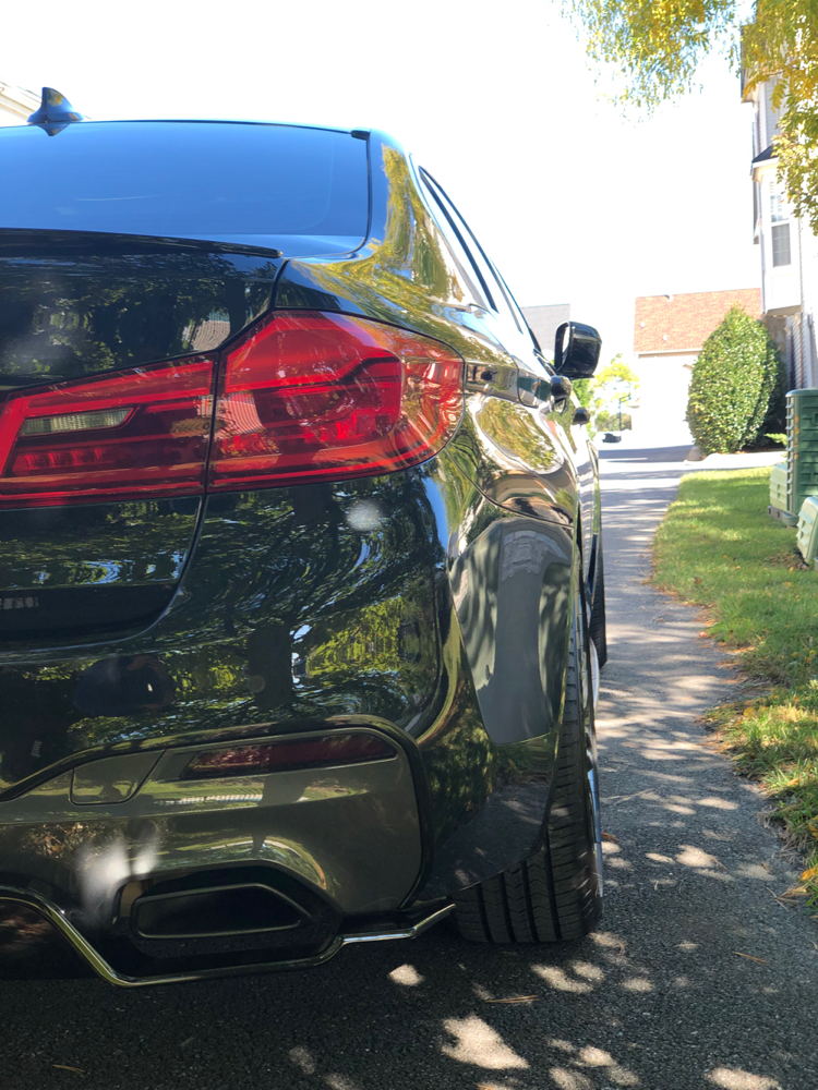

I was able to successfully paint my tips gloss black. Just checked and its been around 60 weeks since I did it and no issues.
To get them off, I warmed up the car for 5 mins or so. I found that with a warm exhaust, it's easier to take them off.
A mate of mine recommended to use Foliatec exhaust spray paint. This is an all in one primer, colour, laquer and hardener. I ended up doing around 3 coats. It recommends that you leave them for 7 days before putting them back on the car and exposing them to the high exhaust temps.
After 7 days, I coated them with some left over Gtechniq C5 wheel armour. I'm glad I did this as it makes cleaning them so easy.
Few pics below. For reference, I paid around £25 for the Foliatec spray. BMW do sell some black exhaust tips, but at £102 each I think the DIY is the better option!
