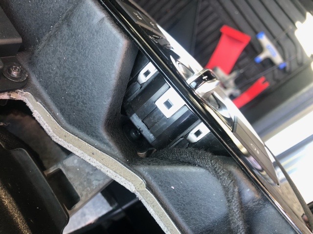

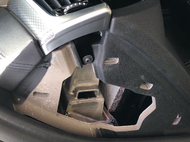

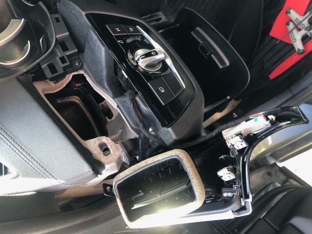

As many of you know there is a service bulletin for the headlight switch. After taking it to my local dealer and telling them what it was they charged me $277 to diagnose it and then wanted another $770 to replace it.
I am not new to working on cars so I decided to do it myself and took photos so I can provide instructions to do this yourself in 5 mins with simple tools.
If your headlight switch looks like this then you are in the right place. If your lights turn on and off during the day then this is your problem and the part is only $165 from Rock Auto.
I used a nylon pry tool to remove the side trim and it exposes one screw that you can remove or move out of the way the vent above the headlight switch.
The switch will come right out with only the plug attached to the back. It unplugs by just pulling on the plug.
Now plug in the new switch and reverse the process. I slightly pulled back the weatherstripping on the door to work the side panel back in.
You could probably reach your hand in behind the light switch without removing the vent but it’s just one screw and it’s a T7 Torx size. If you dont have Torx just reach your hand in the hole and push out the light switch from behind after removing the side panel.

Some more photos for you guys.
