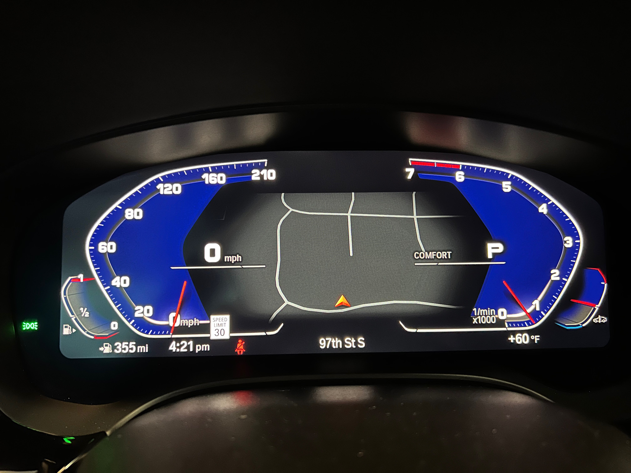

Hey’all,
I have a 2020 m550, doing some basic coding with BimmerCode I found the cluster I like, but I am wondering if it’s possible to remove or change to the “m550” logo in the top middle. See below.

Based on my notes, BimmerCode doesn't have the option so you would need to use Expert Mode, provided you know which specific parameter(s) to change. ProTool has an option for this called "Cluster Logo" that I used to code my 2020 M550i.

Looks like that’s the only one it lets you add the logo, otherwise disappears. Also address on some of the others is off center.

I remember that I lost the logo but don't know what I did to remove it. It could have been the 200 mph cluster. I used ProTool to add it back and haven't had an issue since. Too bad it doesn't work with any of the other displays though.

Try this, it worked for my 2022 M550ix.
Go to instrument cluster in bimmercode.
Then go to 3001 KI_PARAMETER.
Then go to LOGO_SCHRIFTZUG.
Finally just scroll down to your model, select, go back and code.
