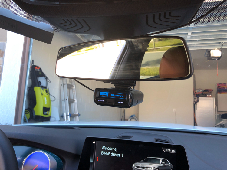

Wire to to the fuse box to fuse #50 with a tap. I HIGHLY suggest not doing a mirror tap. BMW's are very picky on power. Fuse #50 is unused and is constant power. It's very easy to do and won't eff with the electrical current needed for all of the safety systems in the mirror housing. Plus those harnesses are really hard to get to.

Personal experience or did you learn this from others? Thanks for the info. Might prove useful if I pull the trigger on a Blackvue dashcam. Or I might use the Blackvue OBD2 adapter.

Here is your answer!

Thanks that’s perfect. I did notice the socket turns off after 2 mins. You were correct. I like the mount and wiring off the mirror. My corvette has the blend mount on the mirror and it works perfectly just like your pictures.

just ordered mirror tap and blend mount, which two color wire did you tap into?

Earlier he mentions specifically not to use a mirror tap so I think he added a fuse tap and not a mirror tap.

You do not want to use the mirror tap. I still have mine what I ended up not using. The harnesses are incredibly difficult to get to and it's not advised to mess with any of the electrical current going to the safety systems inside of that housing. Just don't do it.
Go to fuse block number 50 with a fuse tap. The fuse box is located on the passenger side kick panel and is very easy to get to.. if you run a direct wire, just make sure to route it behind the airbag in the A pillar.

Just installed it! Thanks Vguitar for the help.
