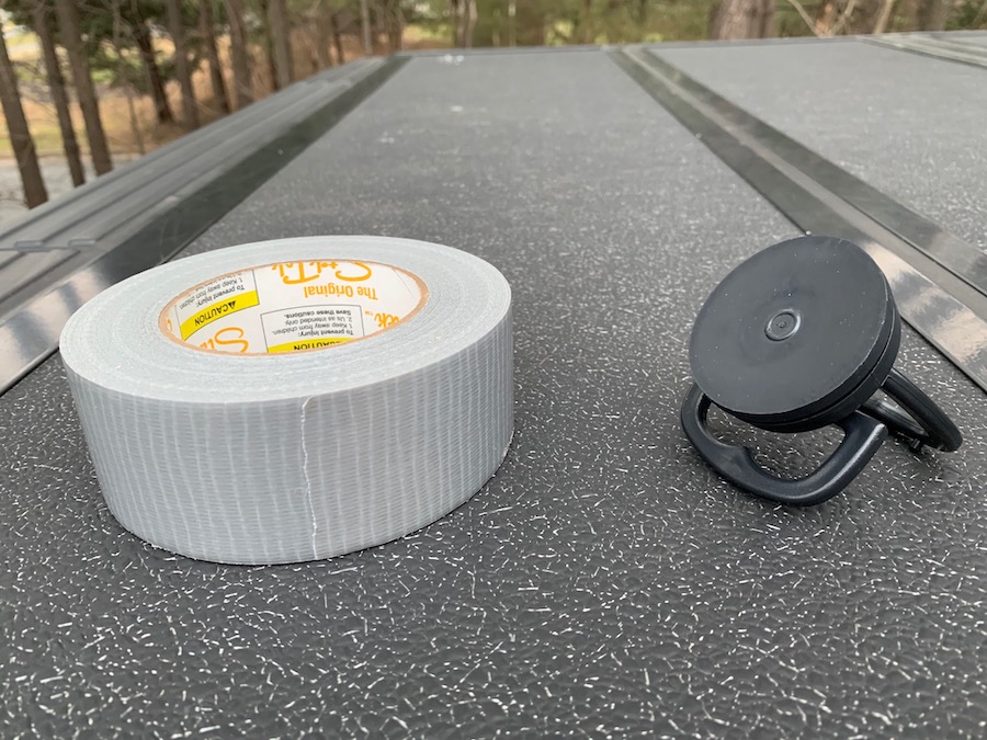

The contenders:
This is a battle of duct tape vs a 2-1/4 in. Suction Cup Lifter. I hope you are familiar with duct tap. I'm not going to bother with brand, a link to buy, or anything like that. You probably have some already and if you don't it's like $3-5 at your local hardware store for 50 yards of it. As for the Suction Cup Lifter, it's only $1.99 at Harbor Freight. I found the size from a video posted on one of these forums that shows a similar one being used to pop up the center caps from a Telsa.
Here's the one I used (pictured above):
https://www.harborfreight.com/2-14-i...-lb-57498.html
I set out to see which of these two methods worked and was the easiest. This is not the most scientific of methods, but I'll detail how it went down. First -- wipe the center caps down to make sure they are clean before attempting anything.

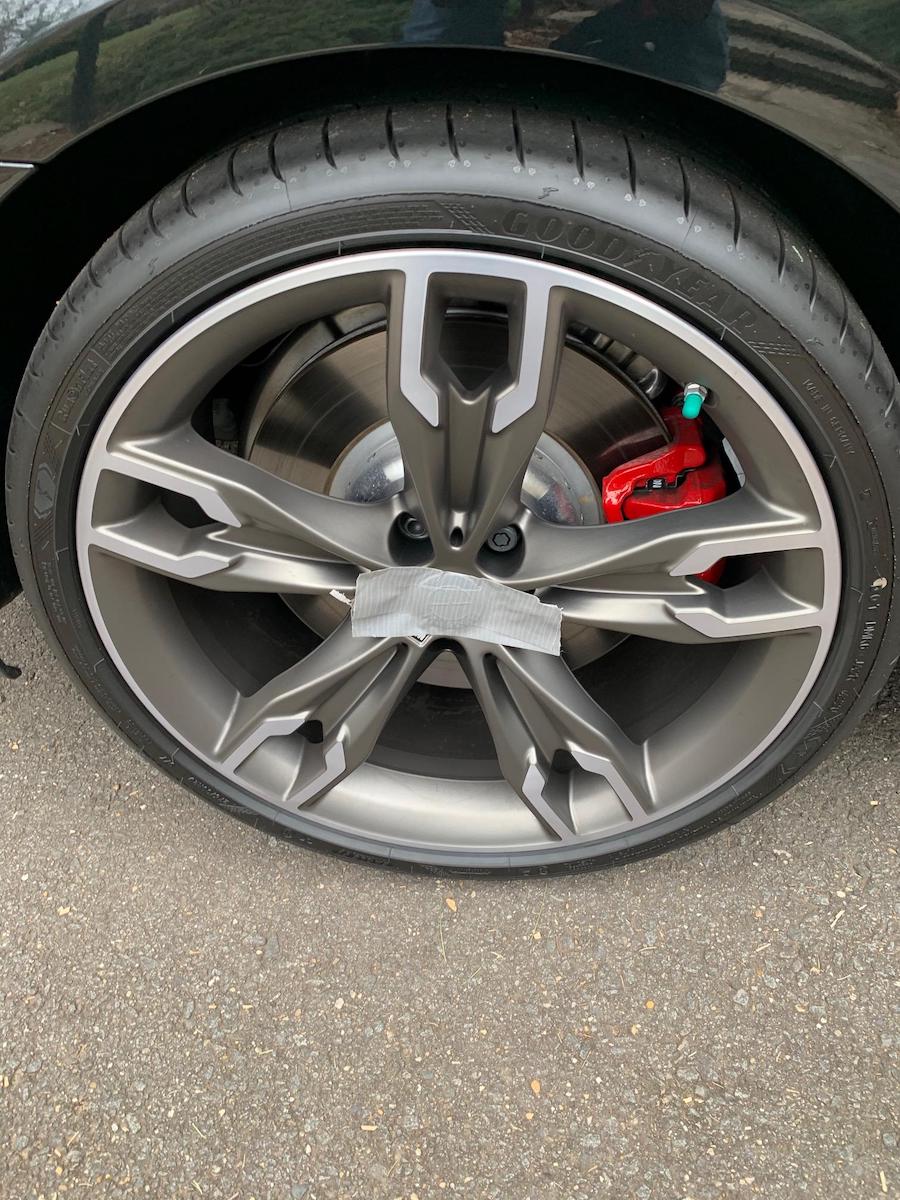

Passenger Front - Used two pieces of duct tape to ensure coverage over the center cap. Pressed it down firmly around the cap.. pulled.. great success. Super quick.
Round 5
Driver Front -- Returning to the driver side with my vast experience and wisdom of 3 minutes of other intense work on the passenger side. This time I now used two pieces of duct tape against and pressed it around firmly all around the cap.. pulled.. popped out without issues.
Size:  102.7 KBName:  duckit.jpg
The Winner
In the end I would say the winner is Duct Tape. It's super easy and very consistent. You just need to make sure you have good coverage over the center cap and make sure it's firmly pressed down / nicely adhering to the center cap and just yank. You could probably rock all of the center caps off in like 30 seconds or less if you did a speed run. The suction cup puller is not consistent enough and ran into issues with a stubborn center cap. There you have it!

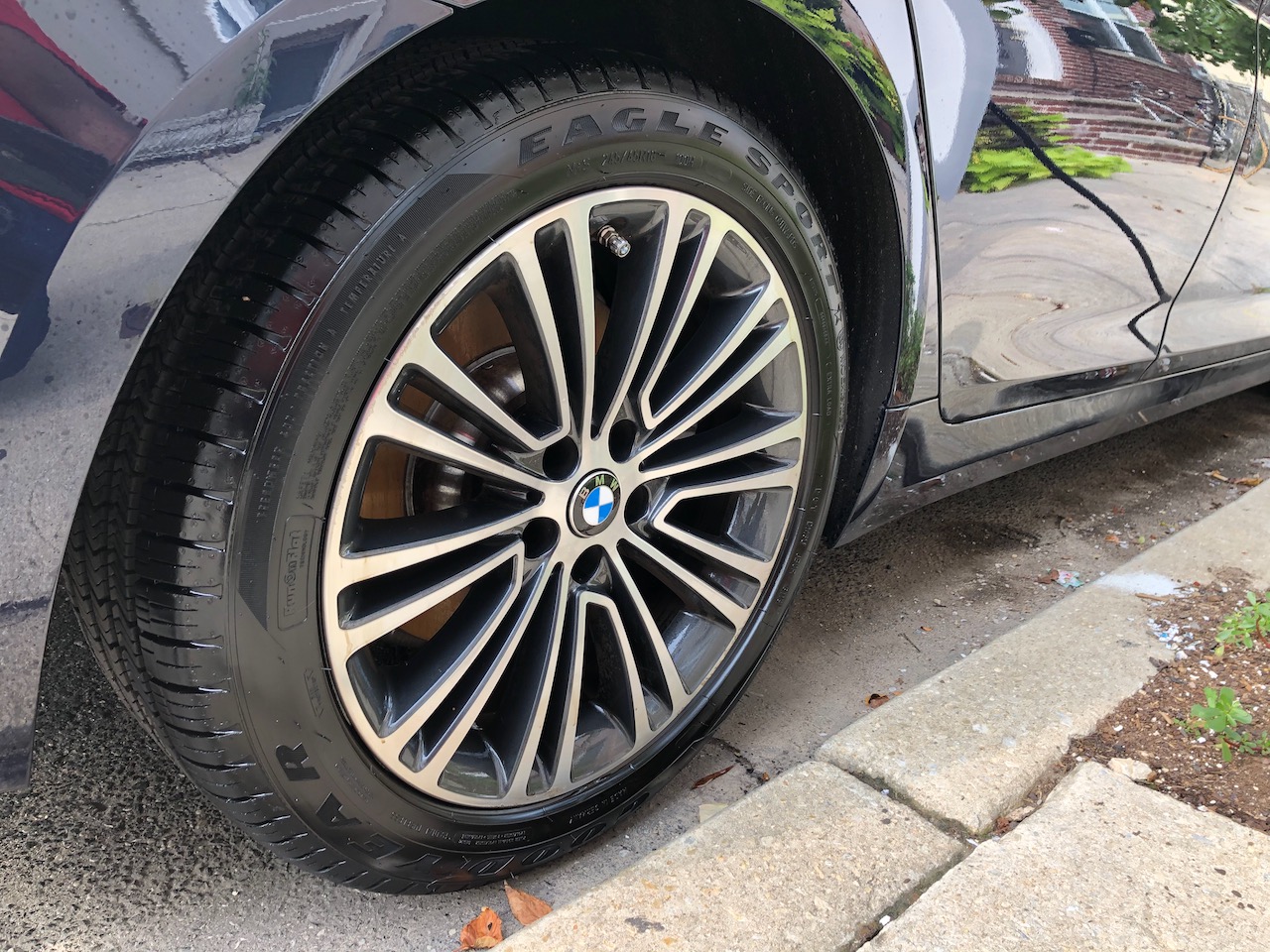

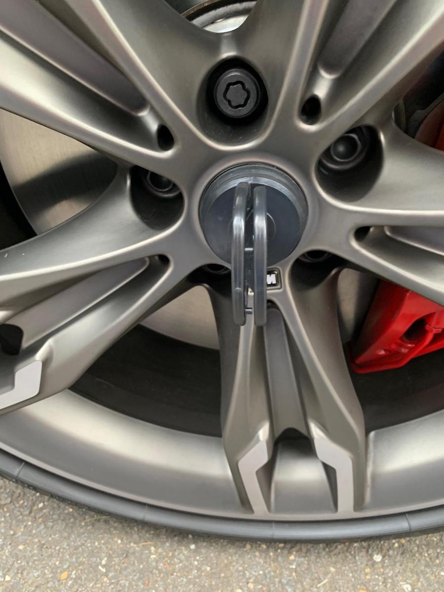

Originally Posted by AHall View Post
Picture of new cap??
Here we are.

Originally Posted by crypto View Post
Here we are.
My OCD is killing me. the cap needs rotated 180 degrees so it is same way up as the small msport badge
