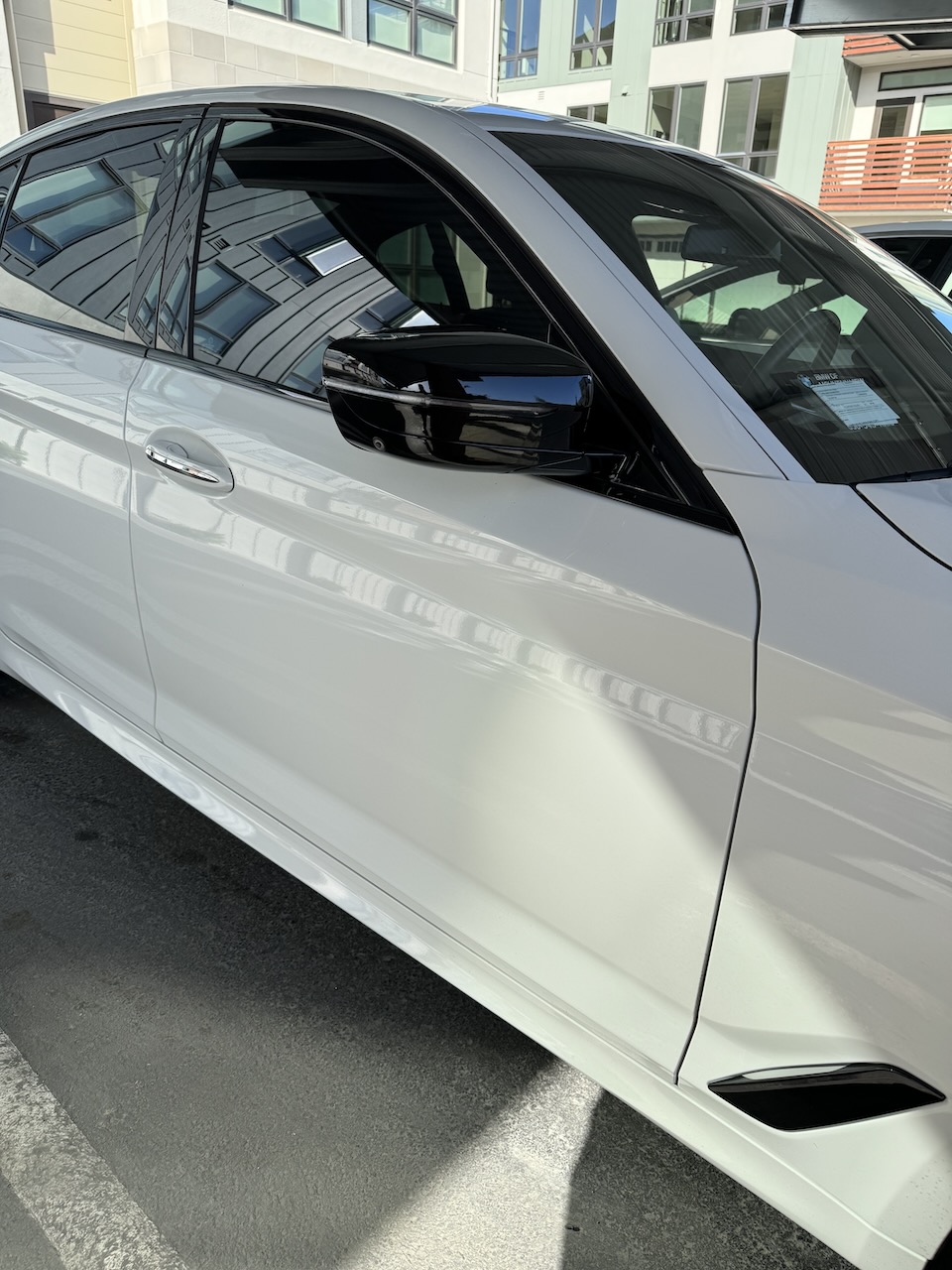

More gloss black pieces. Side vents and mirror caps. Amazon for the mirror caps and eBay for the side vents. There are lots of parts that are stick on, I made sure the ones I got were direct swaps for the original pieces.

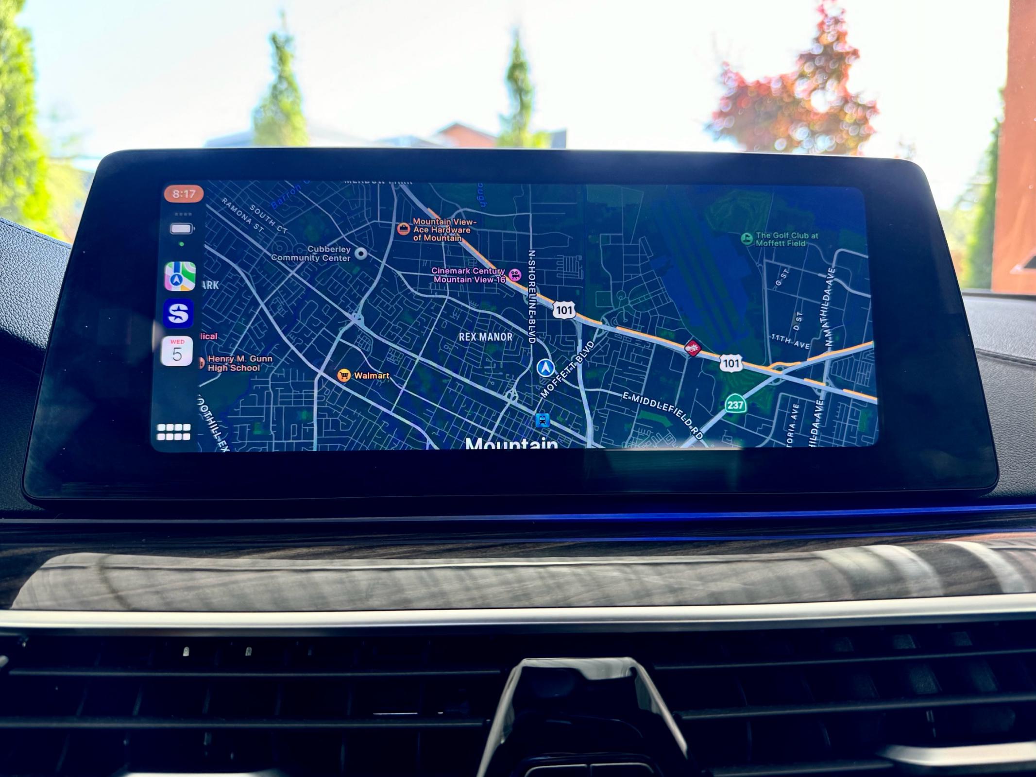

Coding!!!
Got a Vlink BM+ OBD adapter and Bimmercode and I coded a few things. M startup screen, 200 mph speedo and the real reason I got Bimmercode was to code full screen CarPlay! I was on software version Y so it was ready for simple coding to change the CarPlay from oartial screen to fullscreen.

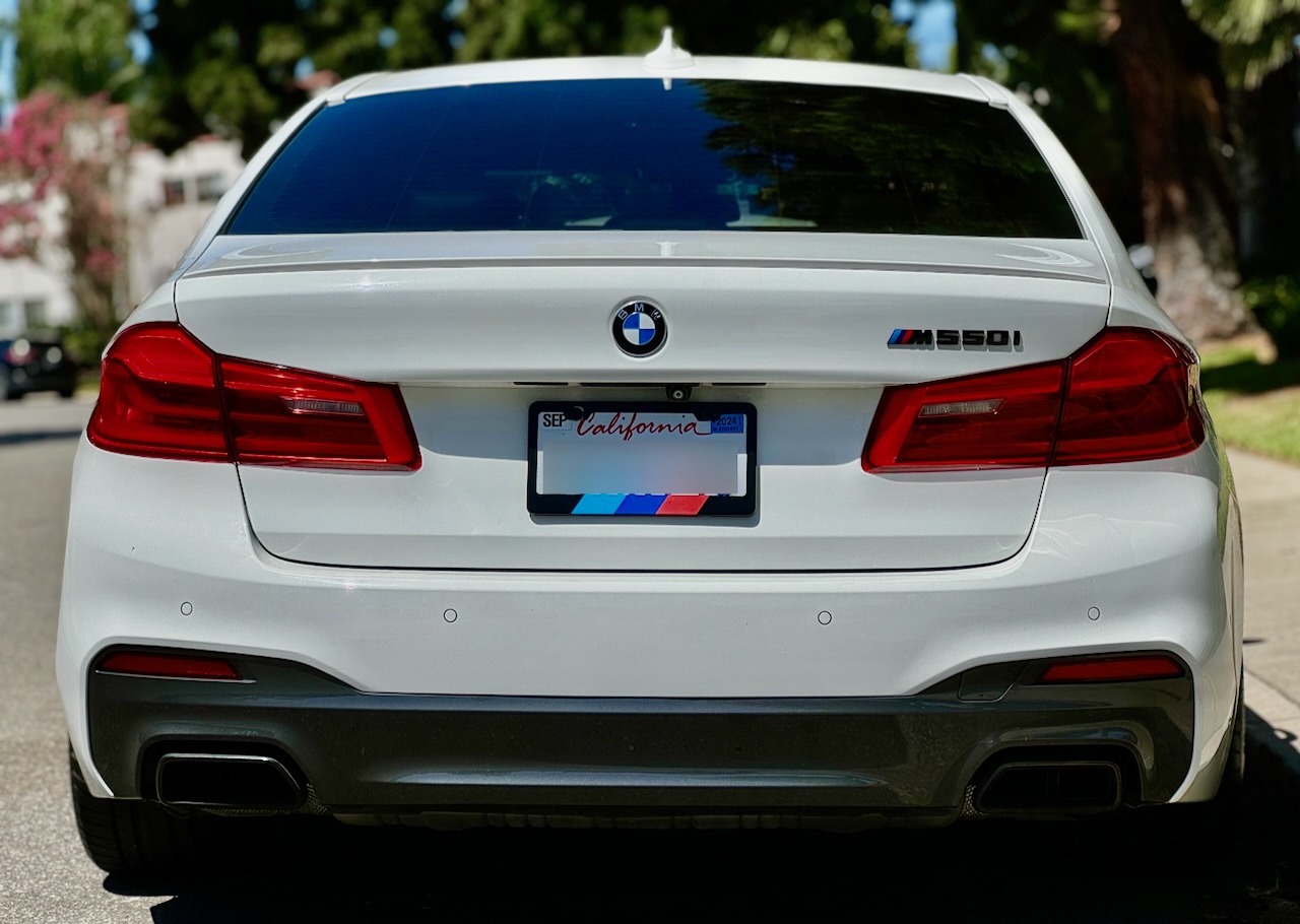

Just did some photos of the car. Here is a dump.

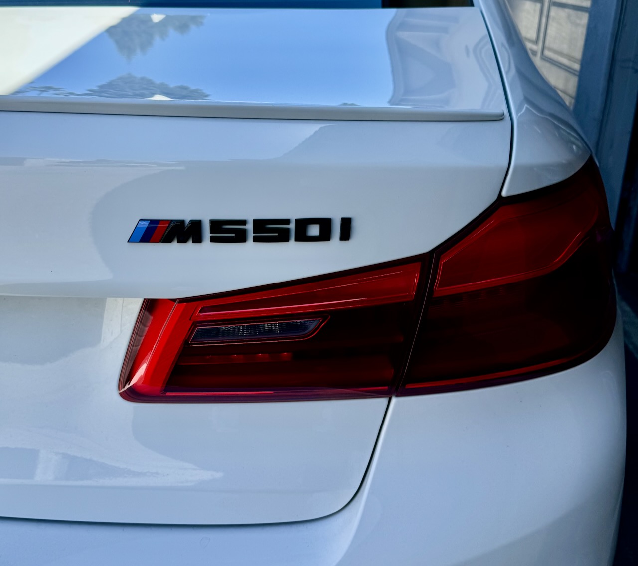

Got my Gloss black M550 badge from IND in the mail today.
*Mini rant...I ordered from somewhere else as IND wanted to charge something like $30 to ship...I found it closer, and it shipped for $10 and was here the next day. OK rant over.*
Install was easy...
I used masking take to mark where the previous letters were and to make sure the new letters went on straight and exactly where the old ones were.
Used a heat gun and dental floss to remove the old letters. cleaned off the excess glue and carefully put the new letters on.
The new badges had self adhesive already on them so just peel off and place.
It's subtle but it fits the whole "Stormtrooper" theme.

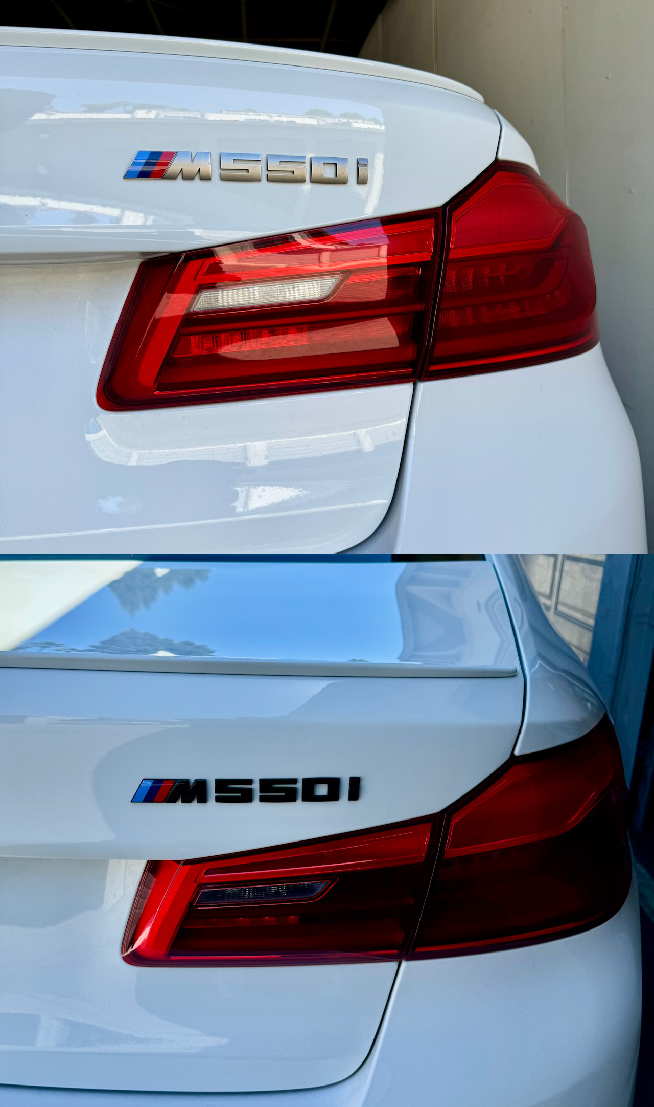

Before and after:
