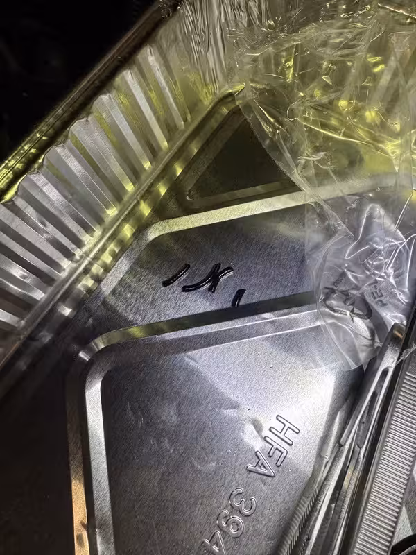

I found the issue:
Defective Mahle Oil Filter
The plastic tabs on the Mahle filter seem to have cut up the bottom O-Ring on the filter causing the O Ring to become scattered around the engine.
I got an oil change around 200-300 miles ago with last night being the first longer (20 mile drive) since the oil change.

1/2 of the O-Ring is still MIA. My mechanic is coming back over at some point to try and vacuum the rest of it out. Is that doesn't work I will end up having to replace the OFH at a minimum.
Both my mechanic and I were shocked this happened. Mahle is considered a high quality brand in the aftermarket and is OE on many BMW parts. I reached out to Mahle through their website to see if they will cover any of this.

After pulling off the Oil cooler I found two separate oil filter O-Ring bits that were lodged into the fins. The Oil cooler ended up saving the engine but I didn't order a new one. For all the Denver owners out there Schomp BMW in Highlands Ranch has a huge parts inventory and they had a new Oil Cooler in stock for the low price of $400~ retail. At the counter I told the guy I had an wholesale account then gave them the name of the shop that I go to and sure enough they did and I got the cooler for $200 out the door.
