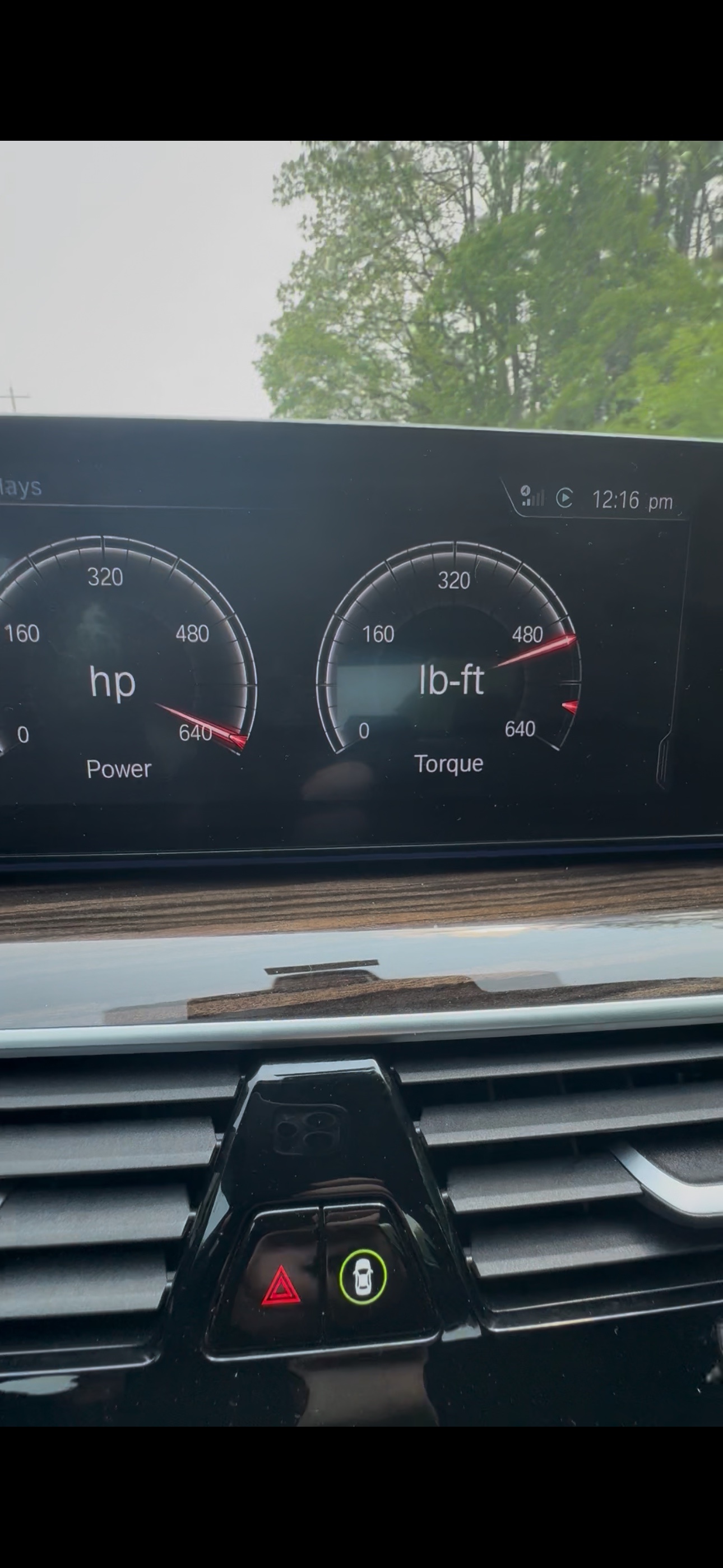

The BimmerCode sport gauges i maxed out at 640 so… I’m almost afraid of what stage 2 e85 will do when I put those in and do a flex fuel pump and lines.
My experience is that people call you a liar when you talk about specs lol.
Do it.
