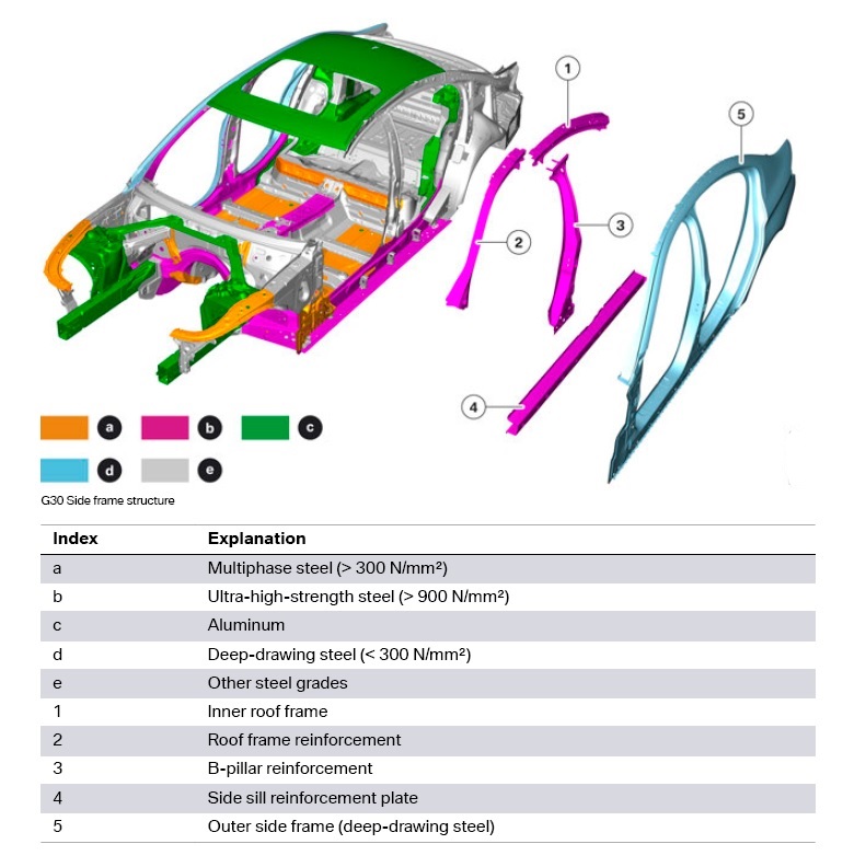

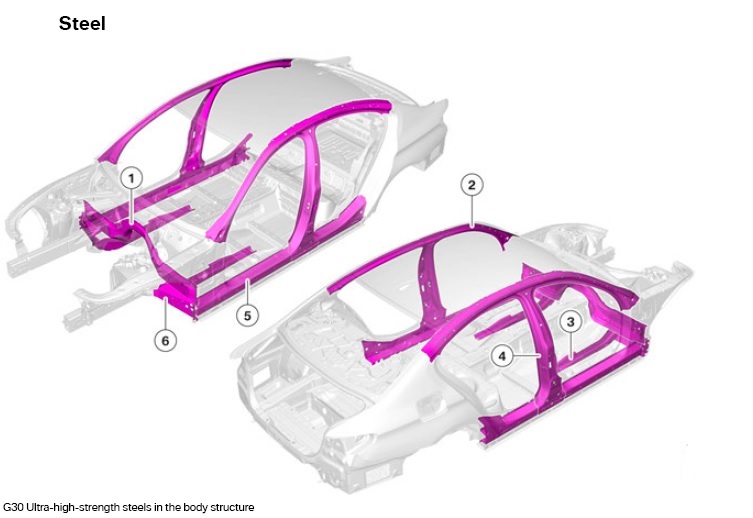

Metals used the the G30 Body
BIMMERPOST
     Featured on BIMMERPOST.com
High-strength steel and Aluminum
There is no Carbon Core

Nice. How does this compare to the F10?
As a result of the strict lightweight construction philosophy, the weight of the body has been reduced by around 46 kg / 101 lbs over the predecessor F10, but crash safety has been further improved.
A boot lid made entirely of Aluminum has been used for the first time on the G30. As a result, a weight
reduction of 4.2 kg / 9.5 lbs was achieved over the F10.
F10 Metal

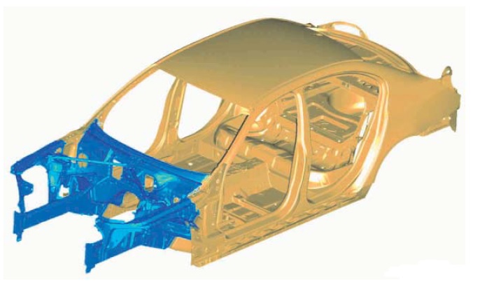

E60 is worth talking about too.
Fully aluminium front frame.

True, the front structure of the G30 has more in common with the E60 than the F10.
E60 was such a beast. Glad to see the G30 is getting the weight down. F10 was amazing IMO. I think it was beautiful but the driving experience went the opposite direction of the E39 and E60

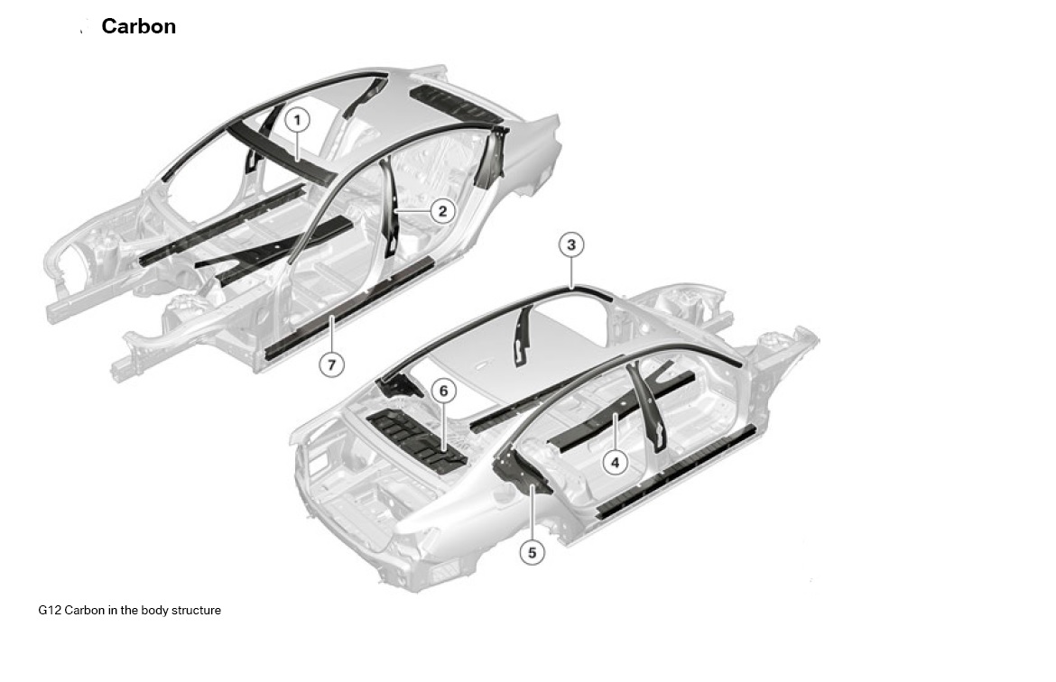

Three pieces of carbon? That's a pretty damn liberal use of the term "Carbon Core"!
Many more than 3
aajami442.50

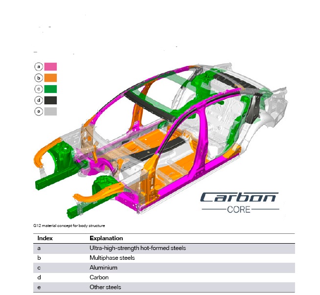

G11/G12
Carbon Core

Originally Posted by E90Fleet View Post
Many more than 3
Thanks for clarifying. The first pic was misleading.
