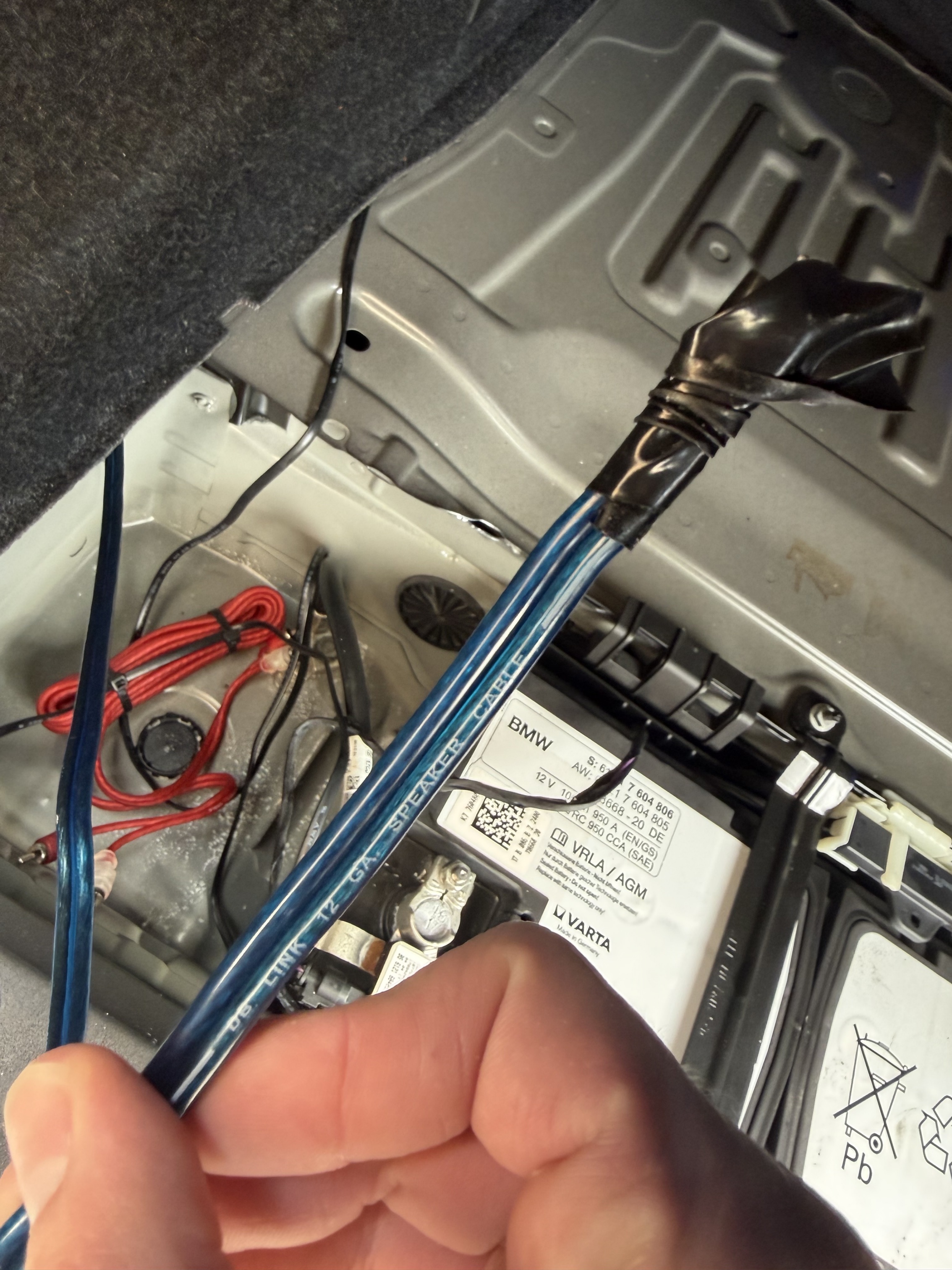

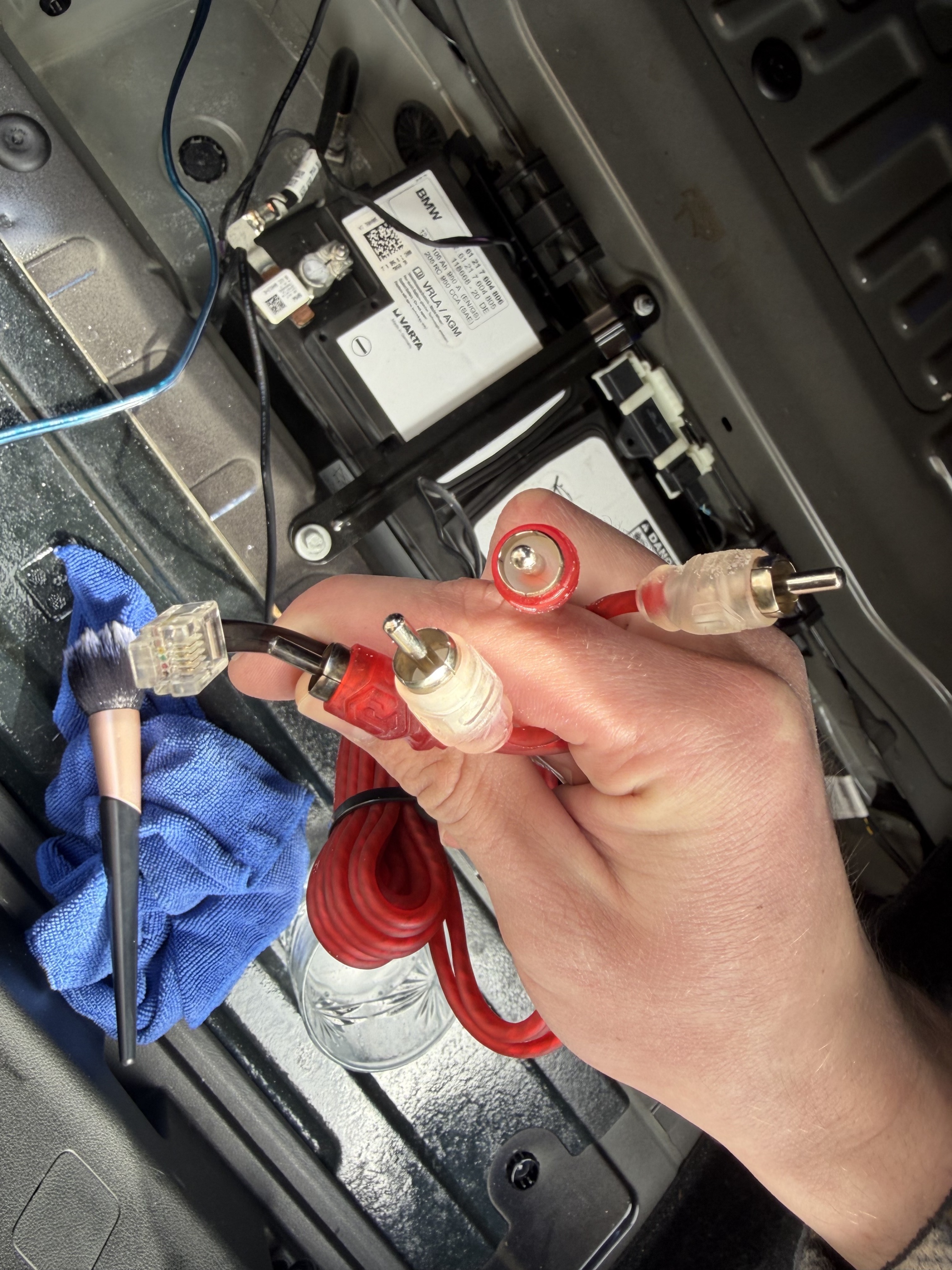

Hey guys I’m trying to install a subwoofer and it seems the previous owner had the same idea however I’m not a big audio guy is there anyone that could point me in the right direction to what u could connect to these or what my next step is to installing a sub in the back? I’ve been told a single 12 should be good enough for my base needs.
