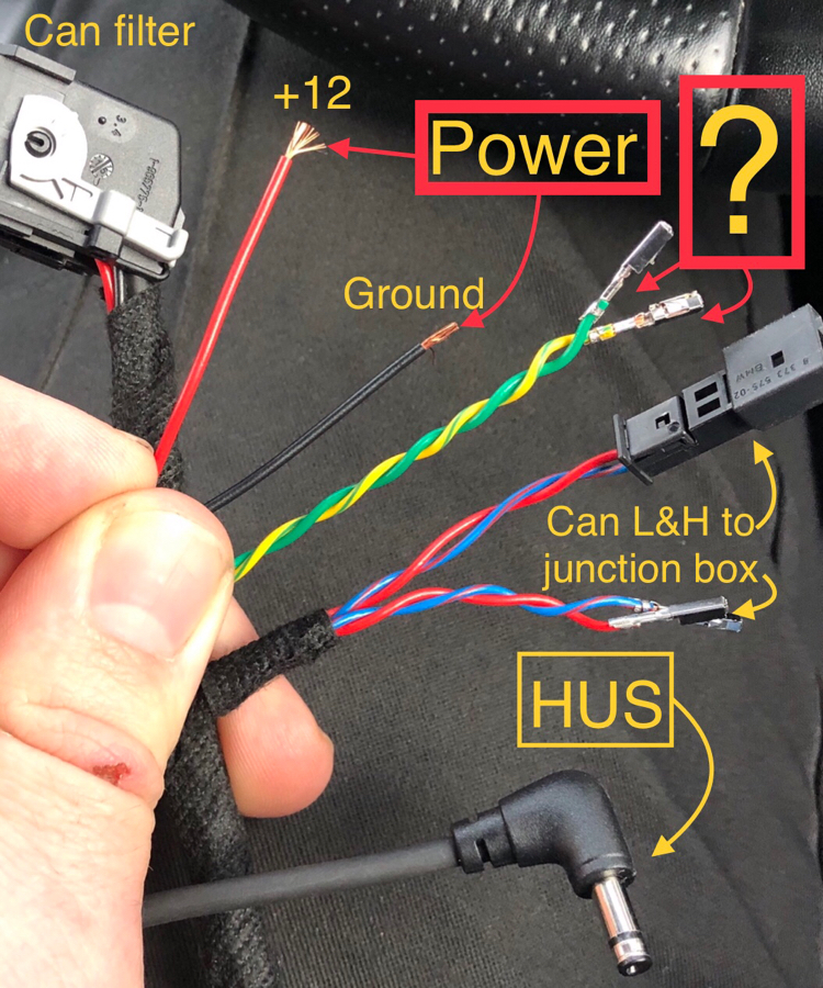

I've heard that in 2020 garmin app will disappear BMW going to replace can filter and then HUS gonna use navigation data from your built in sat nav (I've read this on another forum so I might be wrong)
I've got both kits and the wiring is slightly different 62302410673 (the one that uses build in sat nav) has extra two (yellow/green and green) wires which I can't find any info where to connect them to, the can filters probably are different as well, can provide pistures on request

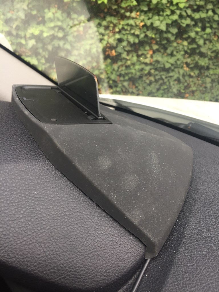

Originally Posted by weselyn View Post
So, I finally installed everything. this large frame fits well and is attached with 3m glue pads. no drilling is needed.
Electrical connections are easy, except that two clips for stealing ground and power connections are awful. Please find better one.
Please note that this version works with "integrated navigation" that is retrofit nav in case you do not have it already. I do not need to do anything with my phone.
Visibility is good, except if you have sun low on horizon in front of you. but then any visibility is low. I assume that rubber back plate could help in this particular case.
This is not true Head-Up Display with picture in infinity, but it serve the purpose, and I am very satisfied for now.
It looks completely as part of original equipment.
Attachment 1877629
Attachment 1877630
To install big frame, I had to remove this small one.
Attachment 1877631
Hi where did get installation instructions? I'm trying to fit one like yours (that works with integrated nav) but in wiring there is two additional wires (yellow/green and green) where did you connected those?
      03-15-2019, 08:56 AM   #246
Darudis
35
Drives: F31 330D
Join Date: Jul 2017
Location: Bradford
Does anyone know where I connect them two wires? Please help

So any news about the yellow and green pins?

Hi. There is a green and yellow wire that one of the users didn't know where to insert. Can you please advise as long as you succeeded in retrofitting the integrated nav HUS?
