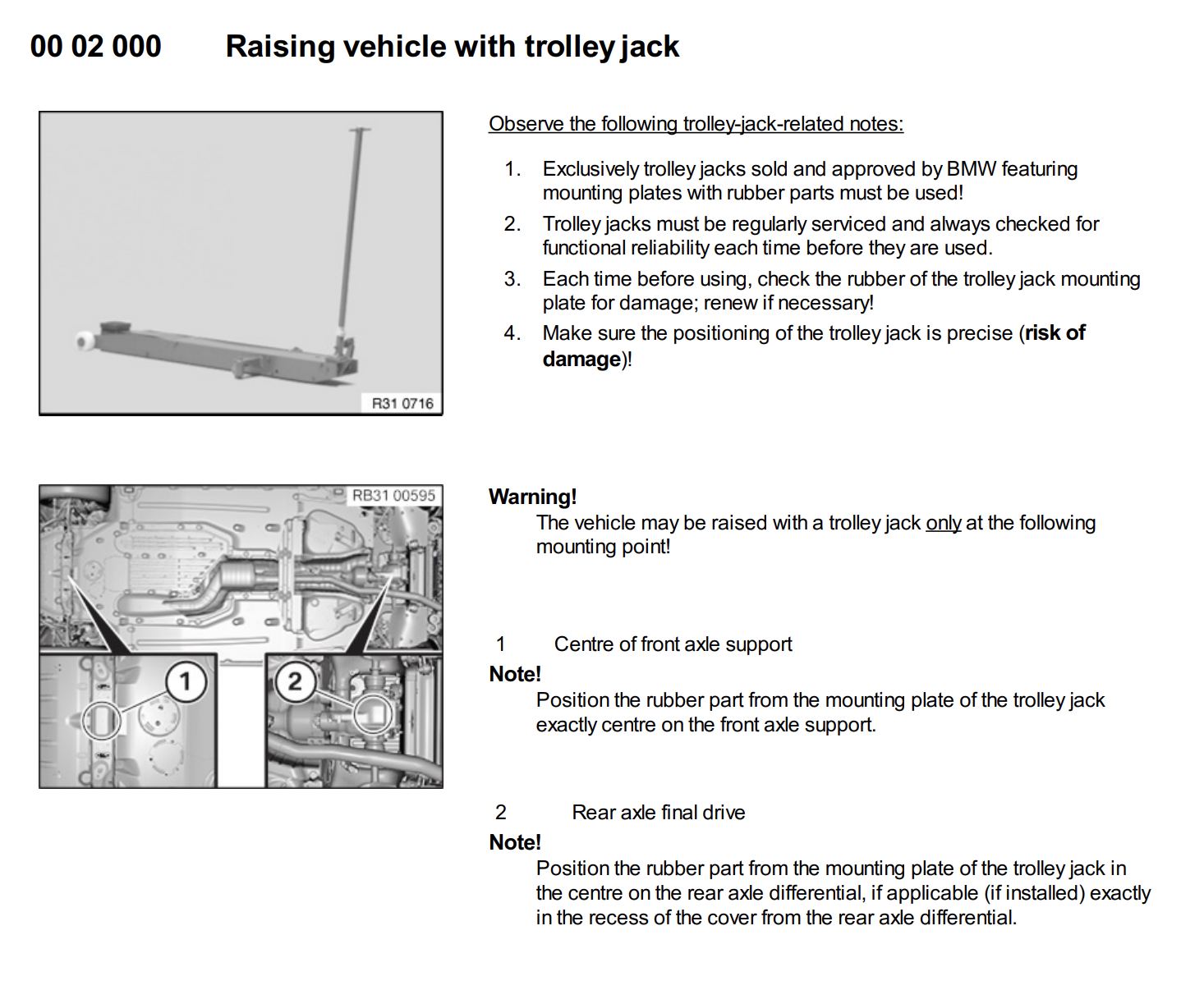

Hello, I am looking to change my oil on my 2021 530i. Is the raised center portion of the subframe the correct location for a floor jack? See attached photo…

Yes

Thanks, confirmed it worked no problem.
I got a little freaked out as the first time I jacked the car up at that spot there was a sudden loud creaking noise... must have been the jack!

This is for the M550 which should be the same for yours. Source: ISTA

Thanks zvery777 I actually found the page from the 530i service manual, in case anyone else visits this thread I'll save you the trouble:
