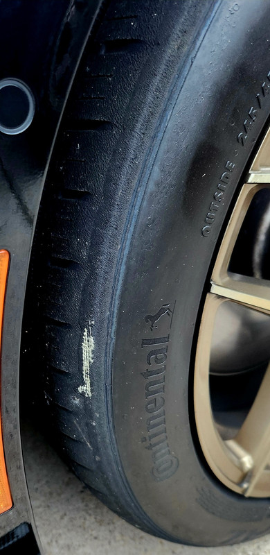

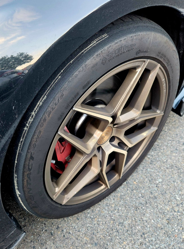

Hate to be a party pooper here, but these tires just did not work out for me. I settled for these after not being able to find any PS4s in the size I wanted; '22 M550i with 245/45/19s (square setup).
Pros: Good ride comfort, acceptable road noise, good grip (albeit notably 'squishier' around the corners compared to the PS4s I've had).
Cons: Abysmal tire life and uneven wear.
First set lasted about 10k miles before the outer edges of the front wheels were on cords and rears weren't that far behind.
Second set lasted about 9k miles before same issue as above.
Notes:
-My daily commute since the past 15 years contains about 20 miles of twisty canyon driving to and from work.
-Every car I've had during that period I've thrown around the corners to extract max smiles per gallon (about 6 different cars, various makes and models of tires too), and I've never seen tire wear like this.
-For contrast, the M340i (RWD) I had just before the M550i had PS4s that lasted 30k with even enough wear than these.
I switched to BFGoodrich G-Force Comp a A/S Plus because I didn't want to burn through a 3rd set of the Contis. Probably going to tone it around the corners for a bit because this is getting expensive, haha! Not to mention, tire warranties are rejected if you have uneven wear.
