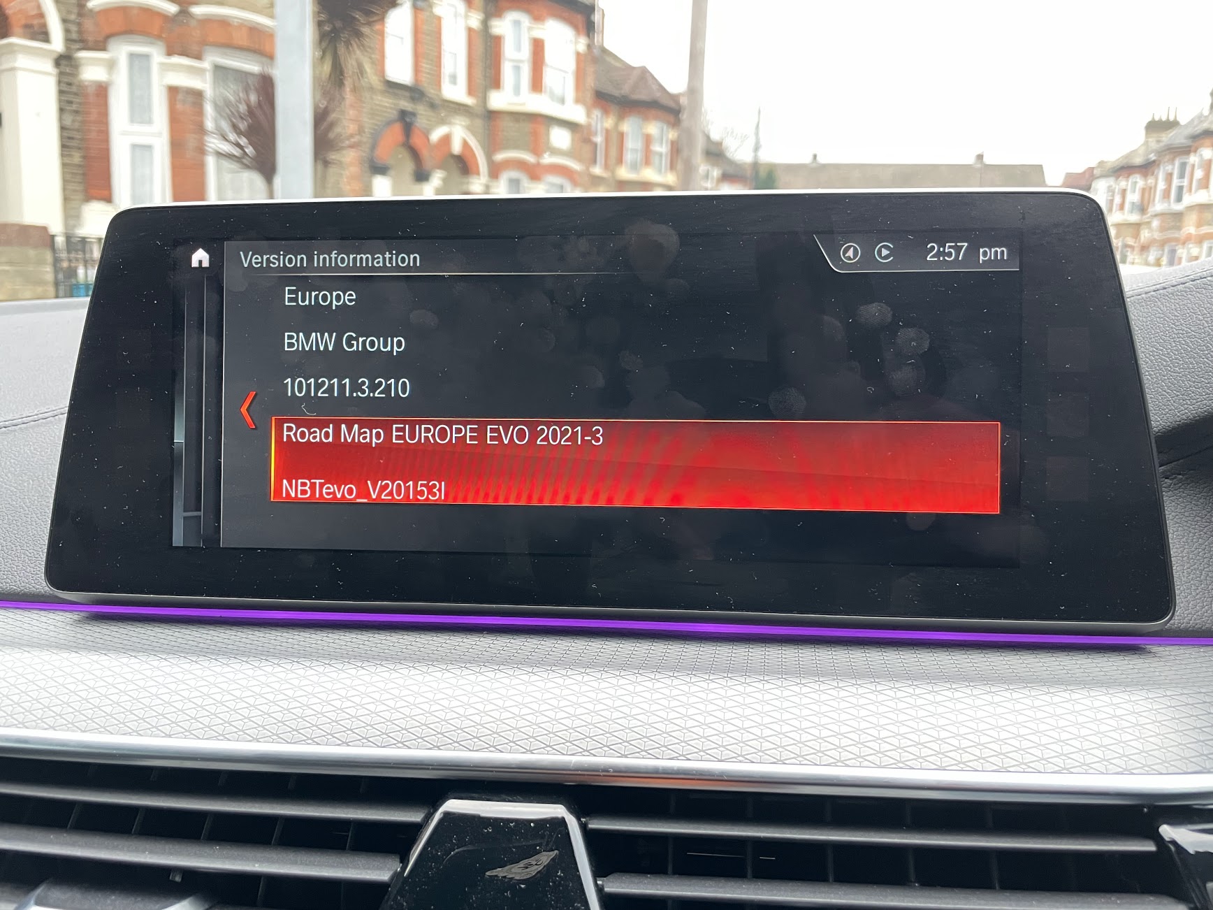

Hello all!
I've got this weird issue I can’t update my maps.
I have subscription and I’ve downloaded it from the BMW download manager however, every time I plug it into the car, either the usb slot near wireless charger or even the one in the gearbox, the iDrive doesn’t auto prompt me for update. The usb is recognised by the car, comes up on the devices list however the map doesn’t update. I have tried with 3 different devices with different capacity and all supported formats – still cannot get car to bring up the update screen.
I got the car about a month ago, on the automatic map update bit, it showed GB, IE 2017-3. This has now changed to 2021-3, the map I downloaded from the download manager is Europe Evo 2021-3.
See pic, one is my iDrive and the other is the BMW download manager
I’ve previously managed to do map update on both my 2015 & 2014 F30s using the BMW download manager with no issue.
TIA
Solution?
Turns out with the G30 you need to download it somewhere on your computer first using the "advance" option, once this is done then select your USB stick for the files to be extracted onto.
I've just tried this and its worked perfectly once plugged into car. Or if anyone one of you need explaining further.

I think I have found a working solution, I've tried it and it has worked.
Previously in both my F30s I've downloaded straight onto usb and its had no issues, it would extract onto the usb and I plug into the car - it updates.
Turns out with this one... It downloads the file first and then you need to manually choose an extraction folder/device. I've seen the screen where it had a drop down menu to select device list, it also goes onto mention this map will only work for my VIN and if I need to use it for another vehicle then I'd need to download again for said vehicle, but I've always just dismissed it because at the bottom it would say verification complete
So I downloaded it onto a drive on my computer using the "advance setting" once that was done, it prompted me to select a device for it to extract onto, it extracted onto my usb stick and i've managed to update maps.
I did the above and my map is now on latest (image below)
bit of for me
