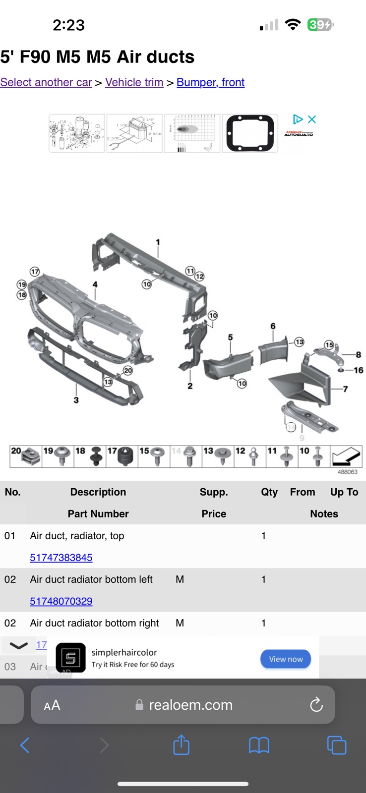

Originally Posted by Alberto540i View Post
Thanks for your answer! The 3-piece wheel arches seem very expensive to me, did you buy the original ones? Regarding the indicated supports, radar support, etc., do you have references? thanks in advance 🙏
I bought the original ones, the best way to get it cheaper is to find a wrecked f90 part out if you can’t find any then you have to buy the original ones.
For the supports it’s number 3, 4 and for 8 you need both sides and for the supports you need screws 17 and 19
And the radar bracket it’s 3 and you can reuse the previous screws
For the air duct you need 3 and for 5 you need both sides
I thought you didn't write to me, and here is all the necessary information, sorry, I hadn't seen it. This is a great summary of what is necessary, I thank you very much for this help. I have some pieces, there is less left to gather them all, I tried to find some of the destroyed vehicles but it is not easy, I will update here so that you can see the change, it will be worth it
