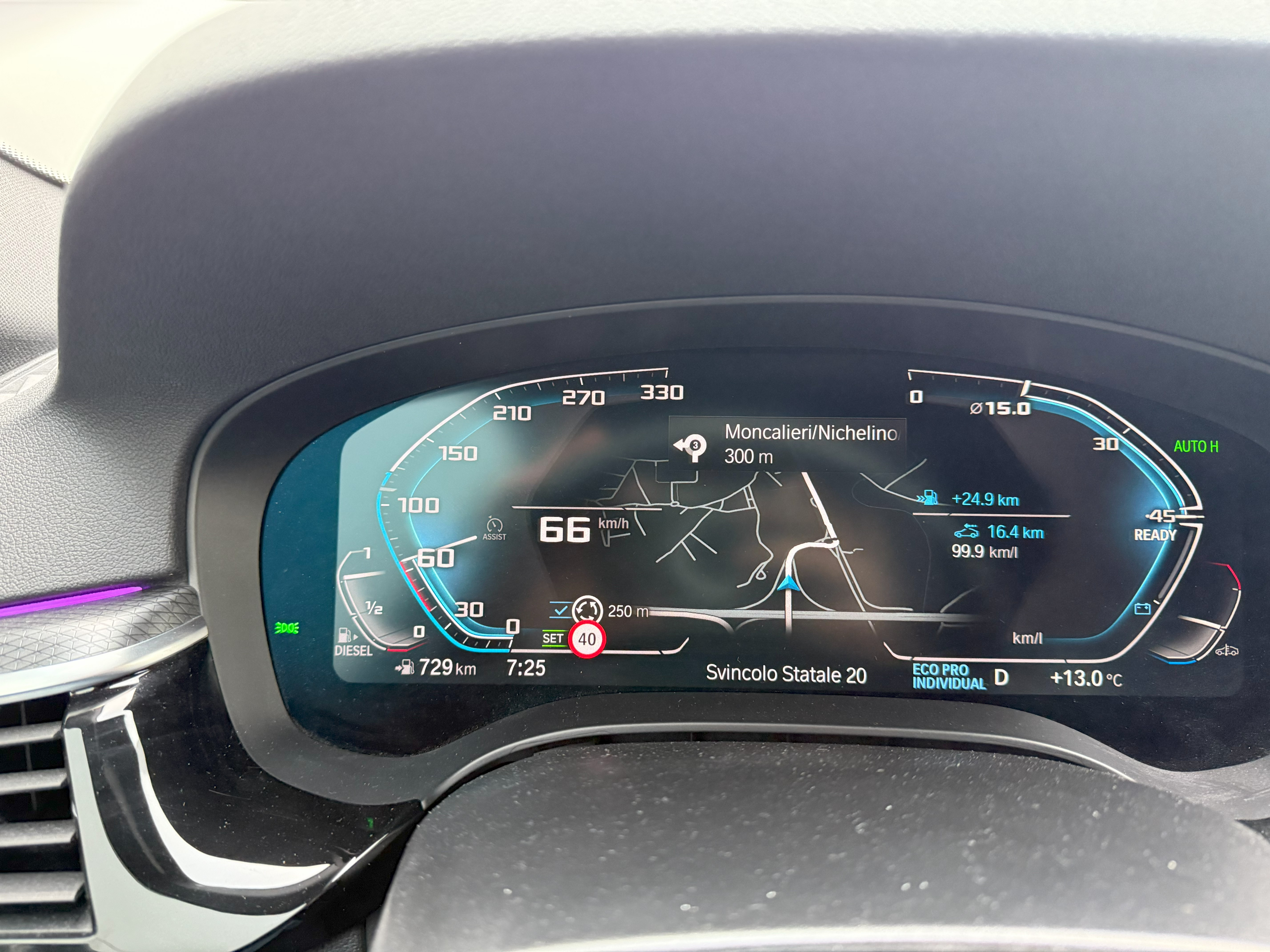

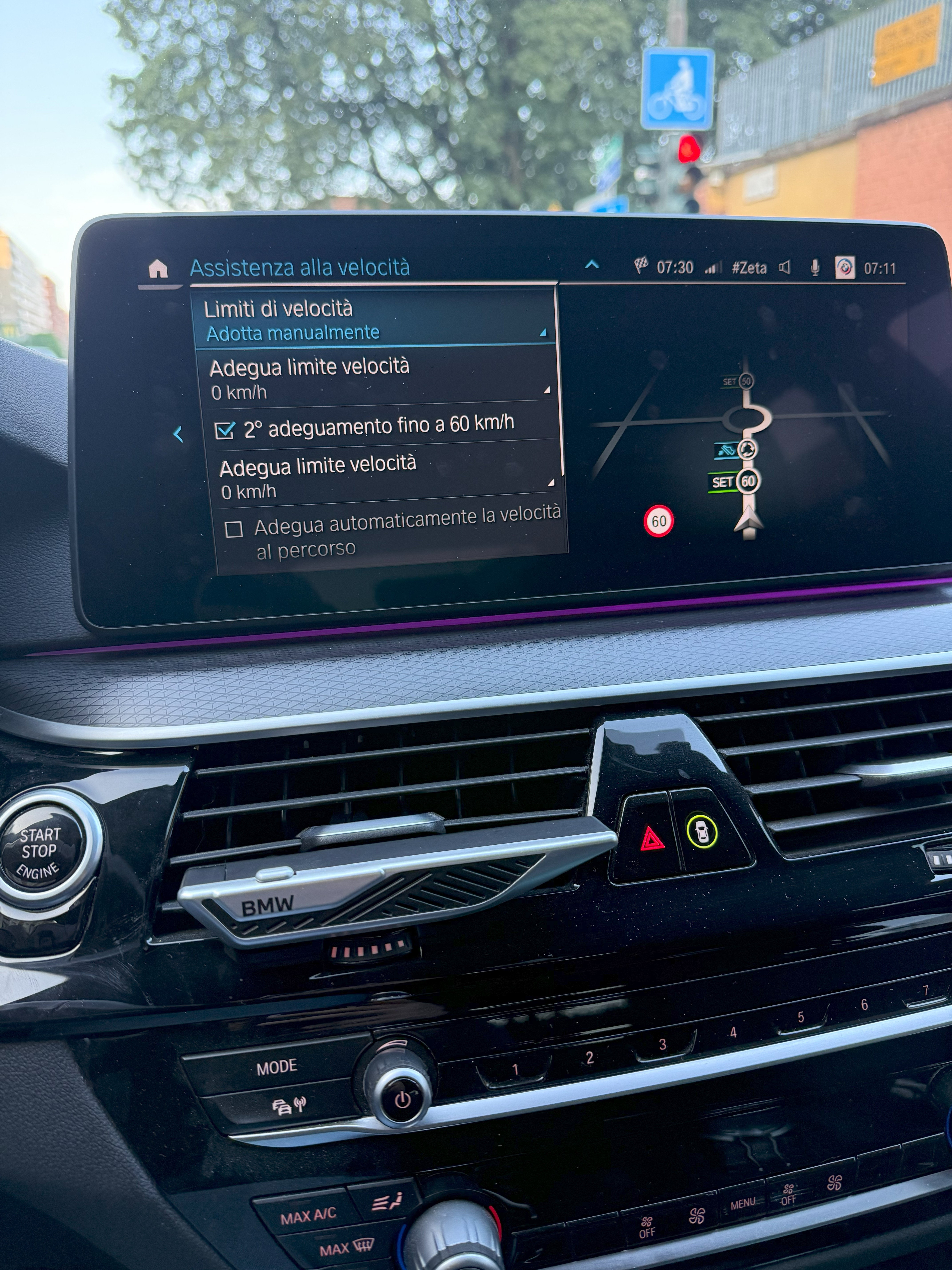

Dear fellows!
Thanks, for sharing you ideas and the way you trying to achieve it
My bmw g30 my2019 doesn't have KAFAS, so i use FSC code, to activate SLI from navigation map (I used sli emulator from ali).
nowdays i try to activate manual SLI assist, i did this codings and have Speed Limit Assist in NBT and can activate it, but nothing happens and i don't have limit assist at dashboard.
Here's my coding:
DSC3:
C_EDP_vorhanden = nicht_vorhanden -> vorhanden
C_EDP_Land_Aktiv = F9, DC, 00, 00 -> all FF
C_SLA_Variante = kiene -----> dcc [01]
C_vSLI_Land_aktiv = UNK_PARAM_1 (FB, DF, 83, C0) -> all FF
C_VZA_Funktion_Land_aktiv = UNK_param_1 (FB, DF, 83, C0) -> all FF
C_VZA_Funktion - false --> true
BDC_BODY2
3420 DG_3420, 14 24 STRECKEN_VERLAUF --- aktiv
PIA_DEFAULT_UEBERNAHME_GESCHWINDIGKEIT aktiv
sas2
C_EDP_vorhanden = false --------------------> true
C_EDP_Land_Aktiv FB, DC, 00, 00 ---> all FF
C_EDP_Vorausschau_aktiv = UNK_param_1 FB, DF, 83, C0 ---->> all FF
C_EDP_SLI_aktiv = FB, DF, 80, 00 ---->> all FF
C_EDP_Anzeige_Zusatztexte: = true
C_vSLI_Land_Aktiv UNK_param_1 FB, DF, 83, C0 -->> all FF
C_vSLI_Funktion - false --> true
C_EDP_Laendersteuerung_Konfiguration Voraus aus matrix, sli immer aktiv---->Vorausschau immer aktiv, SLI immer aktiv
C_ISA_vorhanden false ->> true
C_VZA_Funktion_Land_aktiv UNK_param_1 FB, DF, 83, C0 -->> all FF
dkombi
LDM_ISA_ENABLE nicht_aktiv ---> aktiv
LDM_TIP_ENABLE nicht_aktiv ---> aktiv
LDM_VORAUSSCHAU_ENABLE nicht aktiv [01]---> not change
LDM_VORAUSSCHAU_sli_ENABLE - nicht_aktiv--> aktive
HMI_ECO_TIPP_GESCHWINDIGKEIT_KI_ENABLE aktiv
nbt
slamanuel - nicht ----> gen_1
AUTOTEMPOMAT - nicht aktiv --->gen1
AUTOLIMITER - nicht aktib ----> gen1
HUD_VZA - nicht - > aktiv
KI_DISP_CB_STRECKENUEBERSICHT - nicht -> aktiv
STRECKENVERLAUF aktiv [01]
VORAUSSCHAU gen 1
VOFFSET gen1
After that i have an error in SAS:
Message (traffic sign recognition, 258.1.4) missing, recipient SAS, sender KAFAS
I think i missed something, couse SAS recieve message from KAFAS, but cannot recognize it.
Or it's not possible to activate manual SLI assist without KAFAS module?

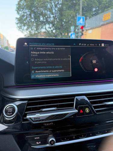

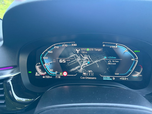

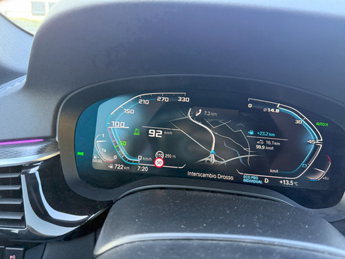

      05-21-2025, 02:47 AM   #64
g31mit
11
Drives: '21 G31 520d xDrive
Join Date: Jan 2025
Location: Italy
FDL coding without any FSC.
I have only KAFAS4MID, no front radar.
edp, isa, sla, sli, vza
