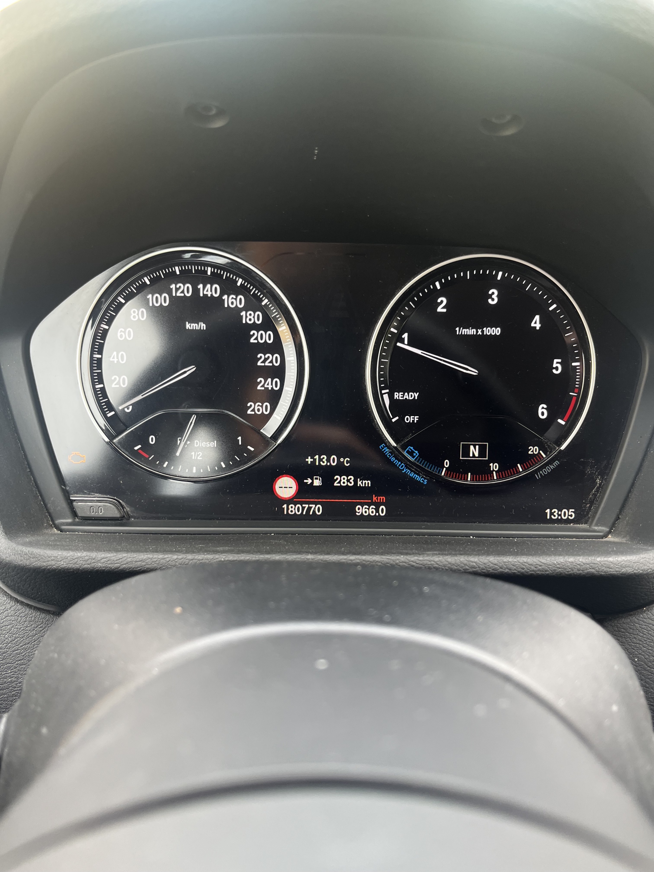

      04-28-2025, 07:07 AM   #34
Tikhonrev
Tikhonrev's Avatar
Belarus
Drives: BMW x1 f48 2019 xdrive 18d
Join Date: Apr 2025
Location: Minsk
Does anyone know how to activate SLI in Belarus. My car can recognise sing in Europe but in Belarus cant. I have kasas2 and esys with enet cable.
