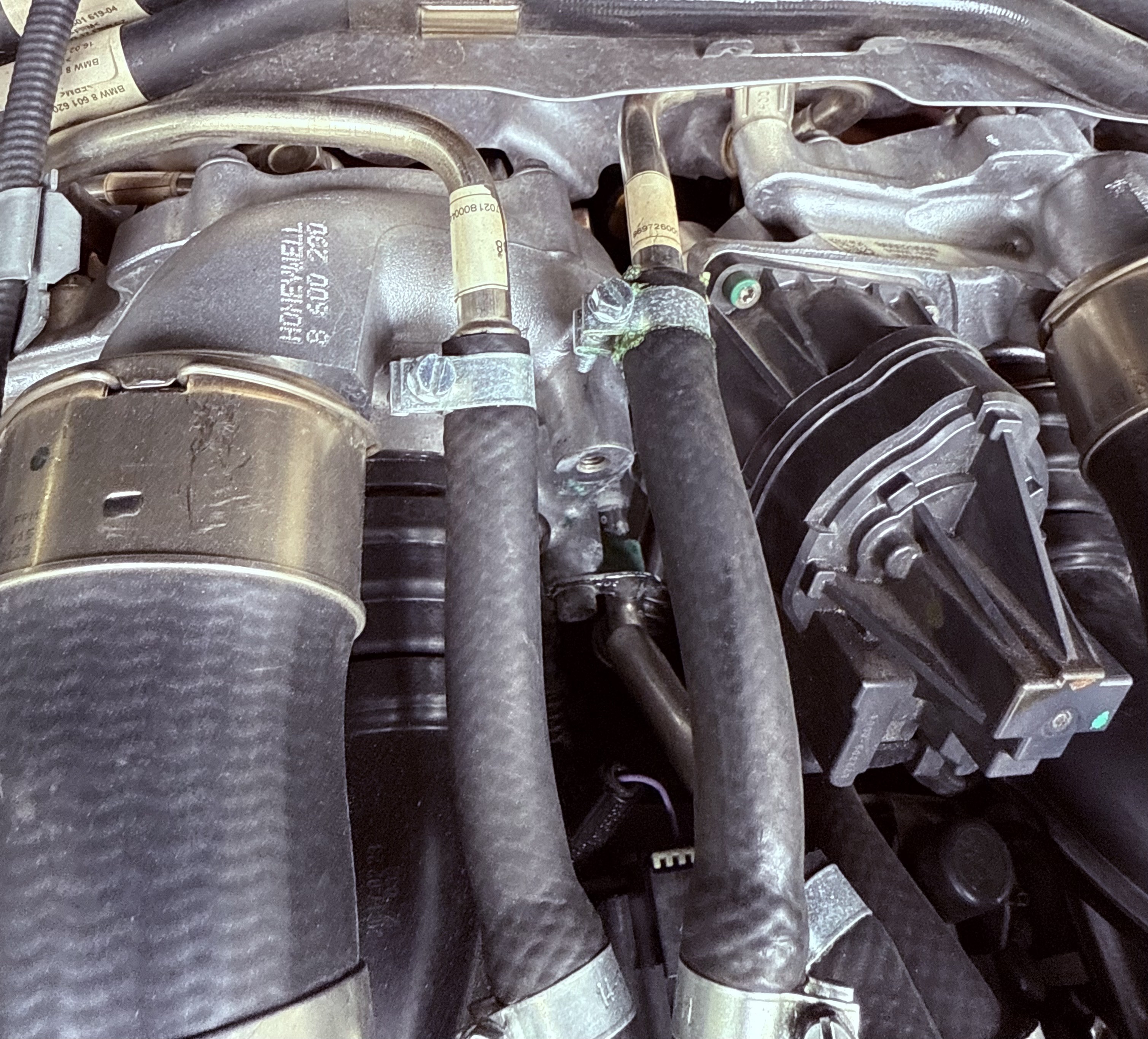

2018 M550 Coolant leak we meet again
So as to no surprise couple months in and the turbo coolant lines started leaking.
People always say you wanna do something right get it done yourself so I’ve decided I’m going to change the lines myself. I have combed through as many diagrams as I can of the cooling system but would like to be sure that the lines in the picture are the return lines. I’ve attached lines Im planning on ordering.
Note: I just want to replace the ones that are leaking not the entire system.

There must have been a design change I have a 2019 and my lines look different.

Yes the lines you have are the updated ones ! From the looks of it I think I’ll need to replace both the supply and return together instead of just one. Unless I’m mistaken.
Anybody who’s done the repair themselves? Would like some feedback

You have the original rubber lines here that were replaced by braided steel lines. I am surprised you made it this long with the discontinued rubber lines. Do yourself a favor and do them all, BMW sells the entire kit. Most of us had them done under warranty.
Are the expansion tank brackets needed? I got all the lines comming in this week and I’m getting the last of the hardware

Just had mine done and I bought all the parts. Did not need new brackets. Go ahead and replace all the hoses while you’re in there.
Sweet thanks for confirming that saved me $300

Yes I’ll be giving it a go. From all the videos and diagrams I’ve seen it looks to be pretty straight forward. I could see the most challenging part would be removing everything for access to the lines

So I started taking things last few days here and there and noticed that the brackets on the alternator don’t have any threads for the bolts. I’m assuming that’s why the new brackets were part of the kit. I might try to just find the nut size and run them down and safety cable them somewhere or try to add an insert. I can’t justify the cost of those brackets lol.
