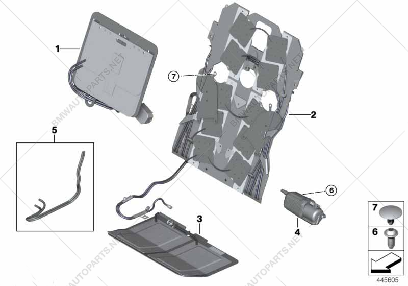

Guys, forgive me for asking, just to understand what type of function you activated in the seat by installing only the button with the massage function? I ask because I would be interested and my car has ventilated comfort seats, but from what I see in Realoem, to have the massage function the seats must have (in addition to the lumbar support with pump, no. 1) the air pump (no. 4 OEM 52107357427), the pneumatic mat (no. 2 OEM 52105A1A503), the active seat support cushion (no. 3 OEM 52107368557) and the air hoses (no. 5 OEM 52209169270). Obviously, apart from no. 1, the rest can only be found in seats with the factory-installed massage option, otherwise they are not there.
