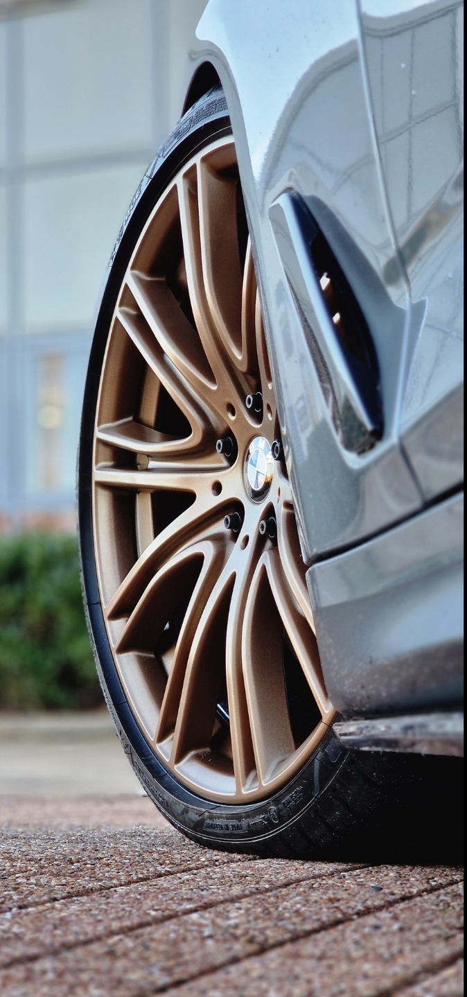

Fitted the 759i's last weekend -
Think I made the right choice by going with a satin finish!
