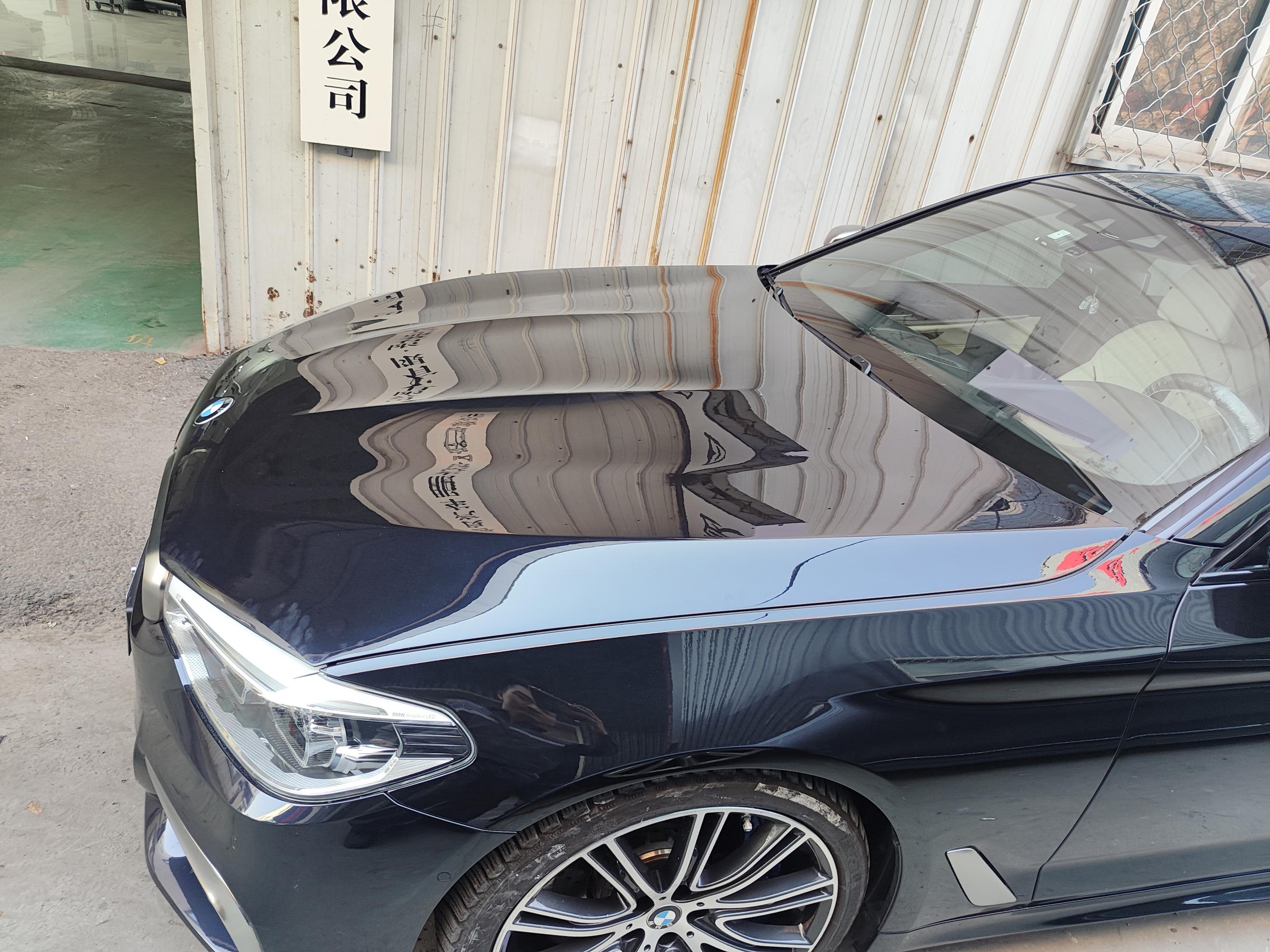

F90 hood on g30 stock fenders aftermarket lights and bumper

Is it my imagination or parallax, but the hood looks misaligned to me.
