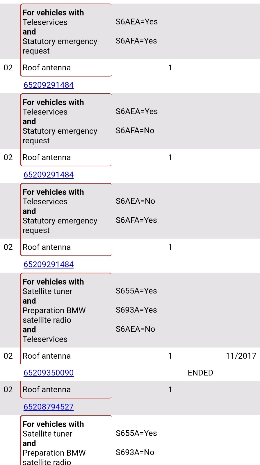

My 2018 X3 M40i (G01) started losing position a week ago and I thought it was just an accuracy problem. Kept putting me just off the motorway, the way it runs for a few seconds when you ignore a motorway exit.
Today it got worse and finally failed. Got directional orientation OK but location is now stuck at 100 miles away.
I've just gone into the Service Menu and got "GPS Status: Check Antenna" too.

I've had a look at replacement parts and can't find a definitive part code but it looks like the G range (G01 - X3, G30 - 5 series) all use the same electronics platform for comms and nav. Pricing from ebay seems to be around £65 for reclaimed units but not had a chance to get a dealer supply and fit price yet.
I just checked and the X3 is not listed down for the part I fitted. It has a different part number. The dealer should be able to advise which one you need... It depends on the options/spec you have that will determine which part number you need for the antenna. Have a look on realoem.com - that should be helpful and you might be able to work it out from there.
These are a few of the antenna part numbers listed for an X3 G01...
65209291484
65208794527
65208795961
65208795963
If it were me, I'd just buy a new one rather than a reconditioned one... just for piece of mind and less hassle if it turns out to be faulty or goes wrong in a few months or so.

Thanks, I’d read a post referencing the realoem site. I’ll need to dig out my original order to work out the options.
It’s in for a brake fluid change next week so may just end up with the “just fix it” conversation 😂
Would you mind sharing what the two parts you fitted cost?

I paid £132.76 for both parts. I fitted them myself

For the antenna replacement, did you need to remove the shark fin from the top or were you able to install the module from inside?

Yes, the shark fin cover needs to come off. The Telecoms box behind the headliner needs to be disconnected from the antenna. The Antenna is screwed in from the top.
