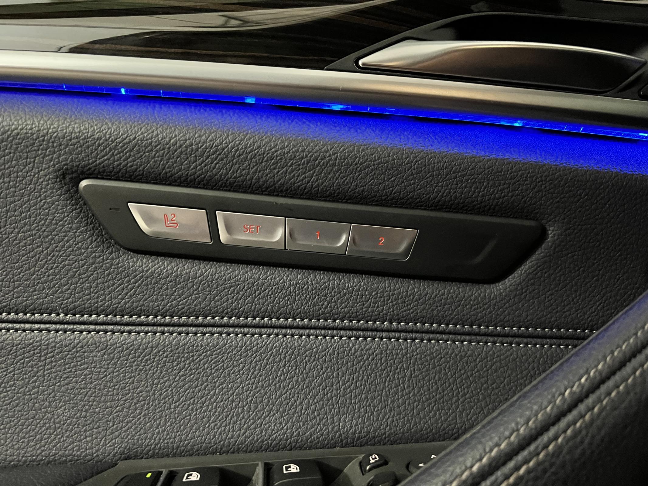

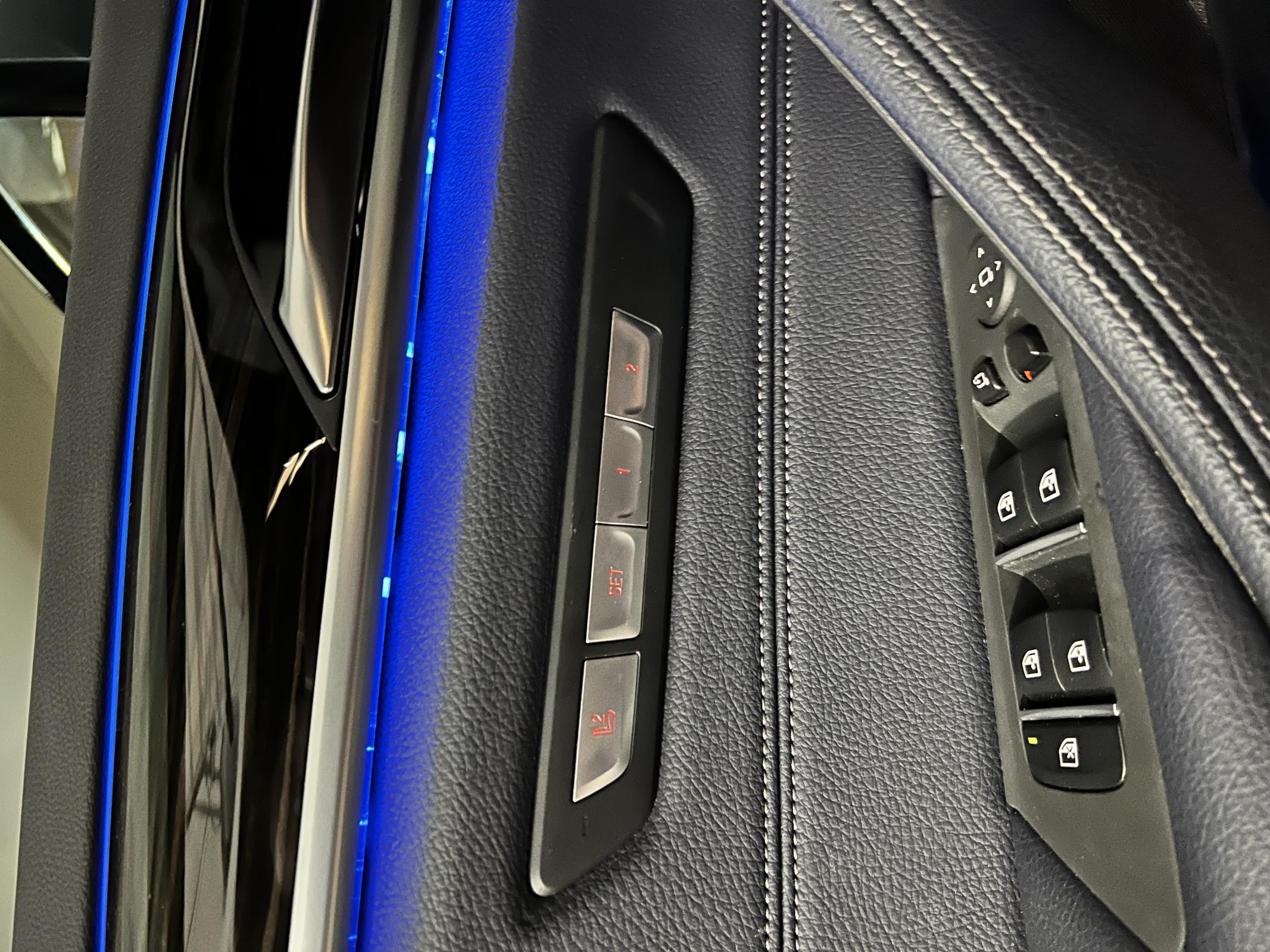

Thanks. Do you have a picture of your switch installed? Love to see these chrome buttons and the fitment.
      08-15-2022, 03:49 PM   #60
ezaircon4jc
ezaircon4jc's Avatar
6324
6,097
Drives: 2019 540i M Sport
Just took a couple and was going to edit my post
I guess maybe it is a little smaller. I never noticed...
