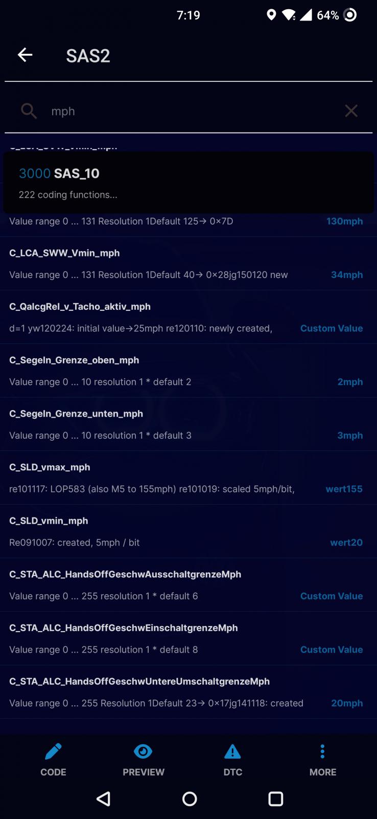

From my BimmerUtility

Thanks Raslin777, I think I found it. In ProTool, open the "Special Equipment" module, select "Expert," and then "3000 SAS 10." From there, search for "c_sta_alc_handsoff" and you should find the values. Look closely because many are similar.
Note that there is also a typo in Post #47 above; the correct spelling is:
  • C_STA_ALC_HandsOffGeschwAusschaltgrenzeMph
  • C_STA_ALC_HandsOffGeschwEinsschaltgrenzeMPh
I changed mine to 91 and 92 respectively since I'm not sure if they are decimal or hexadecimal values. I'll have to test it later, probably tomorrow.

I had a chance to test my coding change today. Specifically, I coded the values 91 and 92 into C_STA_ALC_HandsOffGeschwAusschaltgrenzeMph and
C_STA_ALC_HandsOffGeschwEinsschaltgrenzeMPh. I didn't make any other changes. For reference, I have a 2020 model, which is pre-LCI with iDrive 7 Lite. I had previously coded in lane change assist.
Driving on the highway at 70 mph, the current change seems to have worked in that it doesn't keep bugging me to put my hand on the wheel. However, it seems to have broken lane-change assist. As soon as I activate the turn signal to change lanes, it yells at me to put my hand on the steering wheel and doesn't change lanes. I will have to keep playing with this to better tell what's going on, but it may ultimately come down to a choice of whether I prefer annoyance-free driving or keeping lane change assist.
Any advice on this is most welcome!
