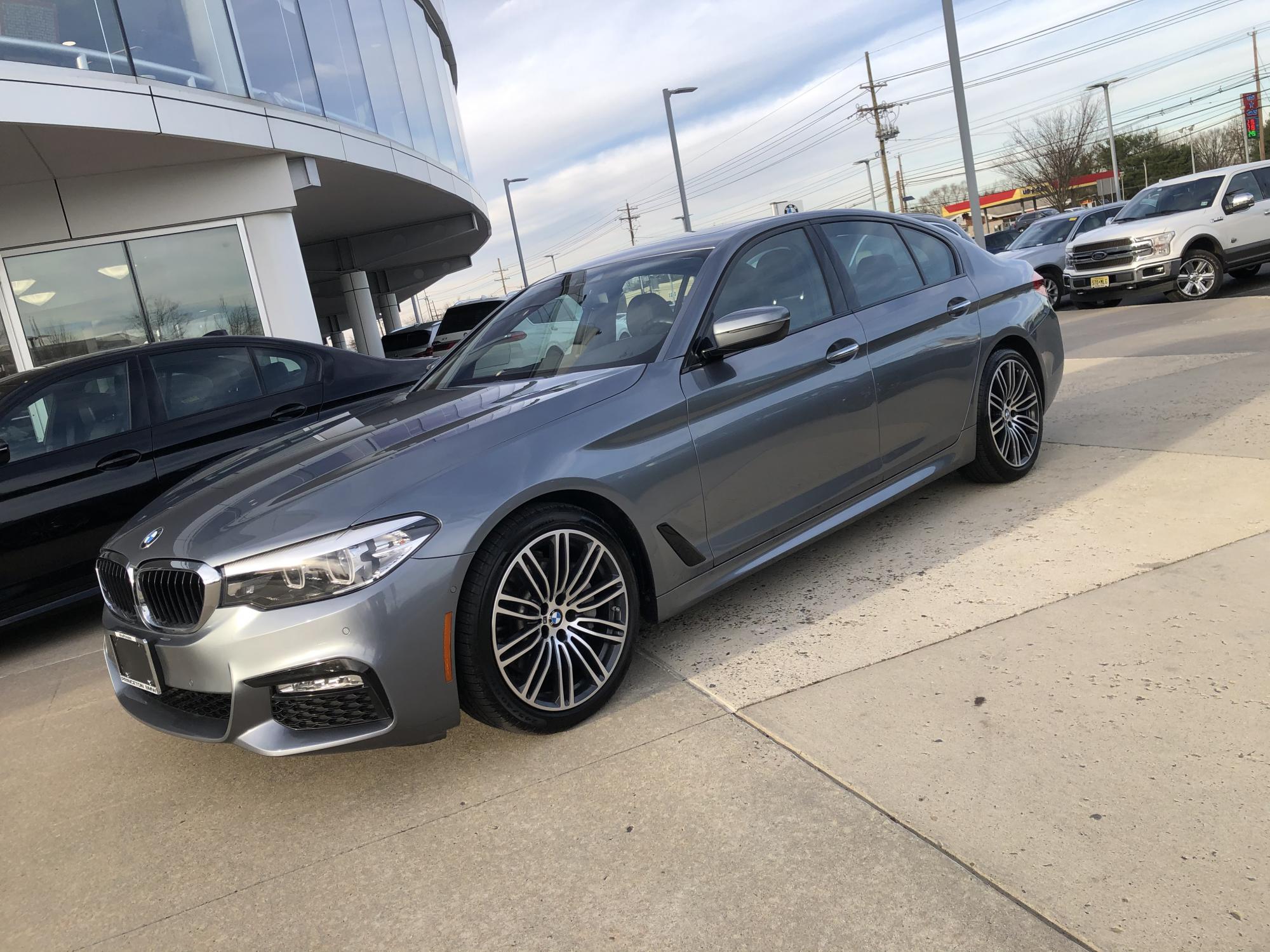

Drives: 540i XDrive
Location: Mount Laurel, NJ
Just picked it up last night. It’s my wife’s new daily driver. Same color combo as yours. I’m keeping an eye on this and have subscribed.
Thanks Bud!
Changes due soon:
- MSS Adjustable Springs next week
- Set of Michelin PS4S tyres ordered
- Possibly a new set of wheels (my passenger side front and rear alloys have a slight buckle in them after hitting a huge pothole at 60+ mph) I took them to get straighten but there is still a slight wobble with them both at 70+mph. Not really driven the car much recently so haven't bothered in getting them replaced.
- Gloss black M Performance Pro style spoiler has been ordered and waiting for it to be delivered
- Larger steering wheel paddles have been ordered but not yet fitted
Looking forward to seeing pictures of yours. What's your plans to do with it?

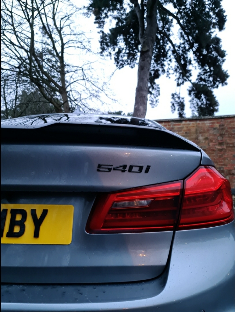

Spoiler... (Part 1)
Remove - M Sport Lip Spoiler, Bluestone Metallic
Install - M Performance Pro Style, Gloss Black
The next modification on the list for the car was the spoiler. I felt the car needed a spoiler with a bit more presence and one that stood out.
I saw that BMW did what they call the M Performance Pro spoiler for the M5 in Carbon. This carries a price tag of around £700+.
I love the look of this spoiler and the way it sits on the end of the boot lid. My search led me to find a few 'aftermarket' options but were only available in carbon. I contacted quite a few online sellers to see if they did a Gloss Black option but surprisingly, not many seem to do them. Eventually, I was able to find a company who were willing to do a custom order for me on this spoiler in Gloss Black. Fast forward 2 months and the spoiler finally arrived this weekend!
As much as I was excited to have found the spoiler I wanted and in the finish I wanted - I was a little apprehensive about the removal of the spoiler that was on the car. With the car being 2.5 years old - that meant the OEM spoiler was on there for the same amount of time and the 'glue' holding it to the car was quite well settled (if that makes sense).
I have seen many posts online where people have removed factory fitted OEM spoilers and found that betalink adhesive has been used or they have been unable to remove the double sided tape without any issues.
With this in the back of my mind and the rain just starting, I pressed on with the removal and hoped for the best. Firstly I used a heat gun set on the lower setting and 'warmed up' the spoiler. The aim here was to soften up the adhesive. I then applied some Gtechniq Tar and Glue Remover. Starting at one end, I used some dental floss to cut away at the adhesive - to my delight, double sided tape had been used. It took quite a while to cut through the tape as the dental floss has the tendency to break easily.
With the spoiler finally removed, it left behind alot of tape still stuck to the car. I soaked this in the glue remover and applied some more heat but switched to a hair dryer instead. The trick I found here is that if you heat and roll the tape in one direction, it comes of quite easily. Once all the tape was removed, I applied some Meguairs Compound to where the spoiler sat and was able to smooth out anything that was left behind.
To install the new spoiler to the car, I opted not to use double sided tape and use the adhesive option. As the spoiler sits on the end of the boot lid instead of on top of it - I felt this was the better option to secure it on.
As shown in the pictures below, It's been set in place and held with lots of masking tape to ensure its gets a good solid contact to the car.
Plan is to remove the tape at some point tomorrow morning and clean of any residue.
Few pictures below of the various steps involved. I don't usually ramble on in detail about the various modifications that I do - however I felt this one required a bit more thought and effort in the process, more so than normal.

Spoiler - (Part 2)
Tape all removed, compound and glue remover used to remove the residue. Polished and waxed.
I think this spoiler looks so much better! Really happy with the look and the fitment.
I didn't say what adhesive I used before. I was looking at getting the Betalink kit, but came across the Evostik Adhesive pictured below! Sets in 15 mins and fully cures in 24 hours. I left it for 2 days due to the cold weather conditions. The adhesive does say it can be used in any conditions and even when the surfaces are wet.
Few pictures taken last night...

The diffuser is an aftermarket M Performance one in Gloss Black. I Still have the bottom piece to go on. I will do this once I have the backbox modified in January to make some more noise.
The exhaust is the stock one that came with the car. I spray painted the tips gloss black. Looked at getting the OEM black ones, but the £102 each price put me off!
Spray paint cost £30 delivered. Used Foliatec which includes the Primer, spray, laquer and hardner all in one. Left to cure for 7 days.

Diffuser and Exhaust
Originally Posted by Apl330d View Post
Hi
Your exhaust and splitter look great.
can you tell me what items they are?
Is your exhaust a full system, or have you just changed the tail pipes?
Thanks
Antony
Hi mate,
Apologies for delayed response. so the Diffuser is from :
https://www.xenonz.co.uk/store/p1422...-diffuser.html
Exhaust is a Custom made valvetronic Axle back system with 3.5" Akrapovic tail pipes. Check here :-) Put a headset on to get a better feel of the sound in the end.

So contacted the same seller on Ebay as you recommended for splitter and have sent 'em £100 for the gloss black one
In terms of your exhaust modification, I know you have waited enough already but my PCW modified backbox with original tailpipes and flap control is up for sale which is a straight weld on the mid-pipe. so if you want to keep both i.e., your existing one as a spare and PCW modified one on the car then give me a shout. I am at the point of no return with the custom exhaust so cant go back to OEM look/sound anyway. check the listing :
