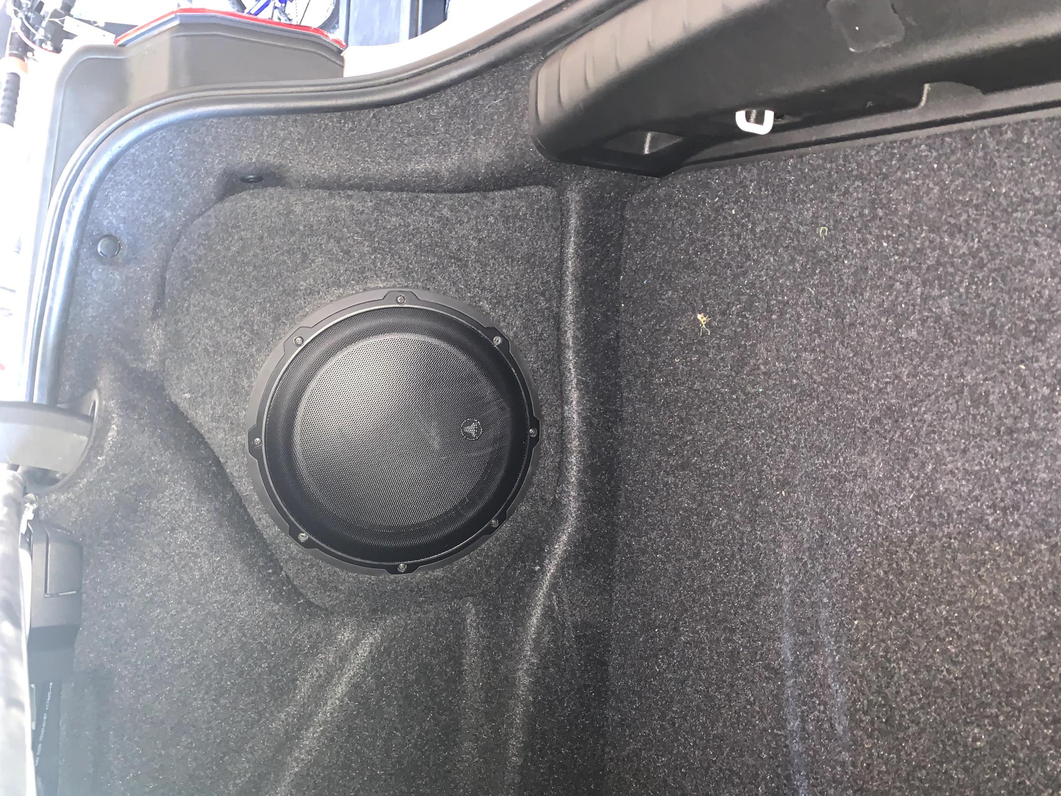

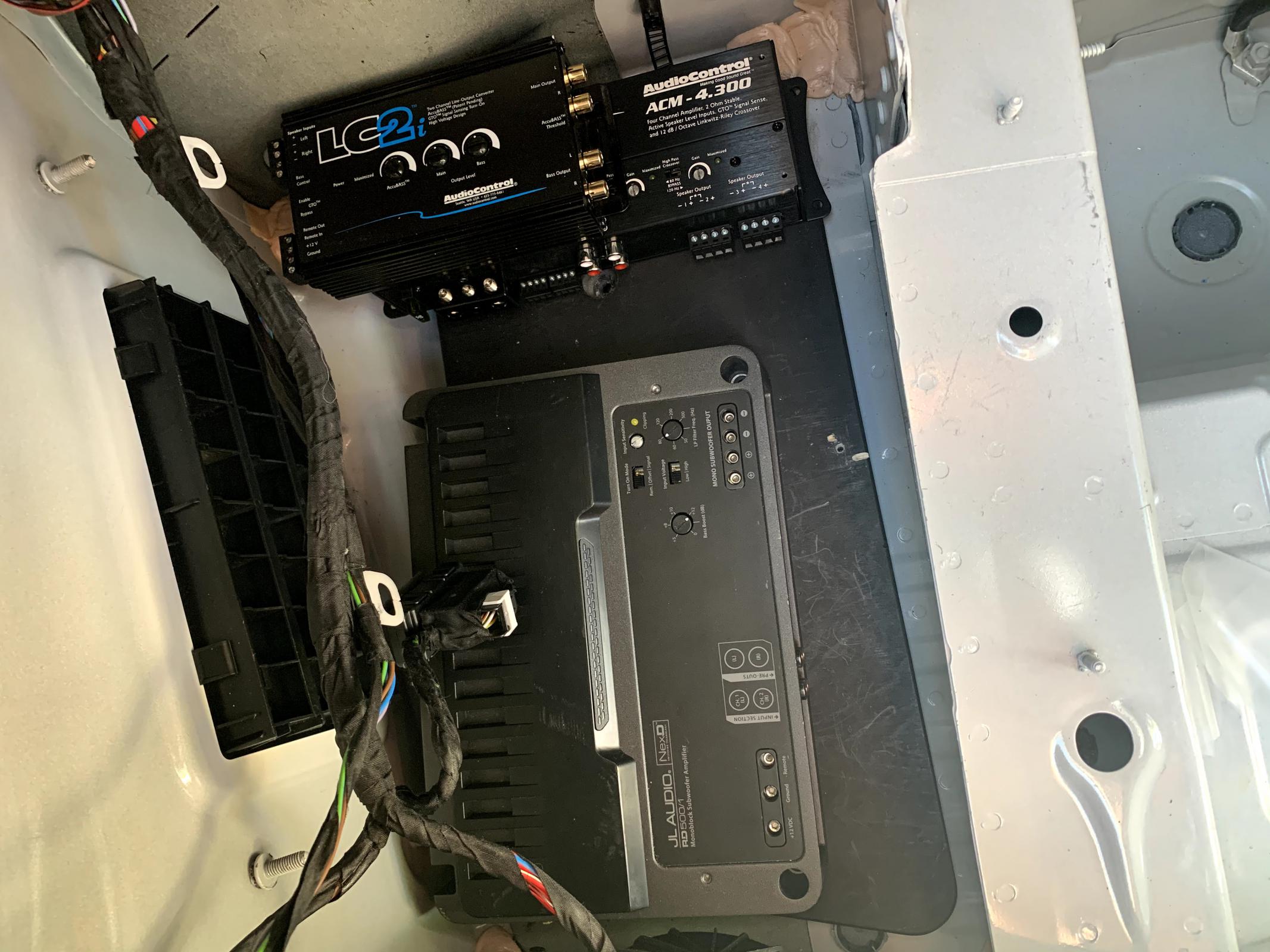

Sub: JL 10w3v3-2
Amp: JL Audio RD500/1
Enclosure: IMG]https://www.ebay.com/itm/152925739541?hash=item239b159a15:g:Vn0AAOSwH~palpo J[/IMG]
He fabricated one for my G30. Turned out perfect!

I used the technic harness to add a trunk sub. I put the sub amp under the sub
