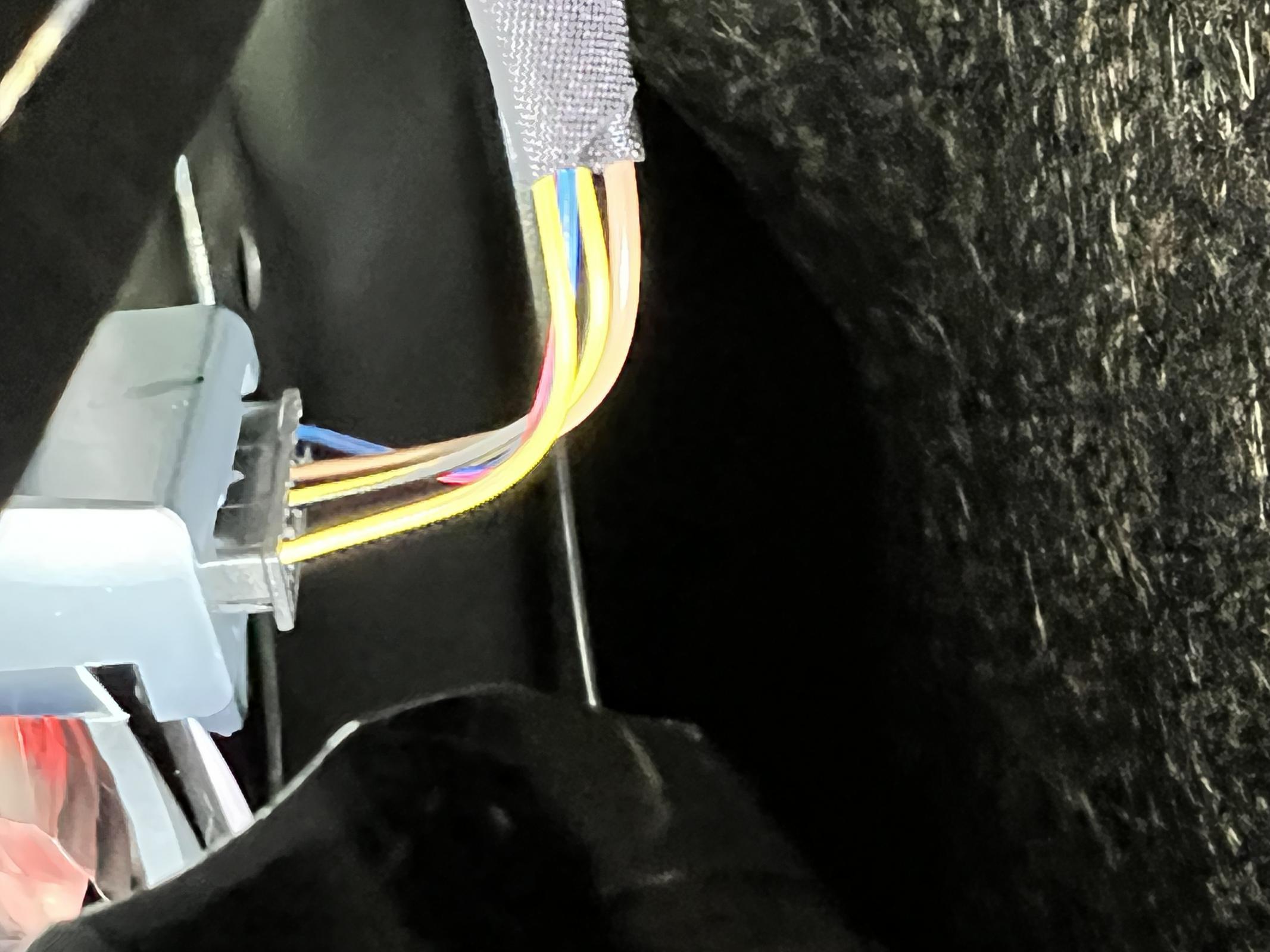

My lucky day. I've got the rear fog wires! All six pins full. Pin 1 is the fogs. Black yellow, Black white.

For those of you who only have one light that comes on, is that because you only have one physical light set in one side, or do you have both but only one works? I have both LEDs, but only the left side works and after coding I'm at a loss as to why.
For those of you who have them, when you press the brakes does the inner set of brake lights on the trunk still come on? With my LCI lights, when I press the brakes the inner brake lights don't come on but all the rest do. No errors were displayed or anything. Normally when I press the brakes with the fog lights off, the inner and outer lights come on. Wondering if that is intended with the rear fogs or not. I also thought that maybe because the inner brake lights don't come on with pre-LCI, but since the inner and outers work with the fog lights off I wasn't sure.
Pic is from when I wired them up wrong at first during install so I know they are both there.

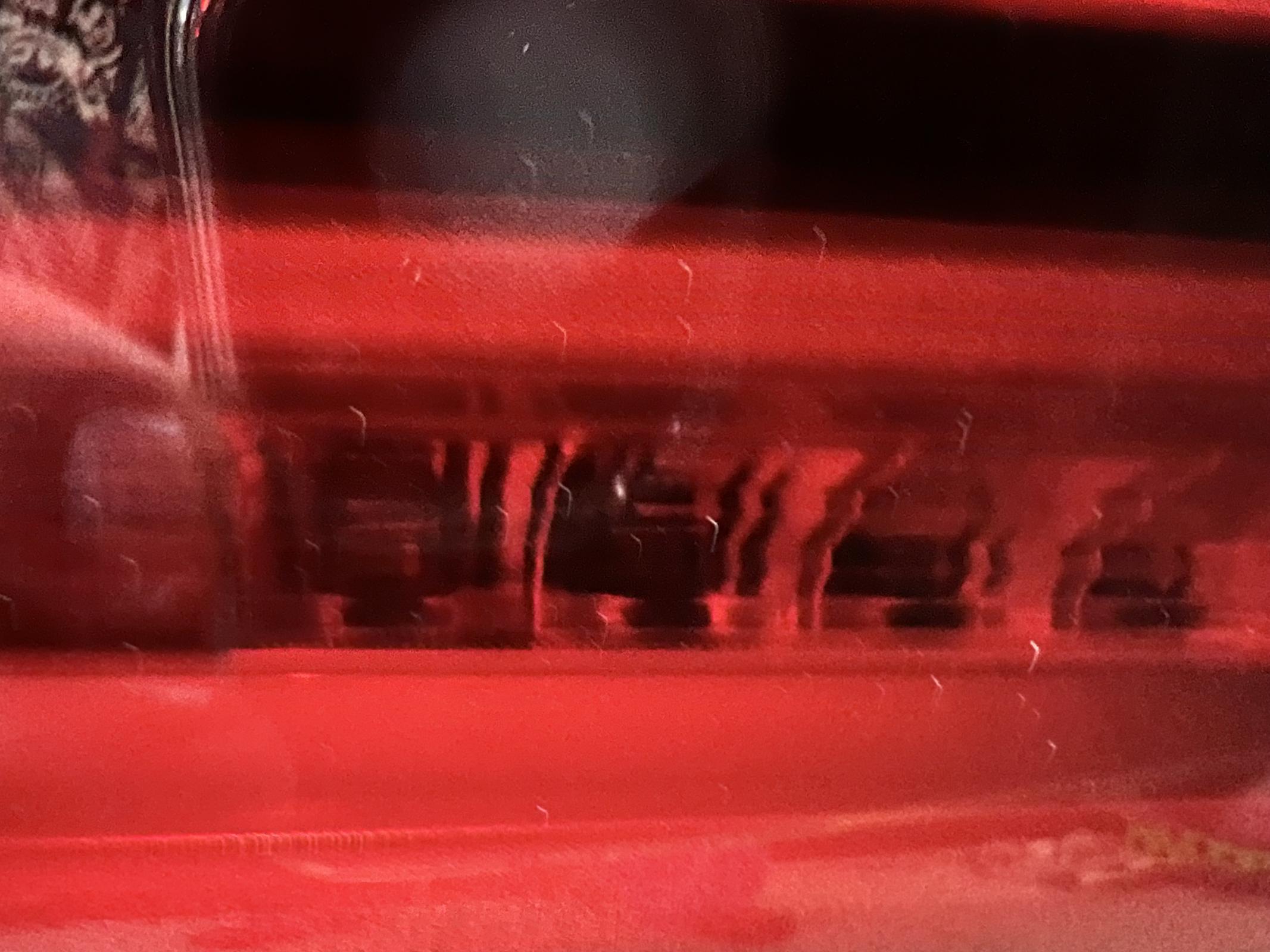

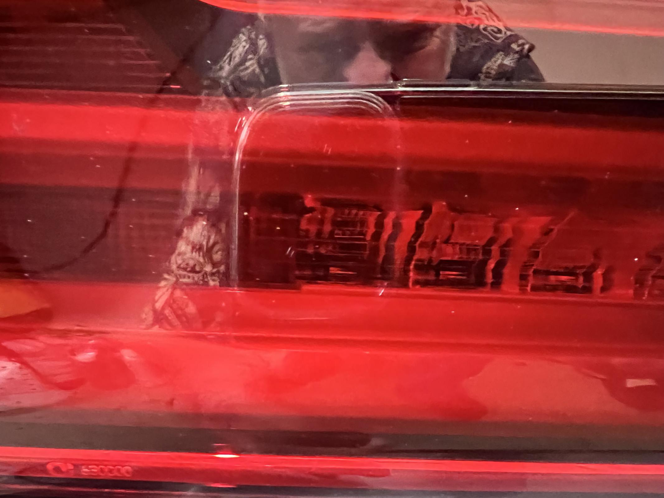

Another question. I can't tell if the diodes are there or not. Can someone with better eyesight tell if they're there or not?
TIA
Name:  2019 tail lights.jpg
Name:  2019 tailights.jpg
Name:  2019 tails.jpg
TIA
Attachment 2814514
Attachment 2814515
Attachment 2814516
Sorry bud, it doesn’t look like the LEDs are in there.

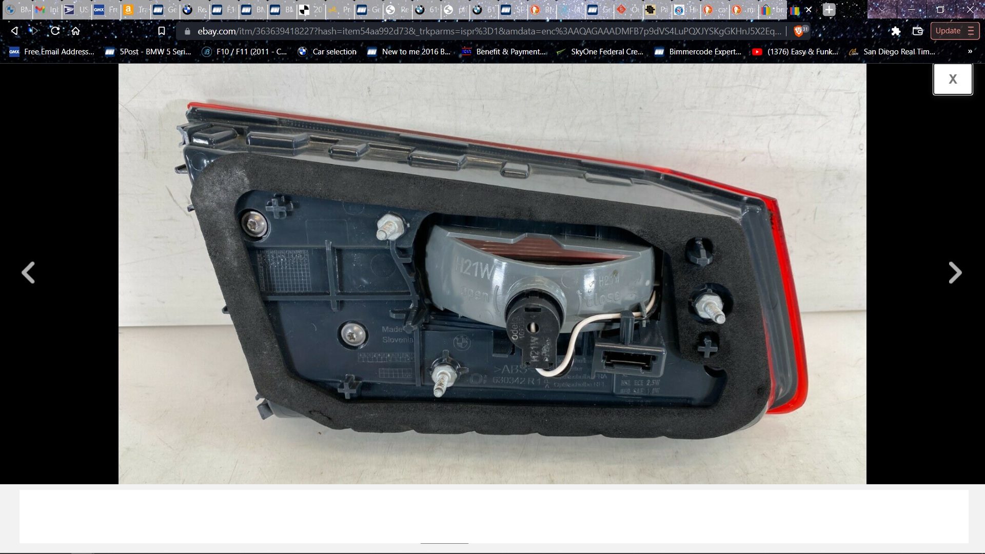

Are these OEM lights?
      02-17-2022, 06:52 PM   #61
ezaircon4jc
ezaircon4jc's Avatar
6316
6,097
Drives: 2019 540i M Sport
Yup...

6,097
I made a mistake... I was looking at the outer light and not the inner.
Here is the correct plug. I still have only 4 wires...
Name:  ineer trunk 2.jpg
Name:  inner trunk.jpg
Attachment 2815452
Attachment 2815453
Then your car isn't wired for rear fogs. It doesn't matter if the lights have the diodes or not and the switch won't work.
Thanks for the bad news, I think...
Anyone want to buy a rear fog light for $80 shipped to the lower 48? I'm not looking to make any $$ on this.
If it's any consolation, I have them on my Euro LCI's. I had the 5th wire and I bought the switch from Latvia like you probably did for $80 bucks and I never use the rear fogs. I knew I wouldn't, but I have the functionality and I had the wire so I figured I'd get the switch. Not sure where you live, but it's foggy like once a year here and I still don't think I need the fog for people to see me.
I wouldn't sweat it.
