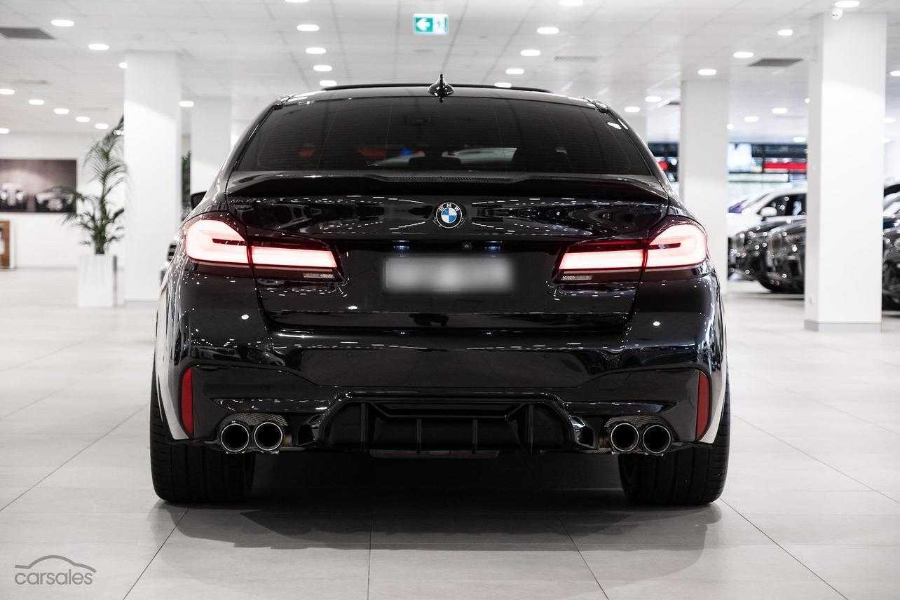

Did mine with few mods, looks awesome
IPE exhaust
high flow cat
metal charge pipe
and all M sport cosmetic mods.
Also did Crystal Gear level inside
late 2020 530i. done with BM3 stage 2 91 tune. adding in 98. as in Aus that is what works. 91 seems to be equal to 95-96. No issues, car is smooth. Have not tested but would be around 290-300 whp.

Also, Did H&R lowering springs and m performance grill.

Love the exhaust. I went to the M-Performance and I regret it. I am looking at the Valtronic, and I am looking forward to speaking with them when I go to Bimmer Invasion next month.

Nice, Do post the pics once you get done. Also does some one have any idea about below ?
