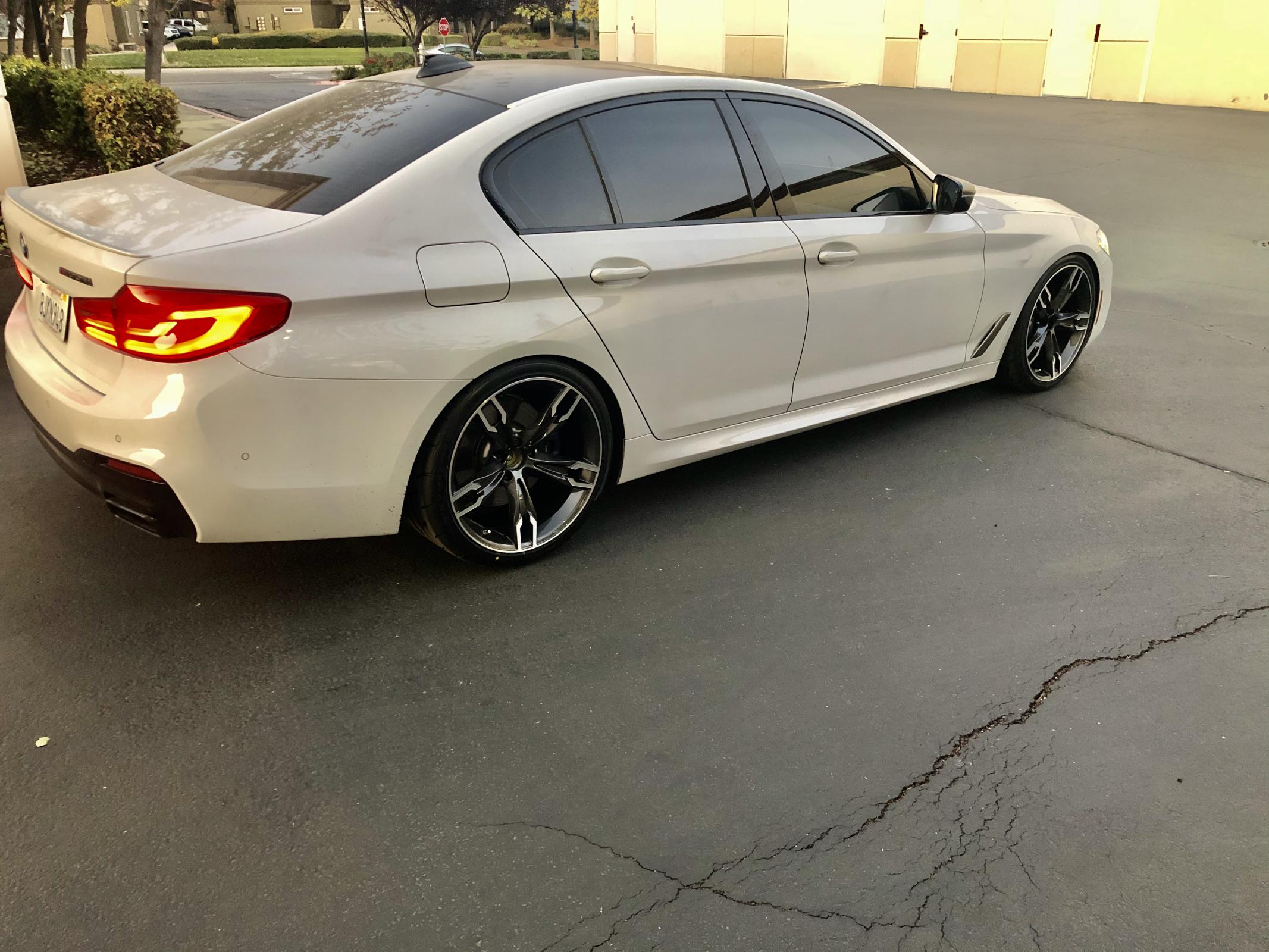

Originally Posted by deepat04 View Post
I did go 295 fit no issues.
This is the size to go with IMO
Here are pictures without my floating OEM caps.
Attachment 2209555
Attachment 2209556
Are you lowered with coilovers or springs only?

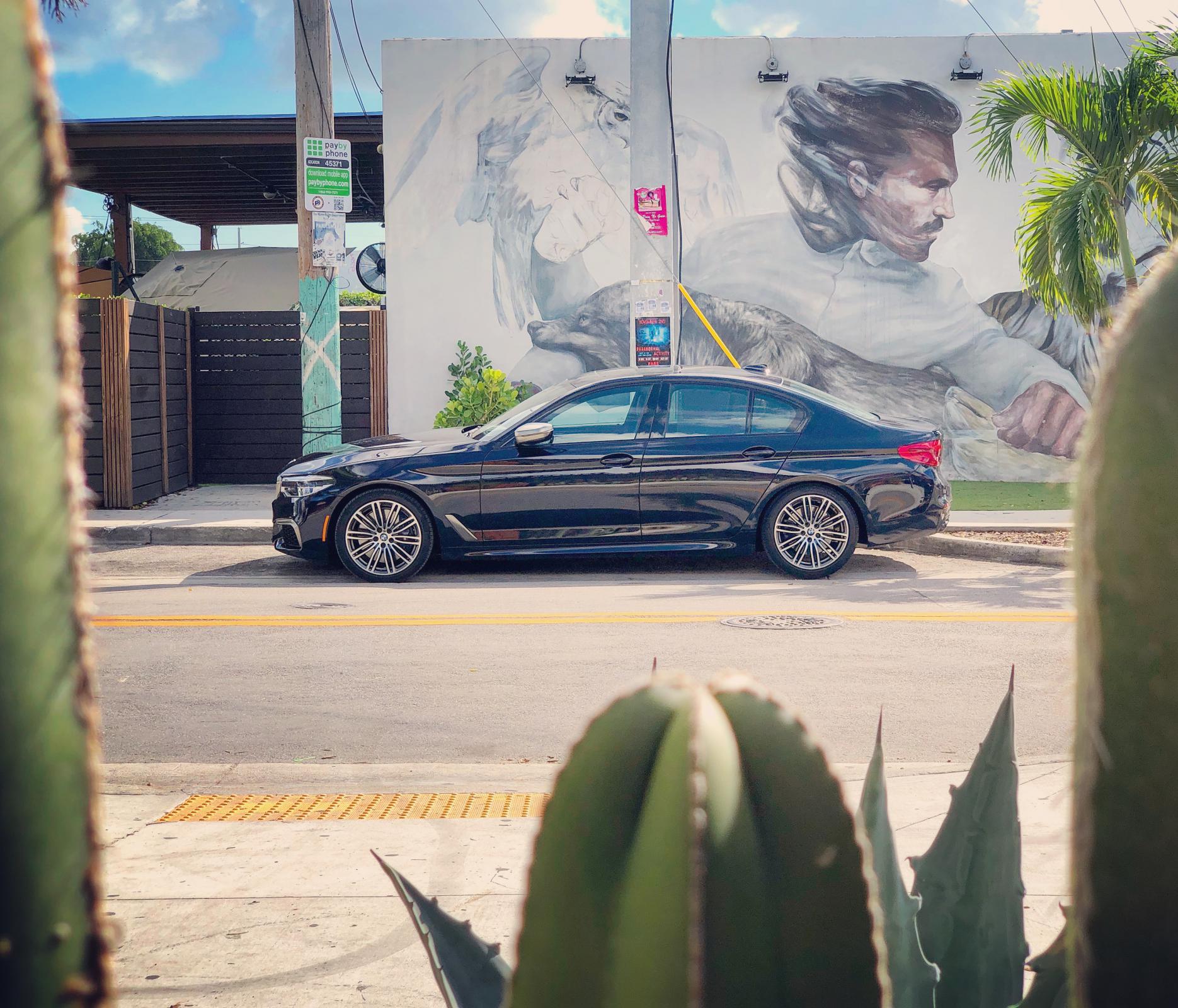

Originally Posted by TexasM550i View Post
On my M550i I'm running 20×10.5 in the rear and 20×9 In the front with 275/35R20 and 305/30R20's. I had the 285's and 290's, but liked the look and ride with the these the best. No rubbing issues.
Please let me know if you can, where you purchased wheels. From what I see, the fronts are 8.5 and not sure if a 275 will fit.
      02-03-2020, 06:17 PM   #28
TexasM550i
TexasM550i's Avatar
77
45
Drives: 2018 BMW M550i xdrive
Join Date: Jun 2017
Location: Houston
Yes, the 305's fit in the rear.
My wheels
BMW MSport Wheels 86281, 86285
20×10.5 R 20×9 F
Tires
Front 275/35R20
Rear 305/30/20
2018 M550i xdrive, DME Stage 2
My wheels
20×10.5 R 20×9 F
Tires
Front 275/35R20
Rear 305/30/20

I did 255 and 295 with the DHP. you can see pics here
https://g30.bimmerpost.com/forums/sh....php?t=1744728
The wheels are for sale to
