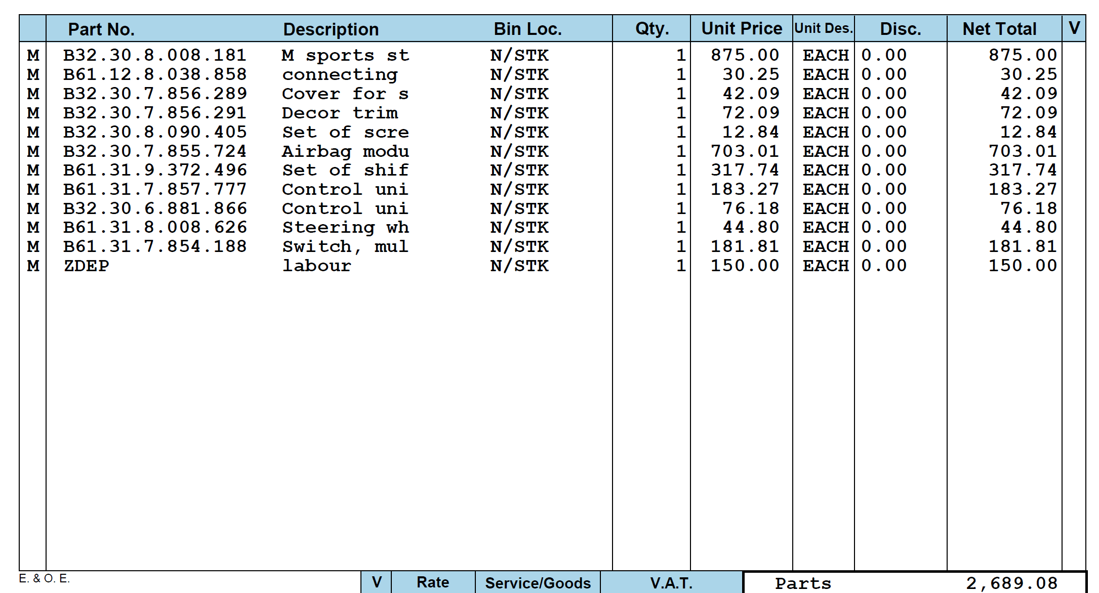

The replacement was like for like with the same options.
I looked back at my records and found the list my dealer emailed me, showing what they had to replace.
Not sure if it is true or not...……..but it is very expensive if it is the case!
clee1982797.50
