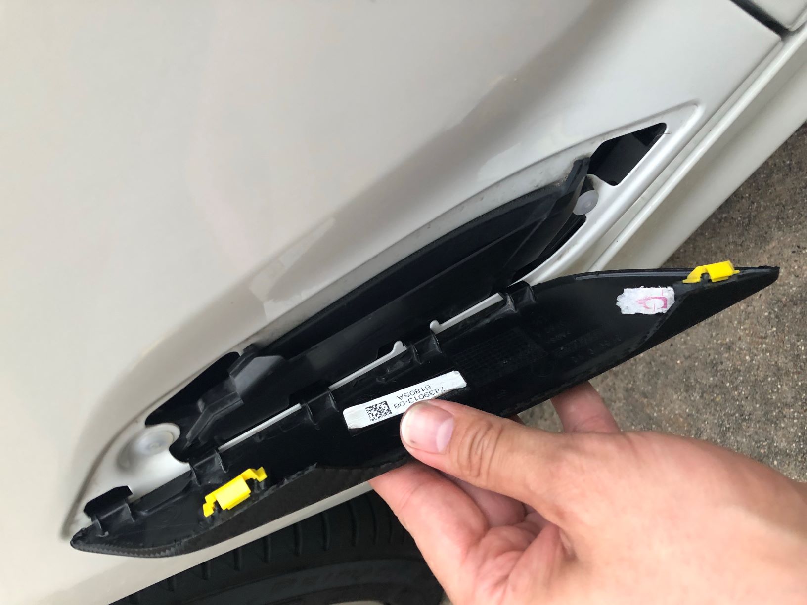

I used the pull method too. Here are some pics I took that make it easier to see. I wrapped mine in carbon fiber vinyl, but may just end up buying the real deal.

You literally pull from the top (opening of the vent) away from the car. The two yellow clips will likely fly off but not break.
I'm surprised so many are having trouble, I've never had a trim piece come off so easily.
