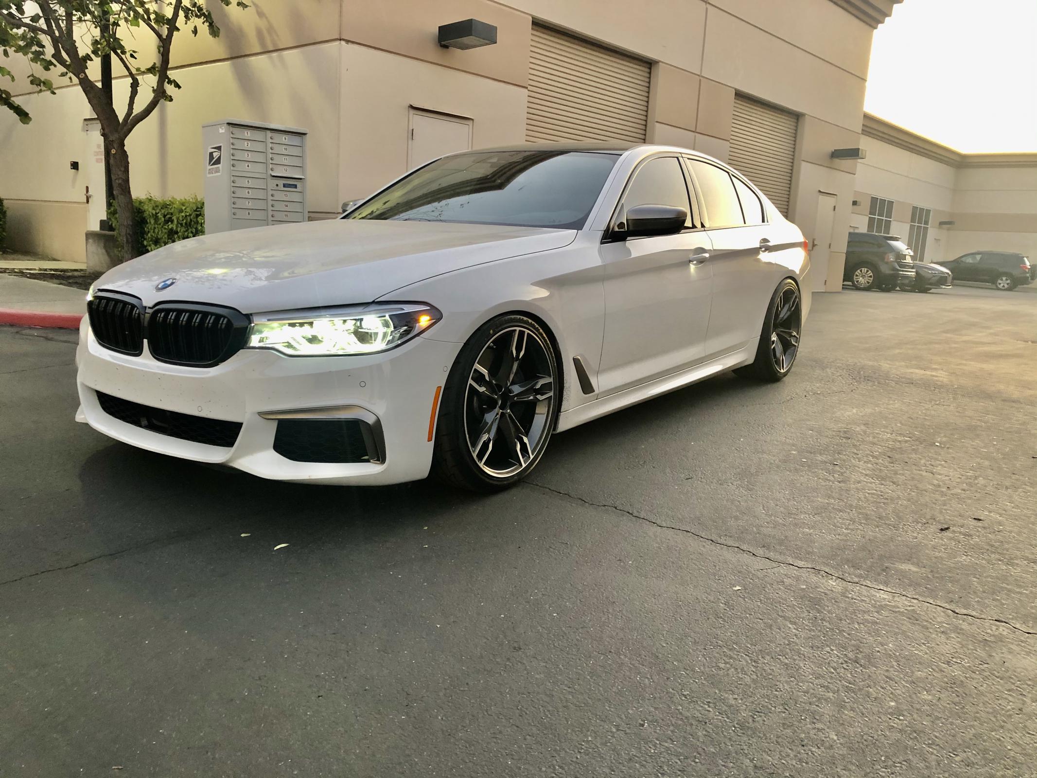

Put up pictures when you get them mounted!

Thanks for the response. Def will! Their a custom forged version of the OEM wheels with some changes, size offset, elected for a 3 inch concave stance in rear and went slightly darker on the color vs oem...waiting for them to arrive now!

I did go 295 fit no issues.
This is the size to go with IMO
Here are pictures without my floating OEM caps.
