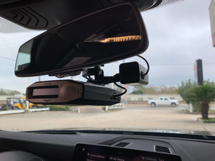

Just wanted to post to say many thanks for this writeup and info.
With the help of the info here, last night I installed a uniden R7 to the right of my rearview mirror. I ran the wire to the driver's side down the pillar so that I could have the smart wire box to quickly mute false readings.
I had to splice the included wire with a longer wire to bring it back to the right side to the fuse box per the instructions above. Worked like a charm.
Thanks again!!

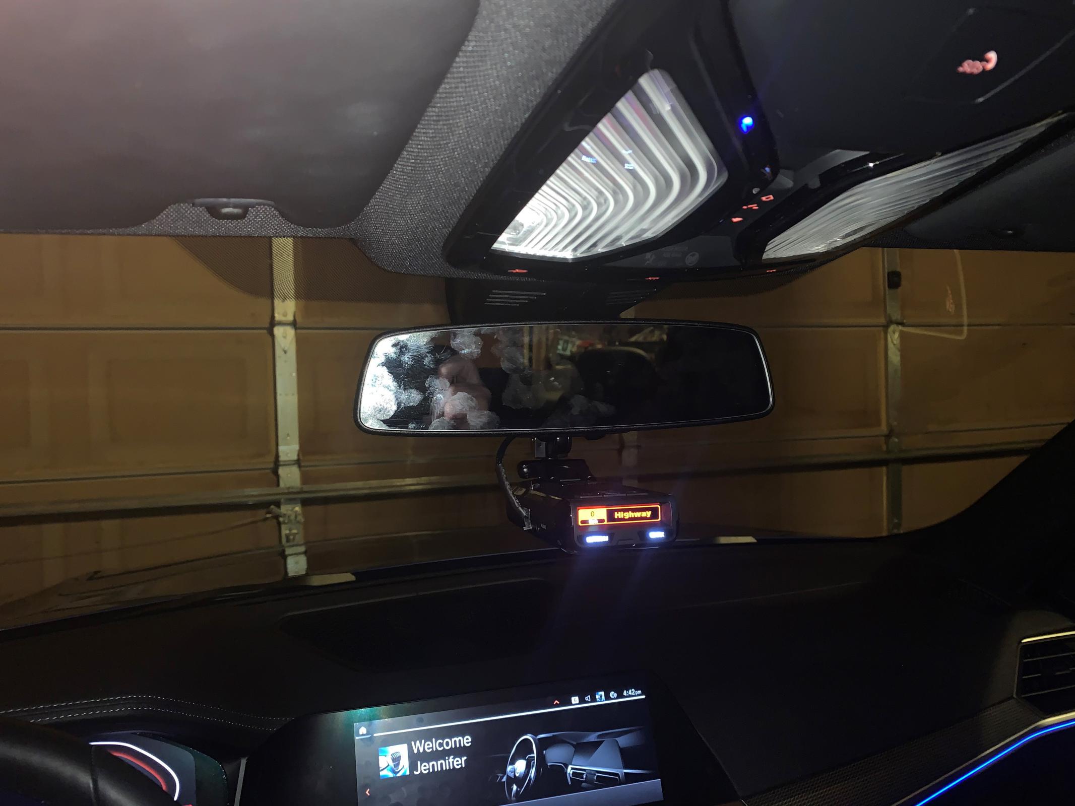

Hey Everyone!
FYI: I added the Escort ZW5 laser shifter with two additional rear sensors to my M550i yesterday. I already had the Max 360c hardwired to F50 which is the cigarette lighter circuit. Since the ZW5 requires it's own power cord to the Max 360c, I ran another direct wire kit to F59 for my M1 DashCam which previously powered the detector.
I can confirm the both F50 and F59 (unused switched) are both switched power and power down at the same time when the vehicle completes the shutdown cycle. The ZW5 power cable includes the wireless module which communicates wirelessly to the sensor box under the hood, so the dashcam had to be powered separately.

Mirrortap on M340i
Thank for this excellent write up. I just completed the install on my 2021 M340I XDrive. My advice based on what I read and doing it is this: Start at the lowest point when separating the plastic housing. Closest to the dash. It was the only place I could get a tool started. I broke no pieces doing it this way. I will include a few pictures and links to both the mirrortap and the inexpensive mount I bought
Mirror Mount
https://www.amazon.com/gp/product/B0...?ie=UTF8&psc=1
Mirrortap
PS. Wiring as shown in this post results in my detector shutting off in approx 5 minutes. Thank you all for the incredibly helpful post

I did mirror tap as well following the YouTube video. Was a bit of a pita to get the tap in, but I did it. Comes on when you unlock the car and turns off after you get out of the car.
