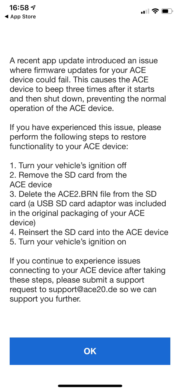

The iPhone ACE app (used for managing the dash cam settings, viewing footage etc) had a significant upgrade today.
It's now much better then it was, and seems to connect to the camera more reliably. A real benefit is that you can now rotate the iPhone to landscape mode to make the video much larger on the screen.
On first connection to the dash cam, it asked to upgrade the dash cam firmware. You have to leave the ignition on, and it will complete the upgrade in about 5 minutes.
I haven't been able to notice any difference yet, but it's good to see that the app is being updated.

BudgieUK, not sure if you heard of this but after the upgrade on the iPhone ACE 2 app which happend todayttoday the camera does not switch on anymore. I now get the power light coming and then 3 beeps, 3 times in quick succession and then the camera switches off. Any ideas?

BudgieUK, thanks for replay. Put it back in the BMW garage today and they said that when they checked it they found a broken wire. Not really convinced but they said they fixed it but surprise , surprise when I got the car back today it is even worse. Now the camera does not switch on and I do not get the message “Recording” anymore. When I took the SD card out it only has data in the Parking folder. There is nothing in Driving folder so I am back at the garage tomorrow and if they cannot fix it after 30 minutes I am going to instruct them to take the whole thing out and give me a refund. Also now when I drive I get three beeps every few minutes. Not sure what the heck is going on. Will let everybody know.

BudgieUK, thanks for replay. Put it back in the BMW garage today and they said that when they checked it they found a broken wire. Not really convinced but they said they fixed it but surprise , surprise when I got the car back today it is even worse. Now the camera does not switch on and I do not get the message "Recording" anymore. When I took the SD card out it only has data in the Parking folder. There is nothing in Driving folder so I am back at the garage tomorrow and if they cannot fix it after 30 minutes I am going to instruct them to take the whole thing out and give me a refund. Also now when I drive I get three beeps every few minutes. Not sure what the heck is going on. Will let everybody know.
You may want to try contacting the support email address?
They are not quick at responding, but may be worth a go ...
I sent an email to support@ace20.de, and got a reply from ace20-support@bmwgroup.com

Have you seen the latest app update?
It seems the firmware update has caused a few problems, and they have posted a possible solution
