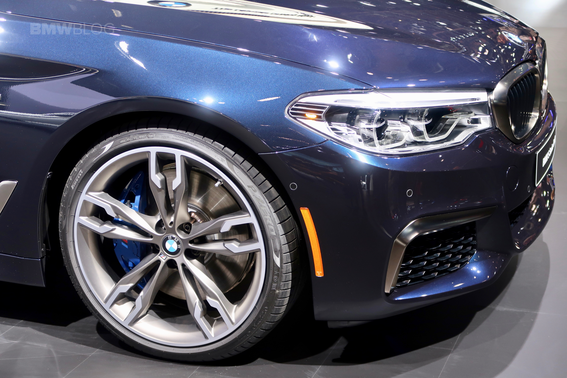

I was looking at the M sport brakes (blue) on the M550i and the M performance brakes red).
I notice the calipers looks to be the same just different colors. But I assume the M sport brakes are 374 mm for the M550i as it is for the 540i, but the M performance brakes are 395 mm.
So how can the same caliper fit different sized rotors?

I just thought the M550i looked slightly smaller than the M performance brakes, and 19" was also standard on the f10/11 M550d, but it could still fit 18" winters.
I don't know if this is still the case with the new M550i, or if BMW really has gone for 19" as minimum wheels size.
Here's the 540i M sport with 374 mm brakes, but it's hard to see if it's the same as the M550i because of all the spokes.
Will have to wait for it to appear on the parts system before we can confirm.
