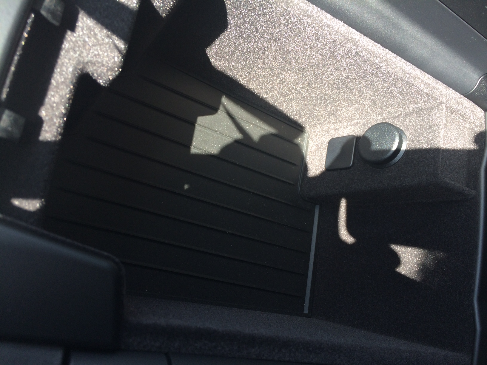

Does the arm rest have a 12v plug in it, or is that a dummy plug?

I beleive you get 1 usb ahewad of the cupholders and if you order enhanced bluetooth, another one in the centre armrest along with of course wireless charging.
For me it was standard, the second USB in the armrest is 'missing'

Actually, no you don't need the 12v option!
For G30, "additional 12v socket" option brings you two extra 12v sockets, one for rear seats and other in the trunk. It also includes one 12v to USB adapter cable.
"Enhanced bluetooth" and "wireless charging bluetooth" options both include the second USB in the center arm rest. Standard USB socket is next to the cupholders in the front.
