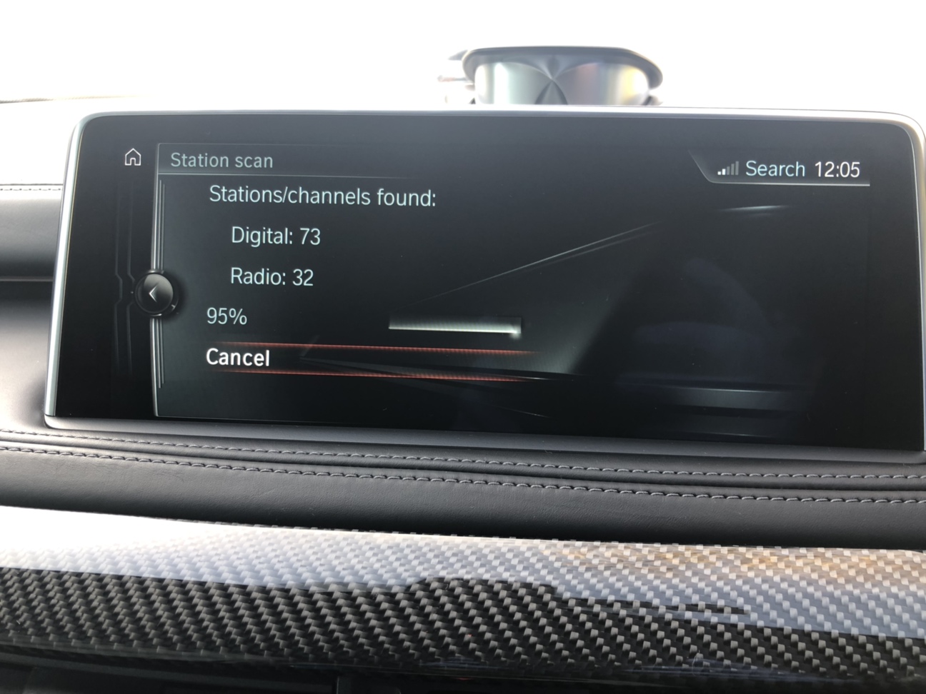

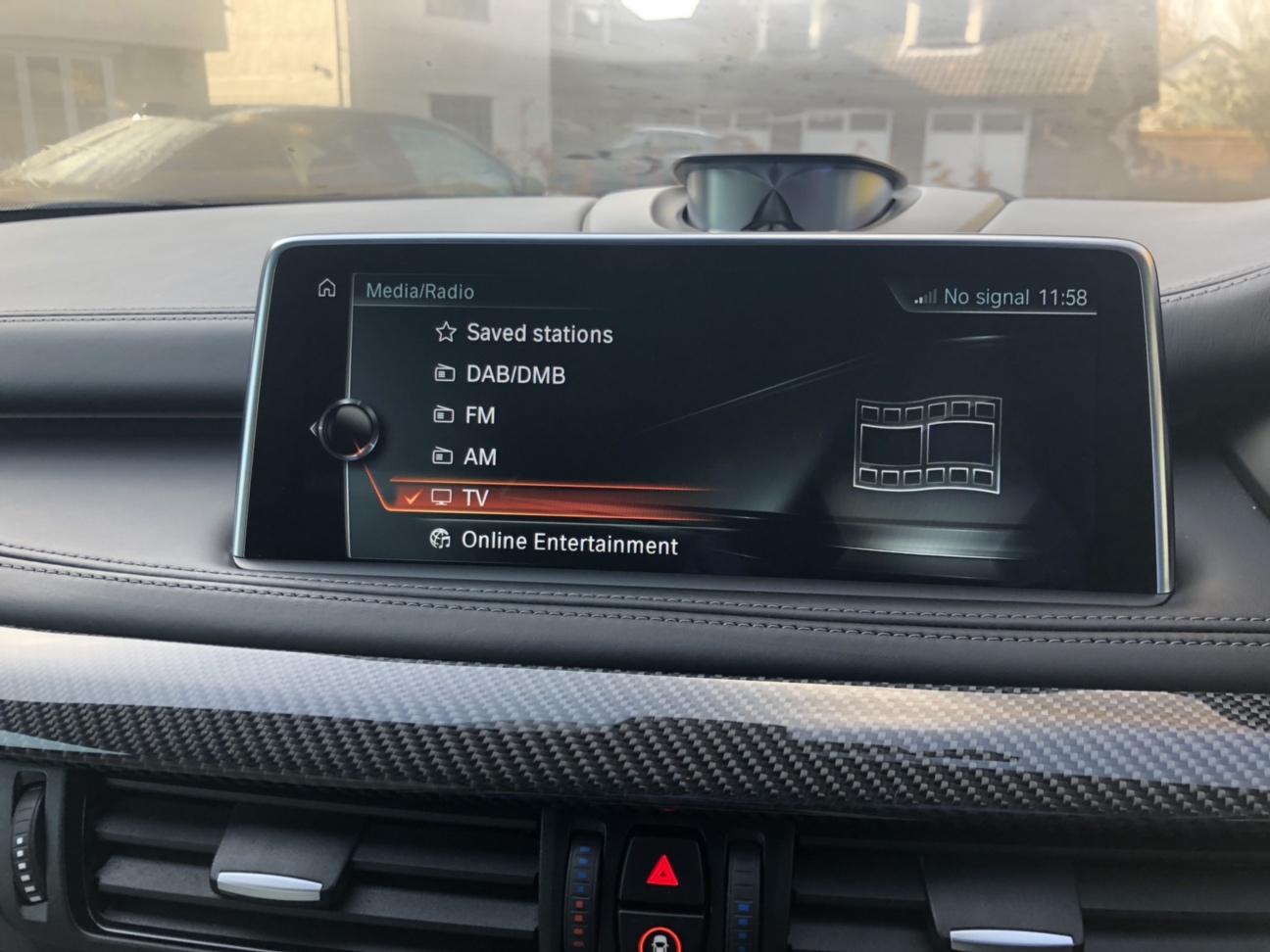

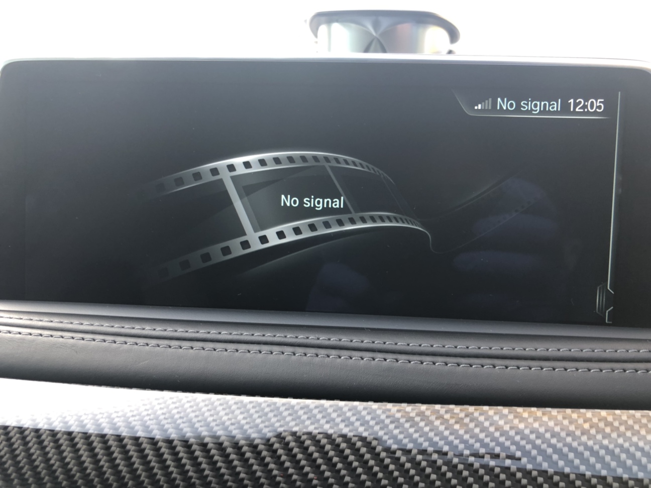

I have the same issue as the majority of you. TV showing no signal. It finds stations all fine, and then once it completes it just pops back to no signal.
I have tried resetting the tv/video module by using ista+ and tested a number of other features. I think it must be firmware.

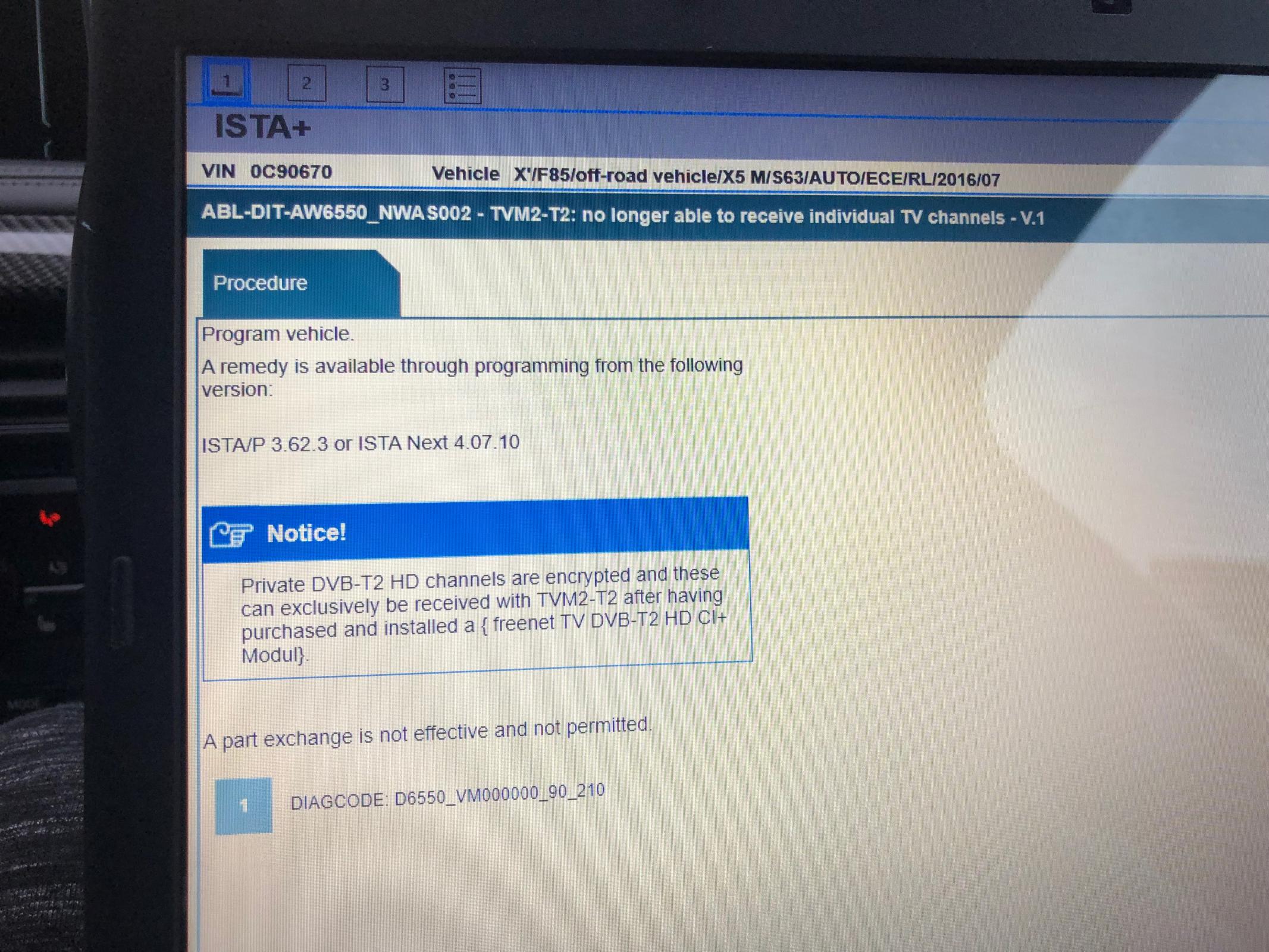

I also did find a noted issue in ista+ as per attached which i think may be related?

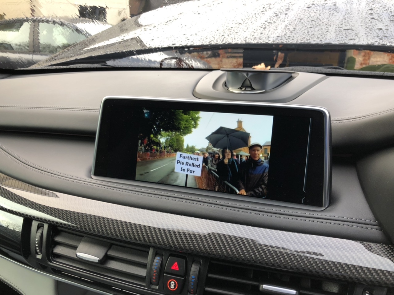

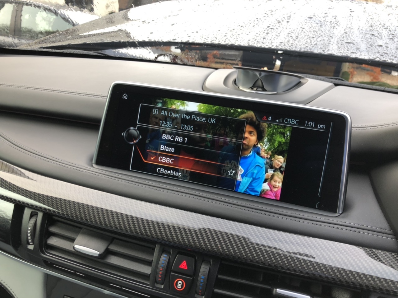

Ok so I solved the issue. I updated the tv video module firmware with esys now everything is working perfectly will update some photos shortly 👍
clee1982793.00
      12-01-2019, 06:26 AM   #19
m5_2000
10
Drives: M5 F10
Join Date: Feb 2014
Location: London
Photos
clee1982793.00
      12-01-2019, 07:05 AM   #20
m5_2000
10
Drives: M5 F10
Join Date: Feb 2014
Location: London
Photos
clee1982793.00
