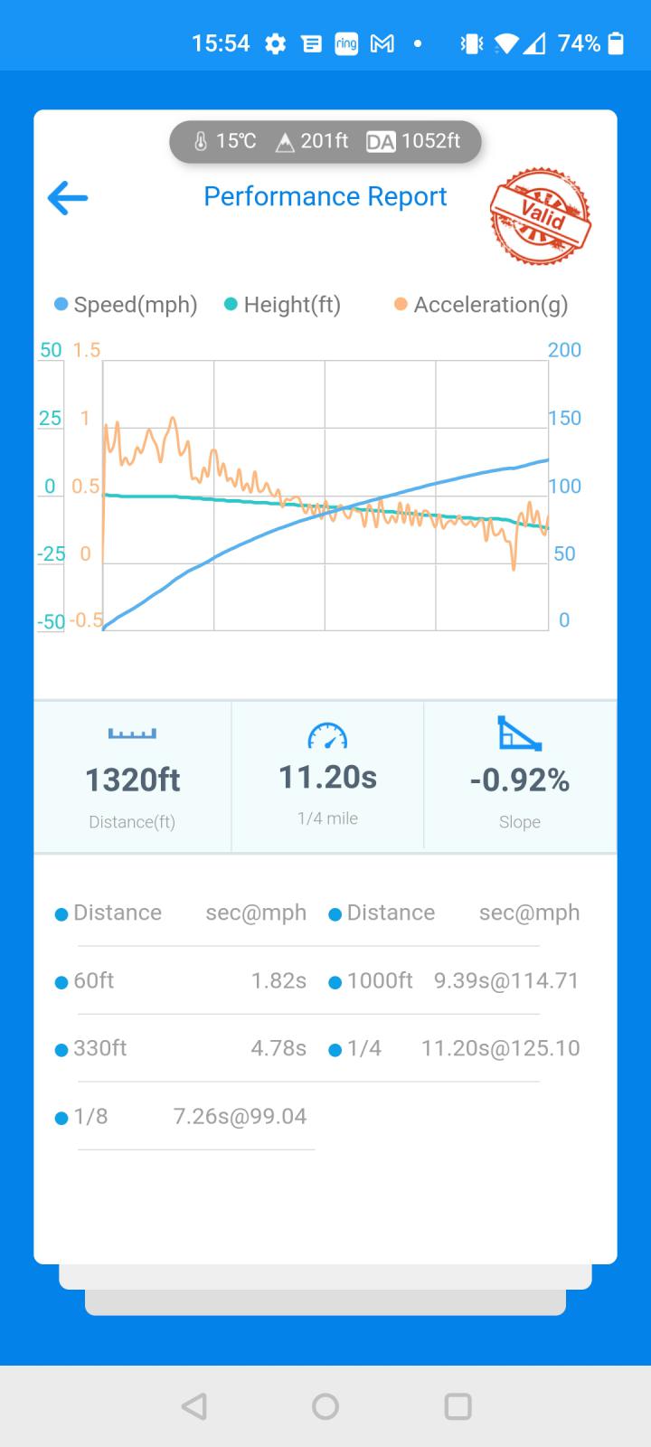

At last, BMW recall issued for the 1st gear boost problem. Finally meant I could launch the car properly and test the 1/4 mile. This is on JB4 map 0 for a baseline.
      08-18-2021, 09:42 AM   #15
Boosted_8
482
766
Drives: M550i
Then again with map 1

Fast forward to this month (August 21') the next modification I wanted to do was get the secondary cats out as they are not monitored buy the ECU and won't cause another limp mode / drivetrain error. They are much bigger and denser than on the M5. I noticed right away that the car felt more eager and had much more low down torque. The sound was perfect now to my ears also.
      08-18-2021, 09:57 AM   #17
Boosted_8
482
766
Drives: M550i
Jb4 logs were showing the car making over 21lbs of boost at 4.5k rpm now which was making me uncomfortable as this is M5 level boost on a car with smaller turbos and less engineering around heat management. So I moved to map 6 with my own boost targets, +3lbs peak. I was surprised to see that the car was now in fact faster with less boost! (I don't know why the 0-60 came up as invalid, it's the same bit of road I've used every single time!)

Fast forward to present day. Plan is to add some carbon parts to the exterior. I like the CS style spoiler from the club sport M5. It's more subtle than most of the other items I've seen previously. On the performance side I'm pretty happy with map 6 on the daily now. Peak boost is around 17psi and the car is really happy with it. Once the evenings drop down to 6-7 degrees C this autumn I think this car could have a 10.9x 1/4 in it. Would take all the child seats out and add a load of octane for a map 1 hero run on dragy. Otherwise I think some new UHP tyres is all this car would need a d it's the perfect stealth bomber!
