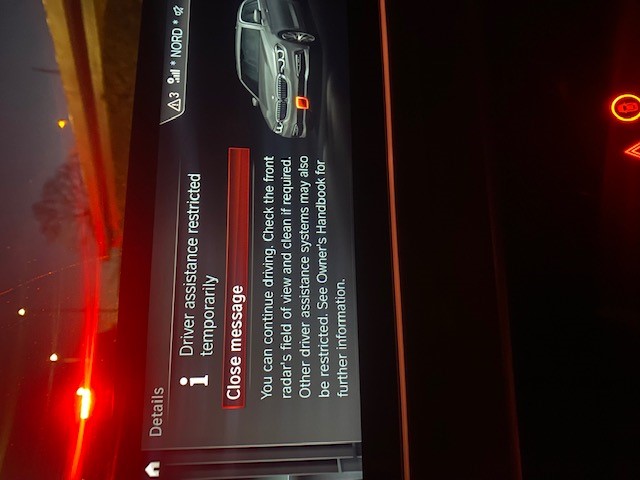

Can it be the KFAS-camera when i get this message? It says it is the front radar field.

I'm honestly not sure. I was troubleshooting anti dazzle and VLD and came across this SIB. I didn't not have messages on the display, but the faults were in ISTA.

In your original post, you indicated that you have gotten messages that both the front and side sensors are failing. To me, that suggests that the problem is not with the sensors but with either the wiring or the computer that the sensors use. Replacing one sensor seems senseless (pun intended).
