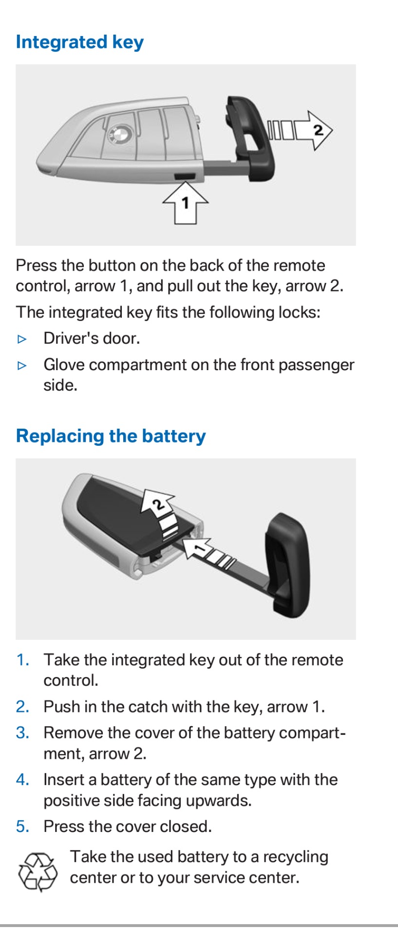

If the dealership replaced the battery in one remote, and your other remote is giving you a low battery warning…why not just stop by your local hardware store or Walmart/CVS/etc and pick up a dual pack of whatever battery type your remote requires.
Hopefully you saw how easy it is to swap the battery, if not, the instruction should be in the owners manual (it is in my older F chassis models).
Walmart usually has 2pk cell batteries at a good cost…and usually are at a kiosk up front near the cash registers. The same for a local big box chain called Menard’s…they have 2 pk cell batteries for around $5.
BTW, if you swap the low battery in the 2nd remote…see if it will get the non working remote to work. If it does…then the issue is definitely the battery. You may also need to make sure contact is good inside the remote fob.
