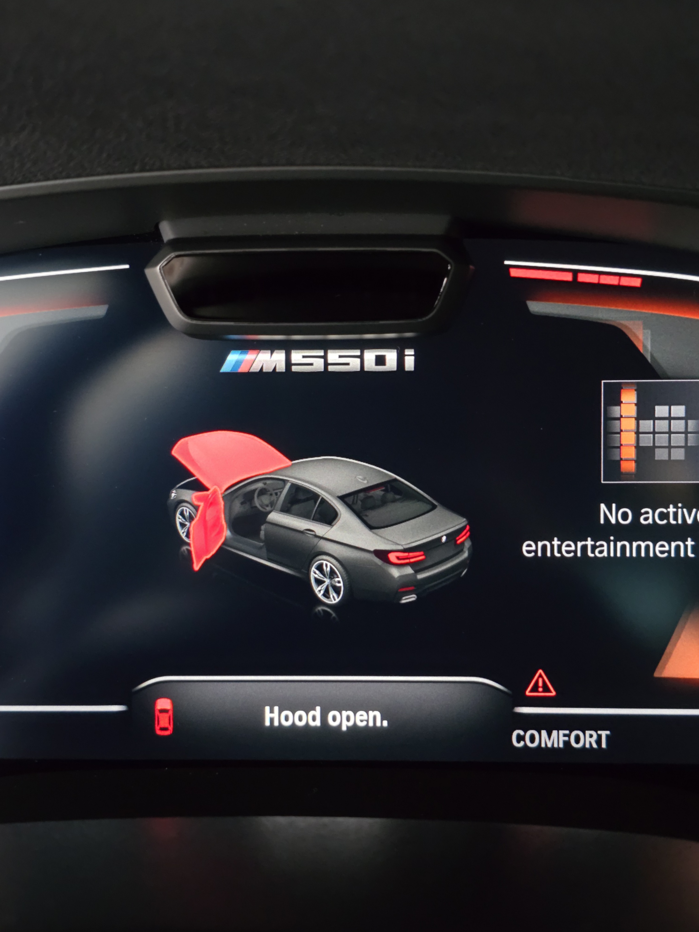

Hi Everyone,
I recently messed with the coding to enable anti dazzle headlights using ProTool.
Everything went well and the systems working great, the only issue I have now is my instrument cluster shows the wrong car (G30 with G05 tail lights) when I open the doors or trunk.
Unfortunately, the head unit was the one module I didn’t backup, if anyone knows a fix, please let me know.
Thanks in advance

Originally Posted by lnxguy View Post
What's your VO say for car type?
Says G30
The car shown in the head unit and instrument cluster normally is my car in the right color
Only when the doors/trunk/ hood is open this little guy with the wrong tail lights pops up
Default code the MGU if you want it back to stock.
I did, tried restoring my factory backup and even tried factory code from protool
Both show wrong tail lights but the cars body and wheels are correct
I checked other review videos on YouTube
This error seems to be on their screens too, I’m guessing iDrive bug or incorrect parameters from factory.
Sounds like you're out of luck. Not like LCI tail lights should really bother you that much lol.
All good, seems to be widespread across LCI G30s.
Thanks for helping out.

Happened to me but it was only showing the wrong color which was easy to code. Was your vld coding successful? Did you just use the options from the menu or went into "expert" mode?
      06-18-2025, 12:48 PM   #9
bananaMonkey798
bananaMonkey798's Avatar
36
18
Drives: “21 540i xDrive
Join Date: Jun 2025
Location: Ontario,Canada
Hmmm so your cars picture in the instrument cluster when the door is open shows the right tail lights ?
For the color go to head unit, expert mode, search for vehicle color and change it there.
As for the Anti Dazzle Highbeams, I’m not sure about how it works from factory but I VO coded out 5AP and 8S4, then modified some parameters under the BDC and double checked KAFAS.
https://youtube.com/shorts/d0Lcn7y5H...pwnh4iQKbRaDPw
This is how it looks right now, for the LUTs I chose G05_laser_ECE as I have the laser headlights and wasn’t sure if the standard G30 LUT would be right.
Need to test both sometime but what you see above is the G05_laser_ECE LUT
I had to double check since you made me doubt myself 😁. The lights are showing correct.
😂yours are incorrect too, that’s the preLCI X5 G05 taillights
WTF, that sucks. Did you figure out how to get it back?
Nope seems to be a firmware issue, I’ve asked all my buddies and checked YouTube reviews. Same glitch, only thing we can do is ask BMW to fix it and send an update but tbh, it’s minor.
I don’t want to update and have BMW lock more stuff down.
