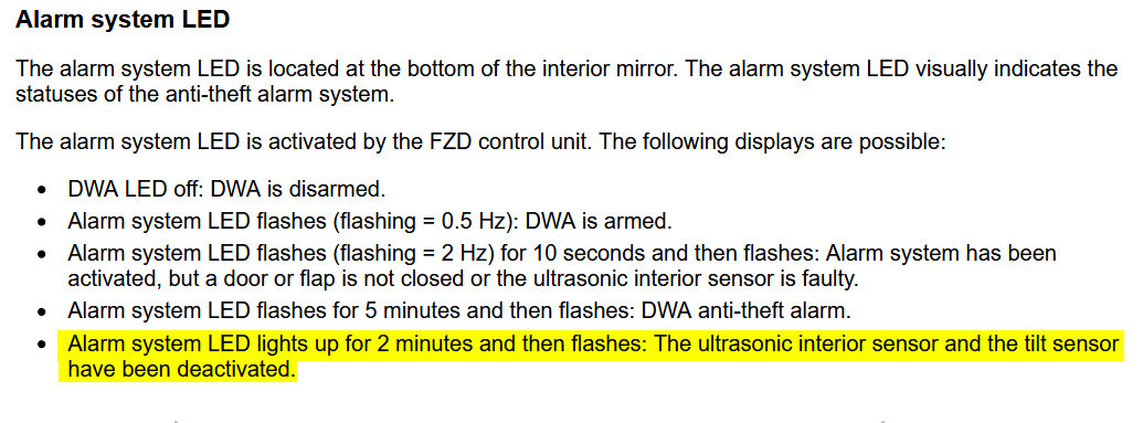

Is your alarm system’s red status LED flashing differently than norm when you initiate the alarm (aka lock the car)?
Normally, you should get a slow continuous flash which indicates the alarm has been initiated. If it gives any other type of status flashing…it can mean several things…see the info below and report back if you’re not getting a slow continuous flash when you arm the system.
