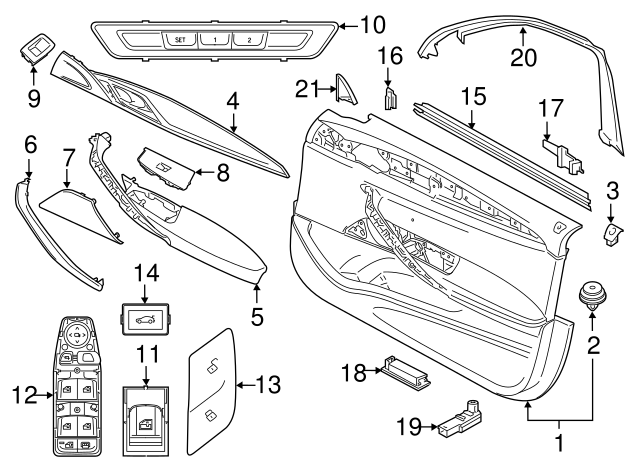

5 days ago, I got pale pink wet nail polish on my boyfriend's 540i xDrive interior trim by the right passenger seat window (see #8 on the sketch) and photo attached - I didn't notice until later and it already dried!! There has been no change when using water to remove the stain.

I'm not sure whether I can use acetone or acetone-free nail polish remover safely without ruining the underlying material (is it plastic?). What kind of cloth should I use to rub it off without leaving marks/more scratches?
Also, what material even is the black part in the photo? I don't see it in the details section of the BMW window sticker when the car was built.
Also, any advice for which product to use to wipe away the fingernail scratches (other than getting the full interior detailed)?
