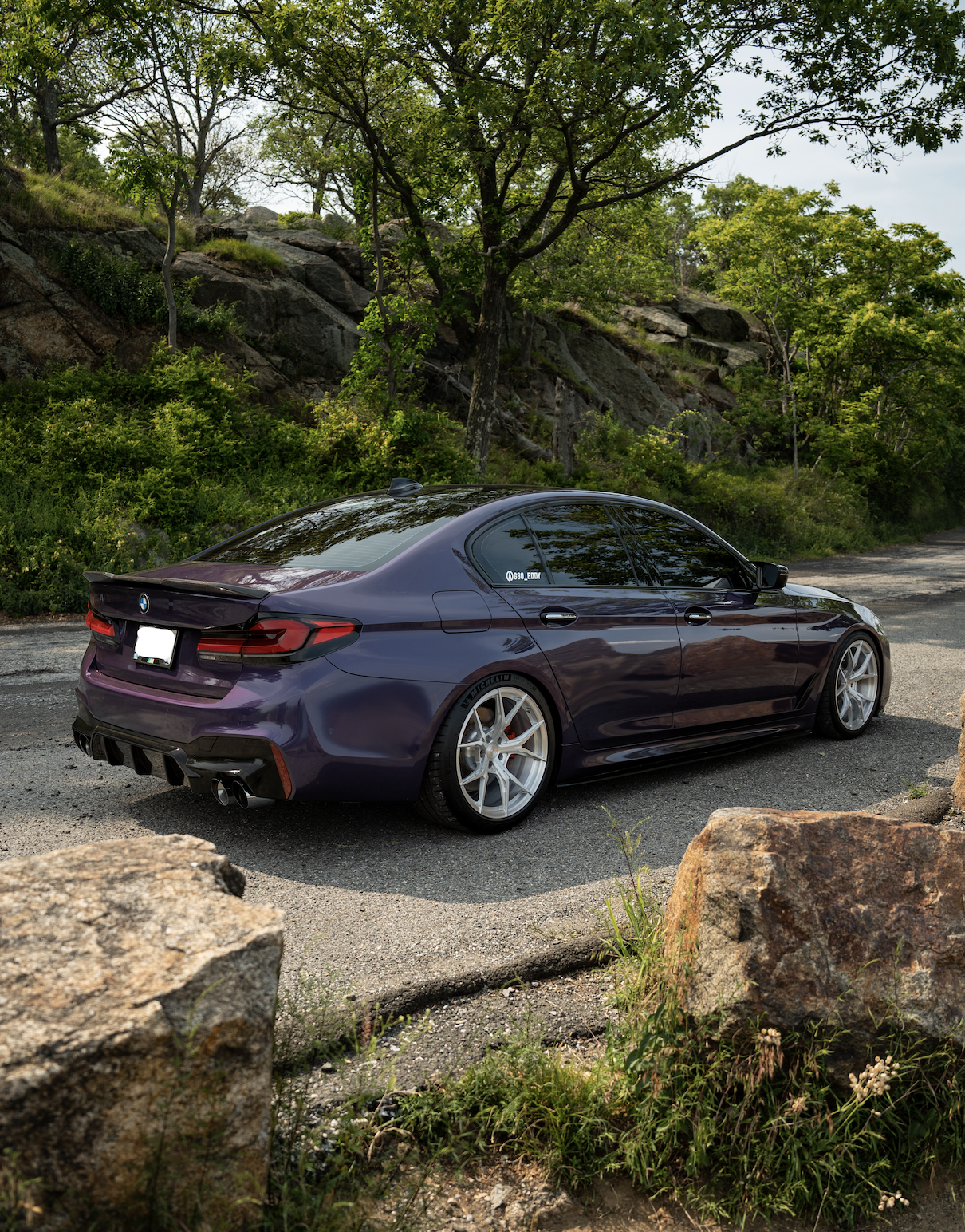

Wanted to share this:
Volare Forged
VF008
Brushed clear
19" staggered setup
Name:  Screen Shot 2024-08-13 at 2.37.05 PM.png
Name:  Screen Shot 2024-08-13 at 2.37.15 PM.png

This is the exact set up I want (fitment-wise) for my 540i. Are you running spacers or just staggered and lowered? What’s the front and rear widths you got here because it’s perfect - also offset? I have MSS springs on the way but I really want to make sure I pull the trigger on the right rims.
VFJon673.50
Did you ever find out what his wheel specs and tire sizes are? I'm trying to run the same type of fitment with a 19" 9 or 9.5 front and 10/10.5 rear jsut trying to get the most grip on the rear as possible
19x9 255/40 et25
19x10 285/35 et40
perfect specs for G30
For that exact design:
VF008
19x9.5 et25
19x10.5 et35
Customer is not running any spacers and is lowered

What if fronts were 19x9.5 et 35 or 30 would that poke too much?
