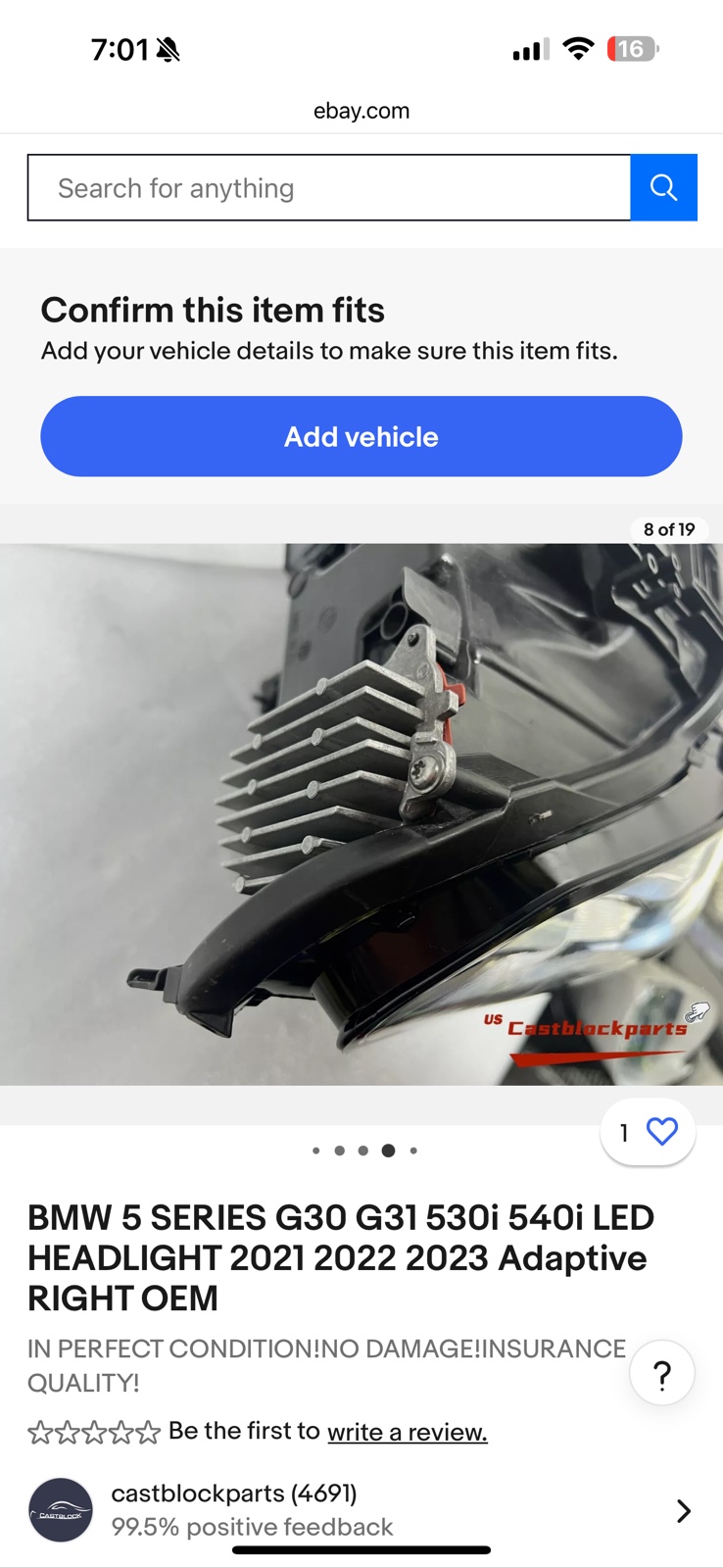

Looking at photos of the base LED headlights, they do seem to have a DRL module on the bottom like the ICONs do. RealOEM does list them as different part numbers though.
The S552A code is the ICON lights. So there's an ICON set, which is specific to left and right. The DRL module for non ICONs are the same for both sides. Knowing that they are different part numbers, I can't say whether different DRL modules will work for non ICON lights

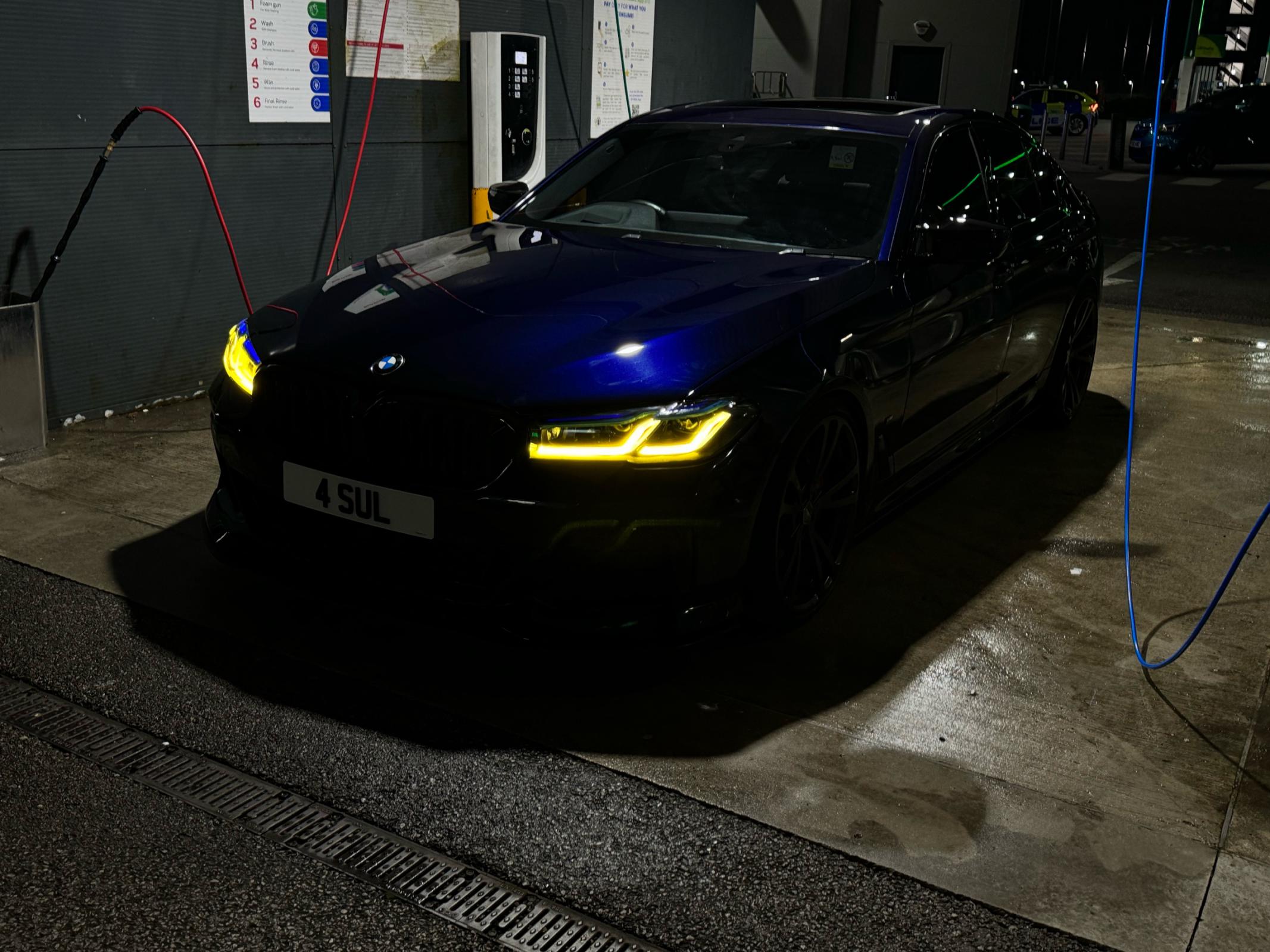

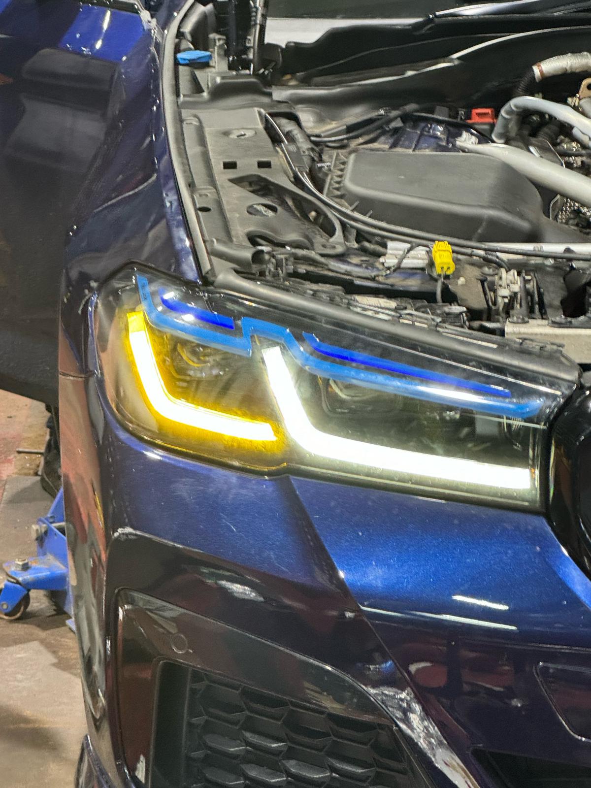

So I’ve done the conversion. You can get to the outer drl. Front the back of the light the module is easy to replace, for the inner drl I had to open my lights. Ordered some new lenses off eBay, and put them back together they been perfect so far, I got the modules of AliExpress, and I’ve had them in for 2 months no fault codes no issues,

Looks amazing congrats.
Any plans to have a DIY written up? I've baked headlights to open em up for an 09 TL I used to have. Just curious to see if it's the same process. Is it hard to get the headlights out?

Looks great man. Did you have to get new lenses? Or did you just want to
