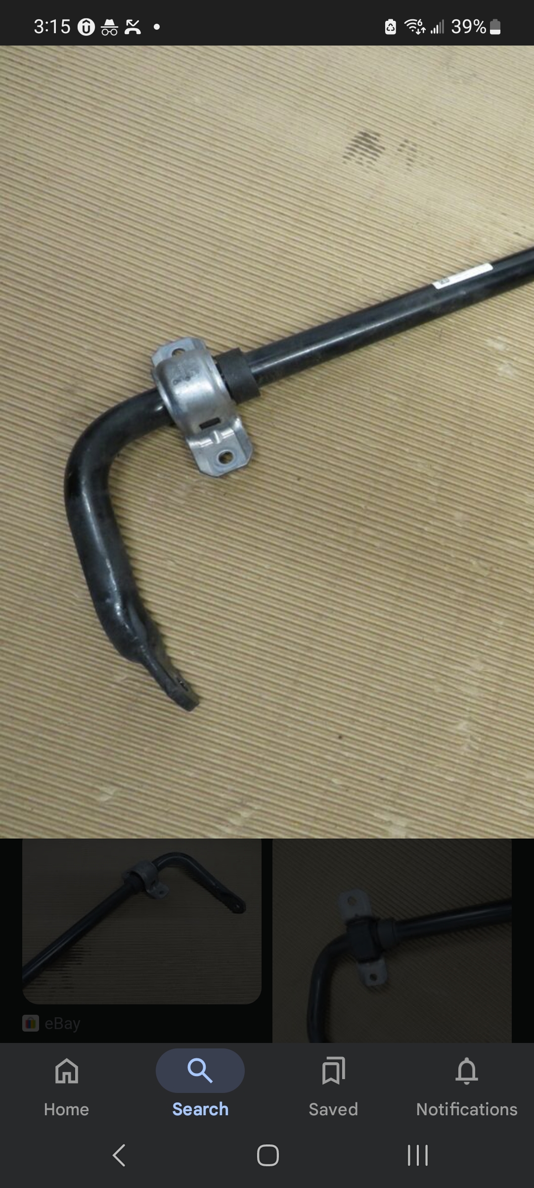

To those of you that did the install, did you notice multiple mounting holes for the sway bars? I'm looking to swap out the active sway bar for the static ones, mostly for weight savings, battery draw, and consistency in suspension feel.
The active sway bar brace on m550 m850 looks to be bigger but all the part numbers for active sway and static sway seem to be interchangeable. Maybe the built in bushing mounts into the bigger brace?
